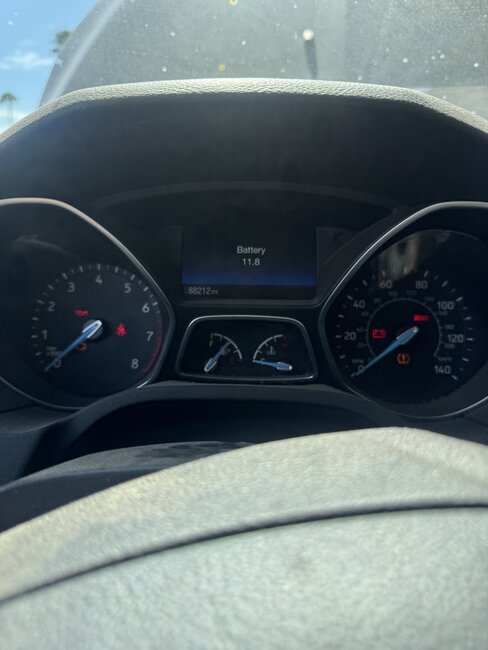

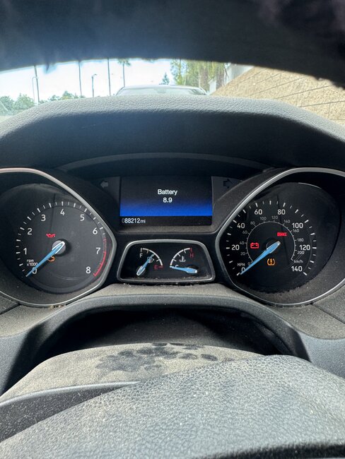

When I crank the engine, Key Not Detected comes up on the dash and there’s no clicking or clanking. Battery was reading 8.9v, after a battery swap and a 50amp midi fuse swap there’s still no change other than a soft thumping in the engine bay when attempting to start the car. Battery is now reading 11.8v steady. Codes on dash when in TEST mode read C101_00, C121_00, C140_00, C151_00, 1607_87, 1607_82. Any ideas what could be causing the power failure?

You will get all of the codes you see if the battery is low.

Checked the cars TEST mode voltage a few times throughout the day and reads 11.8v every time but will update with voltmeter voltage also. My guess is I swapped the wrong 50 amp midi fuse as I didn’t check them prior, just followed a tutorial and swapped the same one that was swapped in the video. Ordered a couple of those as well to switch out the rest

All cable leads are connected and I cleaned up some light corrosion on the negative side. Voltage from the car is reading 11.8 and doesn’t change when turning key

Still waiting on that voltmeter, sorry for the lag. I just checked it and battery is sitting at 11.6 now and jumps to 11.7 when turning the key. Voltmeter should be delivered by the end of the day
