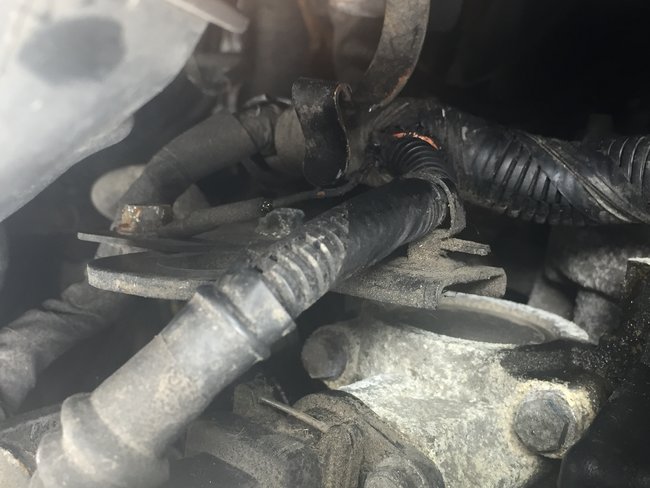

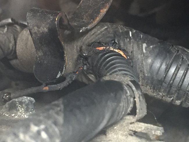

This occurred yesterday after i inadvertently stalled the car by placing it in third gear instead of first. It started up okay, made a delivery okay with normal shut down and start up, but once i returned to my workplace it wouldn't start. I was able to pop the clutch but the overheat indicator was on, car has oil and coolant. Once i got it home it didn't start again. It cranks weakly and i think i can hear the spark plugs firing. t has a new battery and alternator already.
Feb 1, 2021 at 4:06 AM (Merged)
ENK
Edit: just discovered this. smoke also emitted from the fuse box once the key was turned but didn't find anything burnt in there.
  • 55,770 POSTS
Opps, something has shorted out burning the wiring up. lets check for 12 volts at the battery and lets test the fuses to see if any are blown. here are guides that will help us get started and fuse panel diagrams below:
and
Check out the diagrams (below). Please let us know what you find.

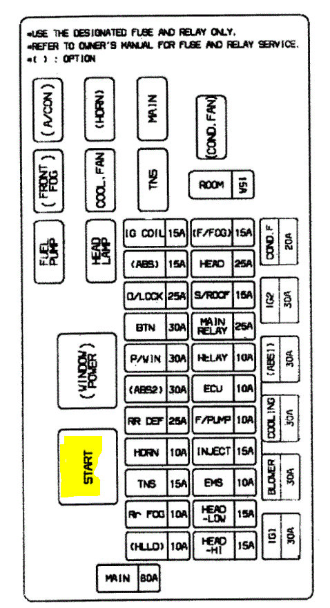

LOU20
  • 88 POSTS

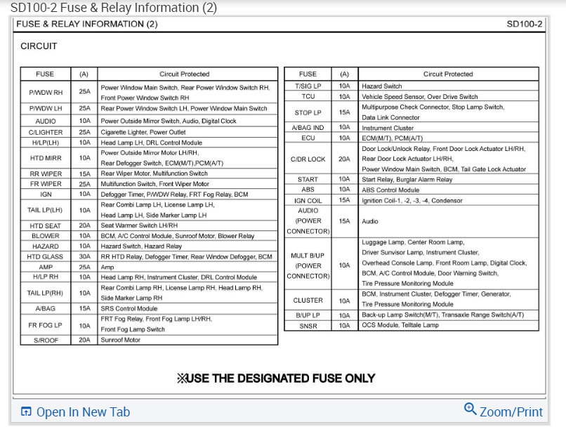

put a new battery and starter and it still does not want to start start. When I try starting it the brake lights and windshield wipers comes on.
Feb 1, 2021 at 4:07 AM (Merged)
  • 110,251 POSTS
Welcome to 2CarPros.
I need to better understand what is happening. When you turn the key to the start position, the wipers and brake lights turn on? Is that correct? Also, did the problem start all at once or were there any symptoms you may have noticed before this happened? Finally, does the starter engage at all?
I attached a pic below of the under hood power distribution box. I highlighted two fuses I need you to check.
Here are a few links that you may find helpful:

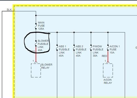

That is the blower motor. Under the hood is the blower motor relay. It is in the fuse/relay box. Remove it and if there is another relay with the same part number, switch them to see if that makes a difference.
If it doesn't, let me know. Power supplied to the relay is via what is called a fusible link and not a traditional fuse. See pic 1.

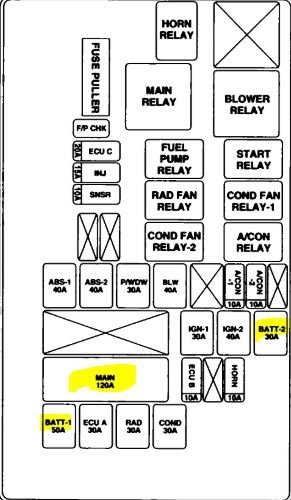

LOU20
  • 88 POSTS

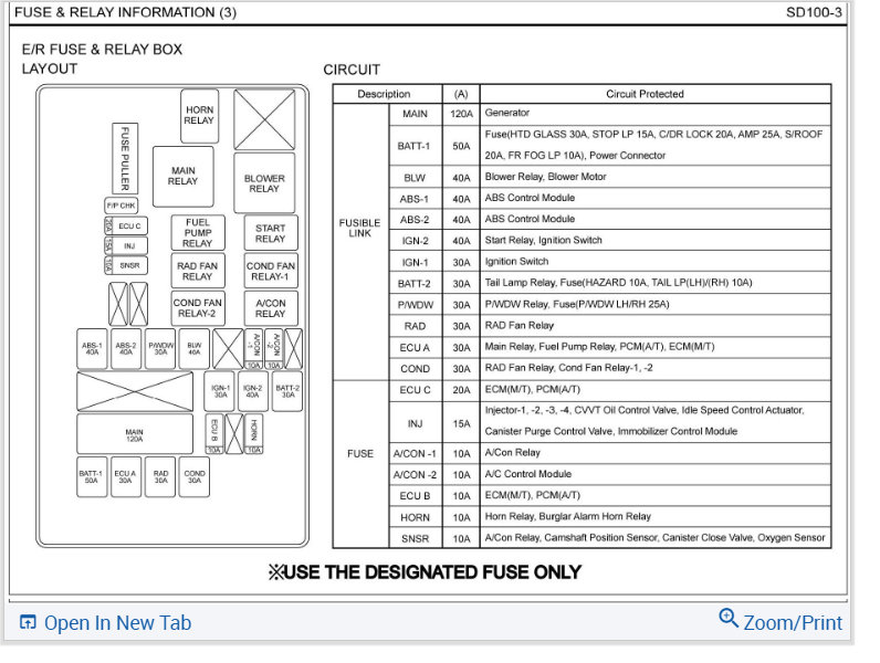

Thanks will check. One more quick question is their fuse for the battery?
  • 110,251 POSTS
Welcome back:
I attached a pic of the under hood fuse/relay box and highlighted the main fuse and two other battery fuses.
Let me know what you find.
LOU20
  • 88 POSTS
Is it possible it could be the battery fuses causing the battery light to come on and the fuse for the blower motor causing my A/C not to blow? Do I still need to check the alternator?
  • 110,251 POSTS
Welcome back:
Honestly, I would think it would affect more than that. I would check the alternator output after you confirm the fuse is good.

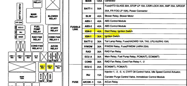

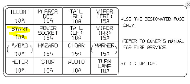

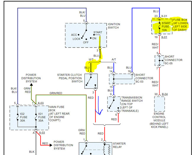

  • 110,251 POSTS
What we need to do is start checking a few things. First, I attached a pic from the wiring schematic below. I highlighted a fuse I need you to check. In addition to just checking the fuse, confirm there is power to and from it. Here is a link that helps explain how to do this:
Now, if the fuse is good and there is power, the next thing I need you to do is confirm there is power into and from the clutch safety switch. It is located at the top of the clutch pedal. I highlighted it and the arrow shows the direction of power out. Note that the key needs to be in the start position when testing and the clutch will need depressed to check for power out.
Here is a link to help with testing wiring:
If there is power out, one last thing I need to be checked, the starter relay. It is located under the hood in the power distribution box. If you look at pic 3, I highlighted the relay to test. We have two ways to test this. The first (and easiest) is to locate another relay in the box having the same part number and switch them. Or, here is a link that explains how to test a relay:
Do this and let me know what you find. I realize it seems like a lot, but it won't take long. You will need a simple test light to do the clutch safety switch test, but the rest can be done without tools unless you can't find a matching relay, but there should be one.
Let me know what you find or if you have other questions. I'm here to help.
God Bless!!!

LOU20
  • 88 POSTS
Thanks for your help it was the fuses.
