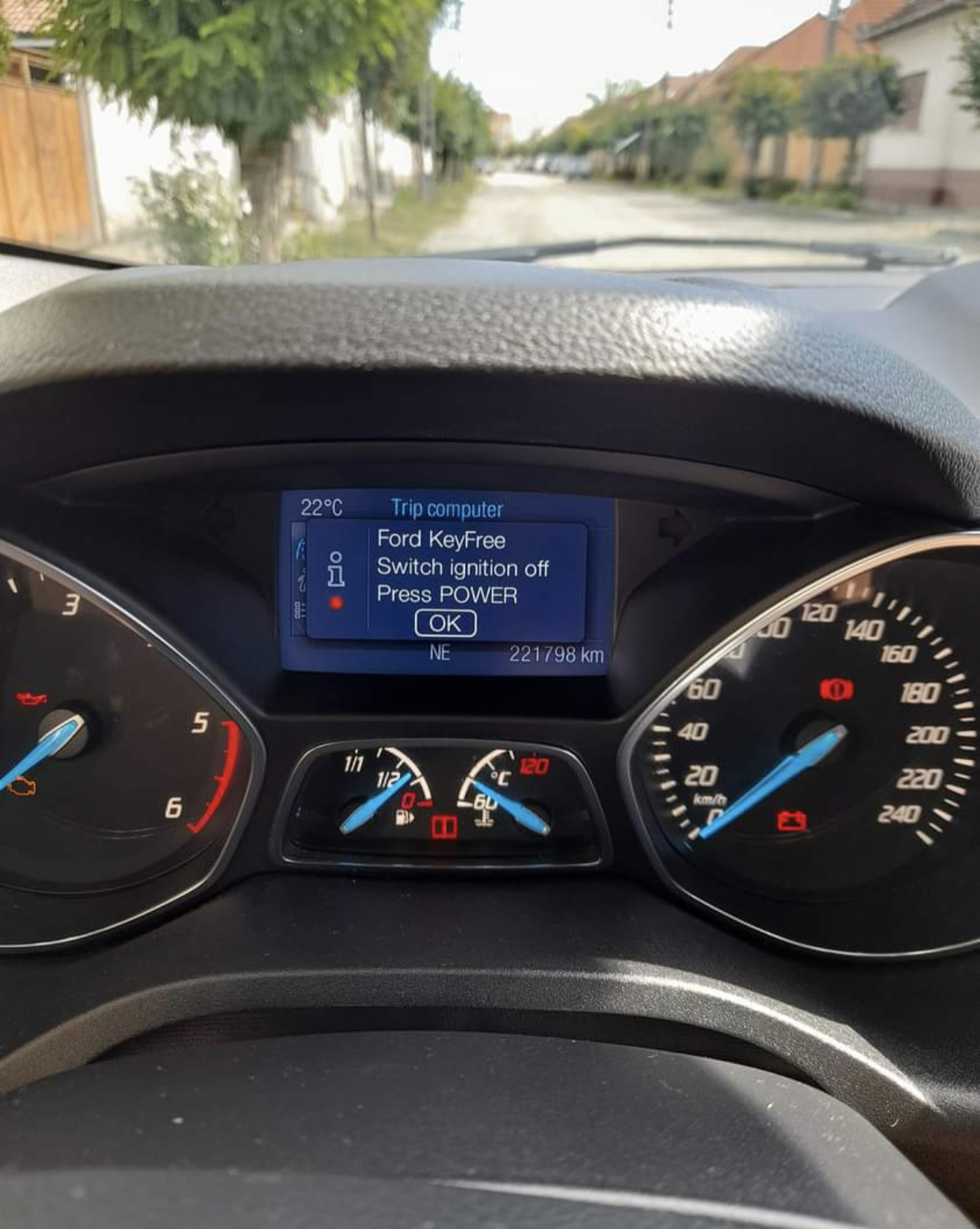

Also, I forgot to mention, the day i sent the car to them and was trying to start myself i noticed this appearing. It's not my photo but this message appeared also when I tried to push the button, so I used the key inside along with pressing on Power Start (not worked)
I don’t know if somehow it’s relating to car not starting but wanted to add this just in case it might be, in any way , other suggestions that what’s is wrong would be a great help.
