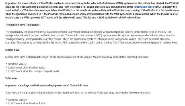

Car will not start it just clicks?
2007 PONTIAC GRAND PRIX
130,000 MILES • 3.8L • V6 • 2WD • AUTOMATIC
TONY BONES
I brought it to a mechanic he said it a bad fuel pump. replaced the pump but it still won't start and the alarm started going off out of nowhere. please help!
May 15, 2021 at 9:31 AM

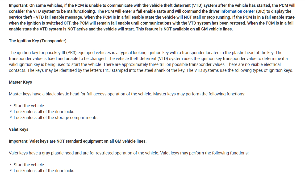

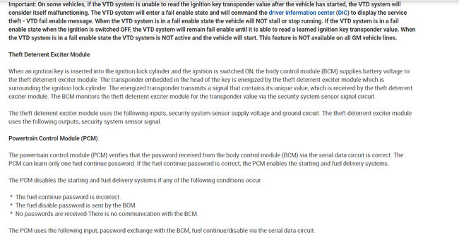

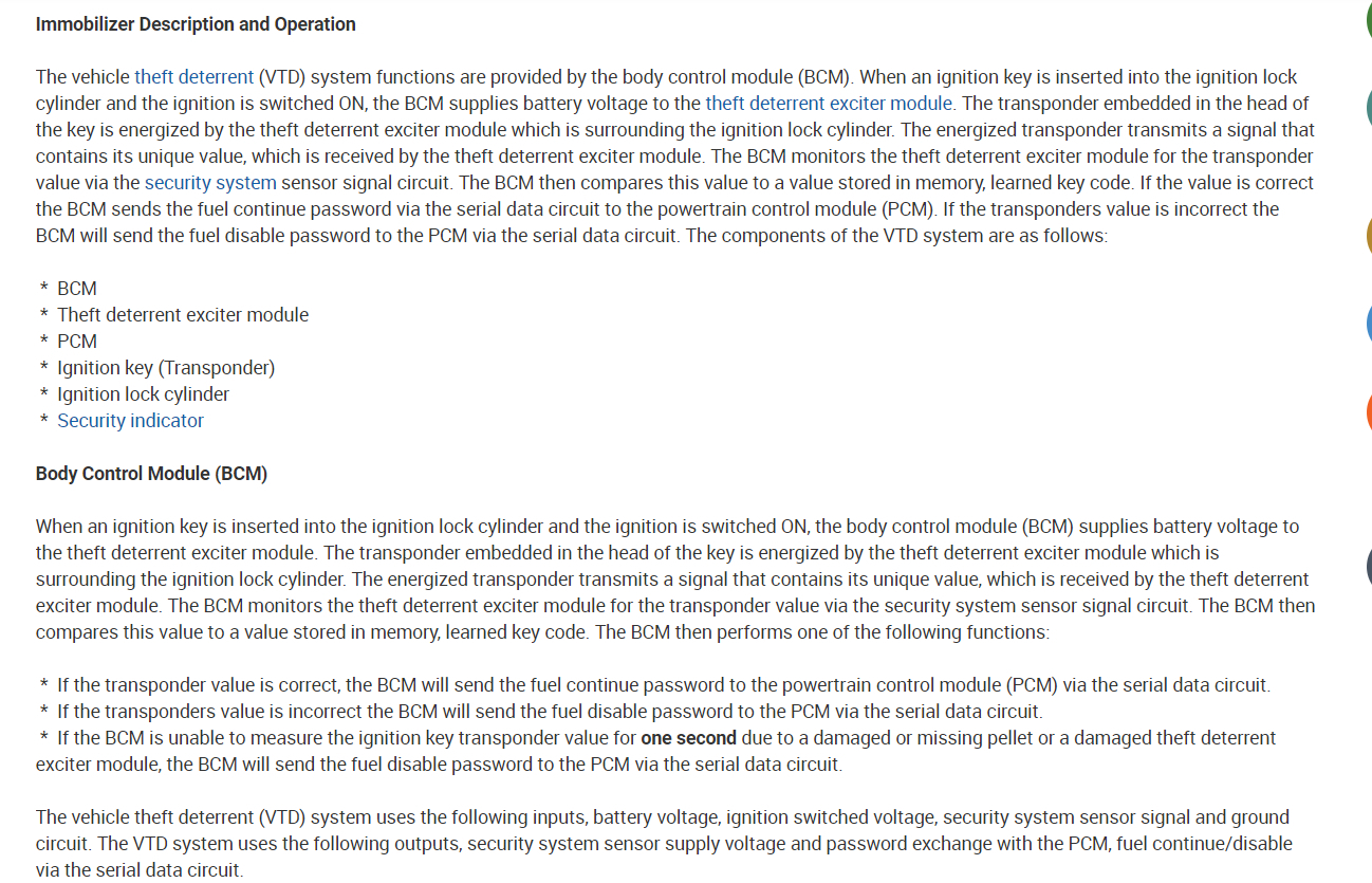

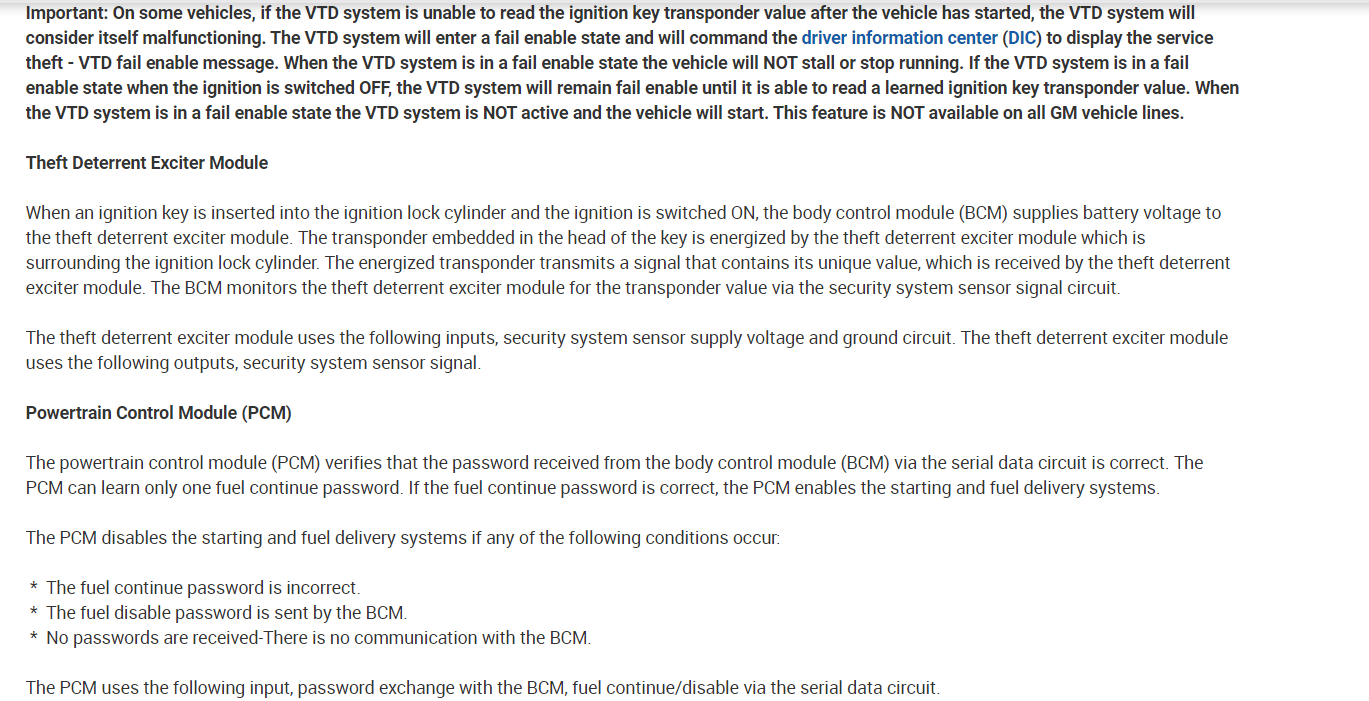

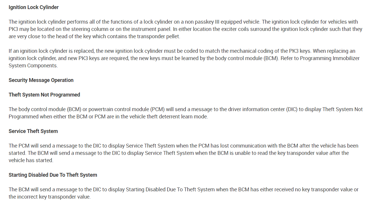

Good evening,
This sounds like the security system needs to be reset. I attached a guide for you to view.
https://www.2carpros.com/articles/how-to-reset-a-security-system
I attached the description and operation of the system.
May 15, 2021 at 10:04 AM
