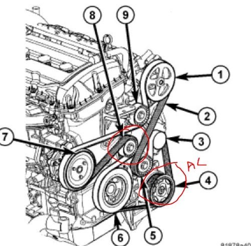

Battery is only a few months old and the alternator is about three years old. Went to start my car this morning and everything lights up and turns on but the car won’t even try to turn over let alone start. Once I turn the A/C off it started right up. Tried again about fifteen minutes later and the same thing happened.
Jun 4, 2019 at 7:42 AM
  • 110,194 POSTS
Welcome to 2CarPros.
Is the AC working? It sounds like the compressor is locking up and not allowing the starter to crank the engine. Did this happen all at once? Is there any noise from the AC compressor when being used that could indicate it is failing?
If the starter can't even turn the engine when the AC is on, that is my first suspect.
Let me know if that is what is happening. If you want to confirm what I am saying, remove the AC belt, turn the AC on (it won't work) and see if it starts. If it does, the compressor is causing the issue. If it does start, only run it for a couple seconds, just long enough to confirm.

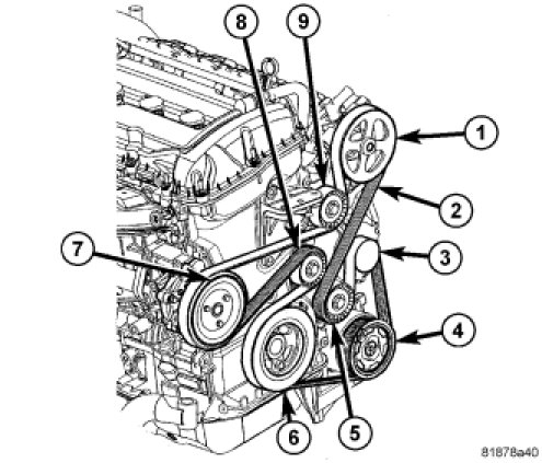

I attached two pics. The first is belt routing for this vehicle, and in the second, I circled the compressor (indicated with AC) and the belt tensioner.
Here are the directions specific for your vehicle for removal and replacement. These directions correlate with picture 1.

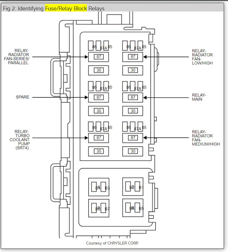

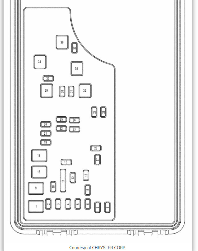

i have 2008 dodge cablier 2.0 engine the ac compressor want come on .i test the hot wire it has fire.where is the relay located at.
Dec 30, 2020 at 5:53 PM (Merged)
SATURNTECH9
  • 30,869 POSTS

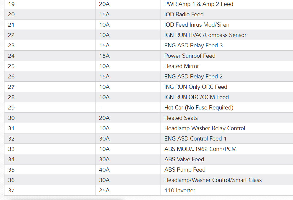

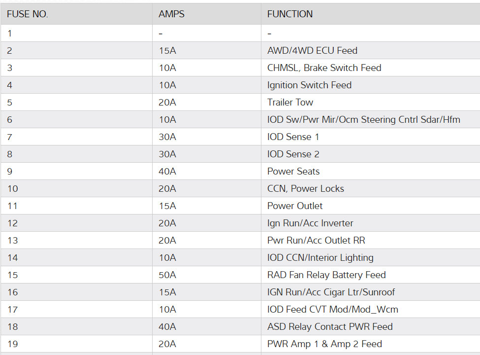

First of all we need to check the pressure in the ac system if its too low the ac compressor wont come on and checking the relay will tell you nothing.
https://www.2carpros.com/articles/air-conditioner-how-to-add-freon
These is no a/c compressor relay it is controlled by the TIPM and the PCM check fuse number 22, 15 and 18. Here are the air conditioner wiring diagrams so you can see how the system works.
Cheers
BEE43
Yep is was fuse 18 40 amp was blown I installed a new one and the system works again, yA! thanks for your help.
