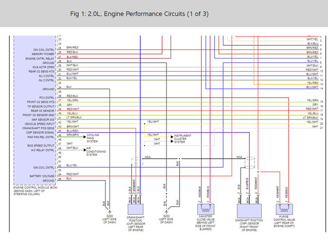

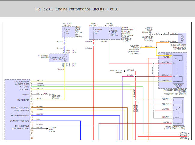

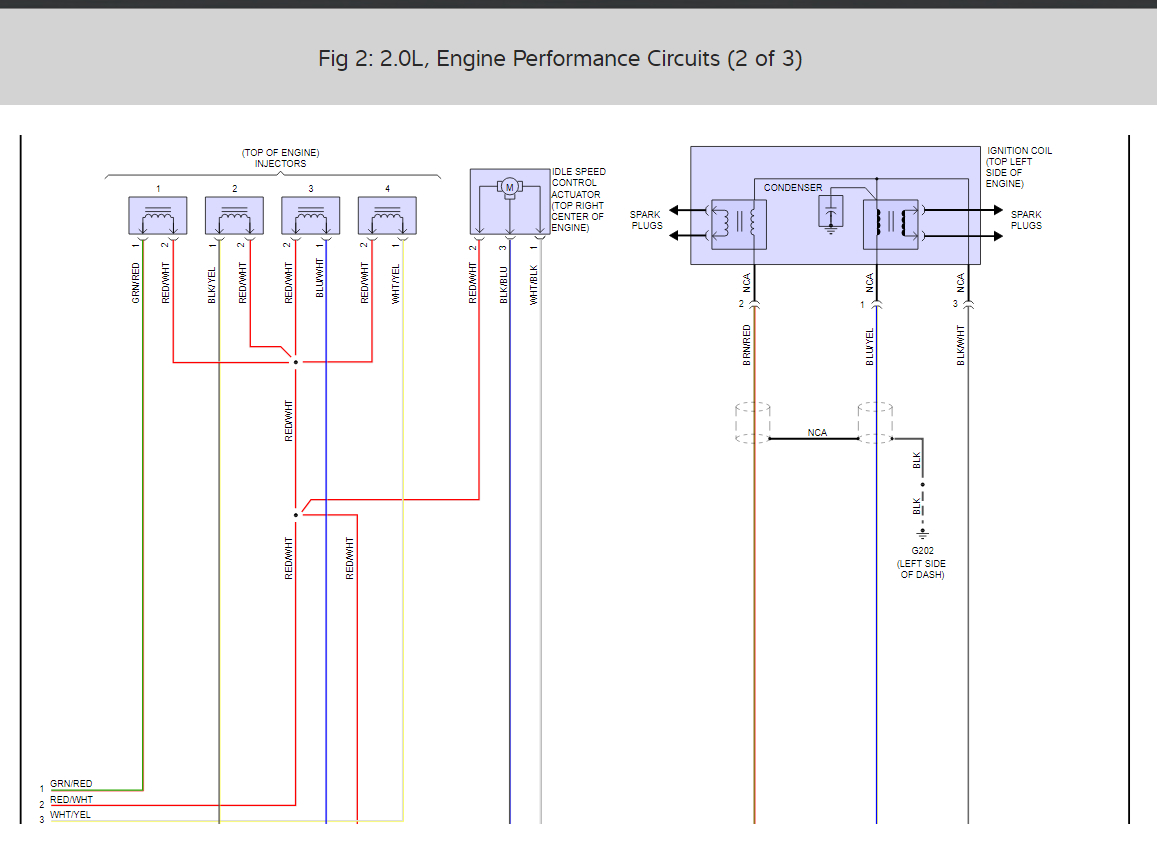

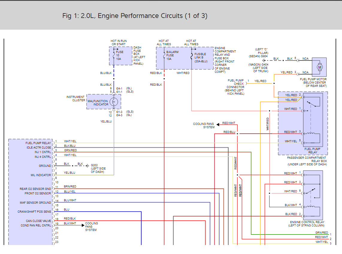

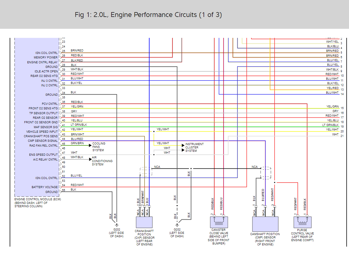

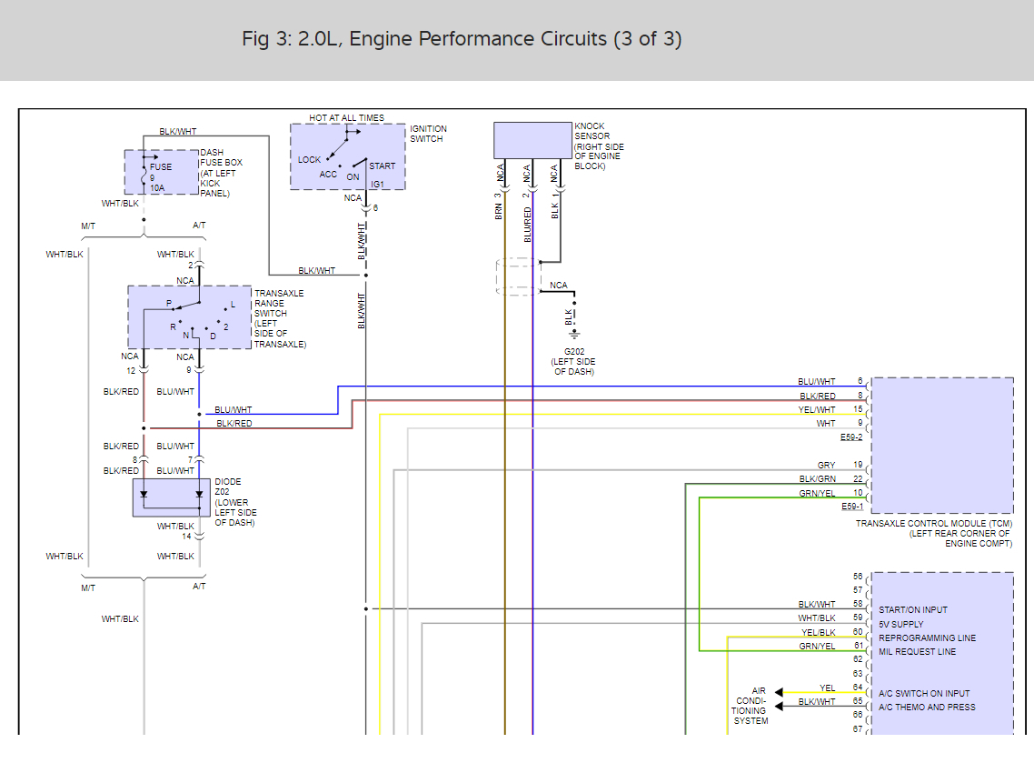

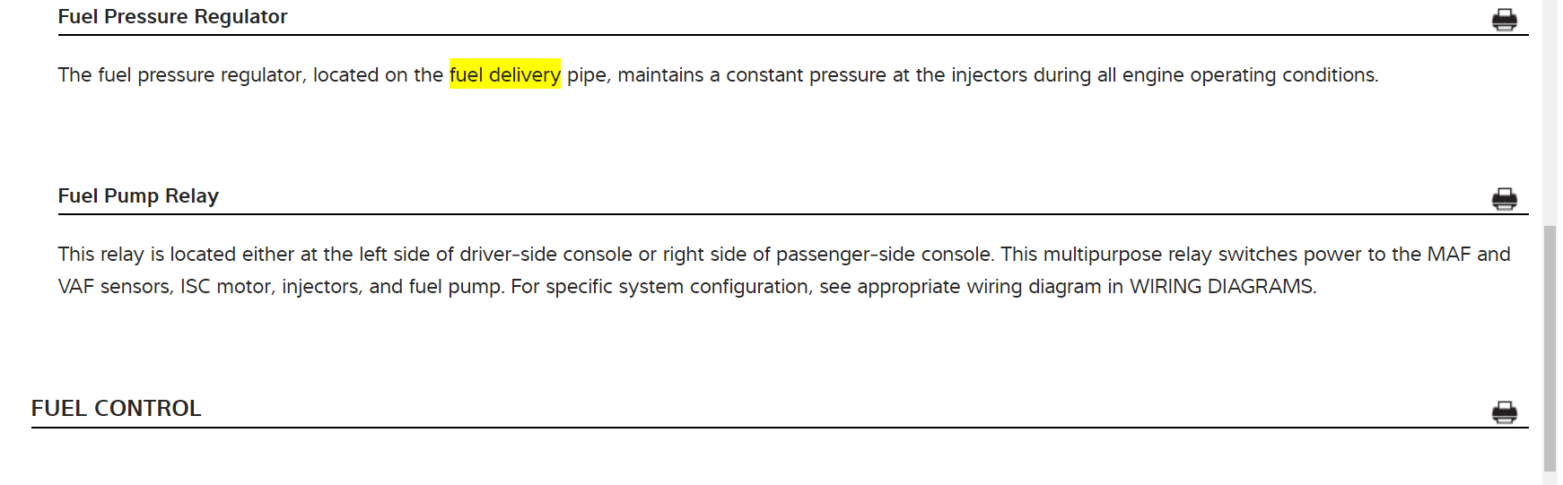

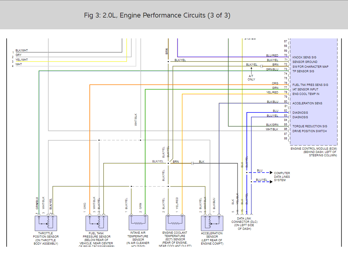

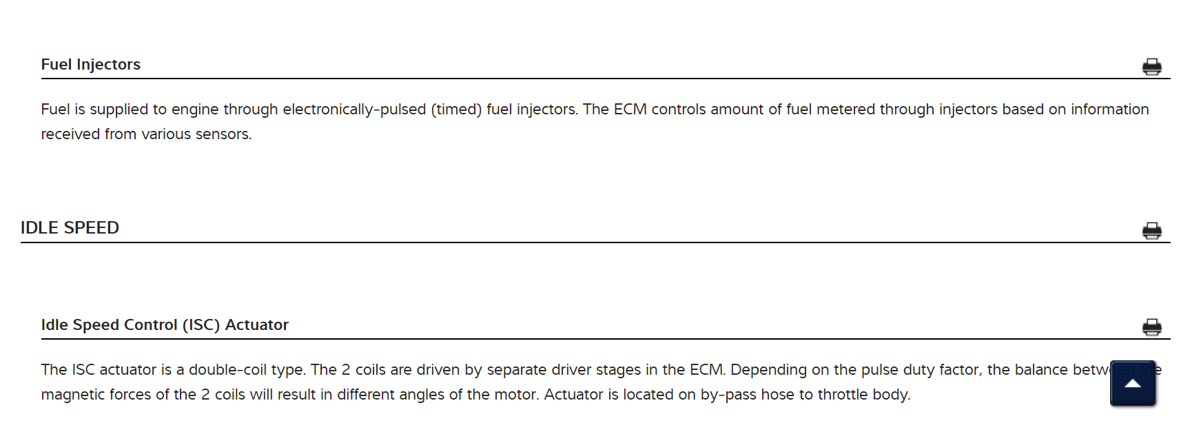

Hit a pot hole hard and car shut down/off. Now car won't start. Fuel pump is good. Was told different locations for the fuel kill switch and can't locate. Please help!
Mar 17, 2019 at 4:43 PM
SCGRANTURISMO
  • 4,897 POSTS

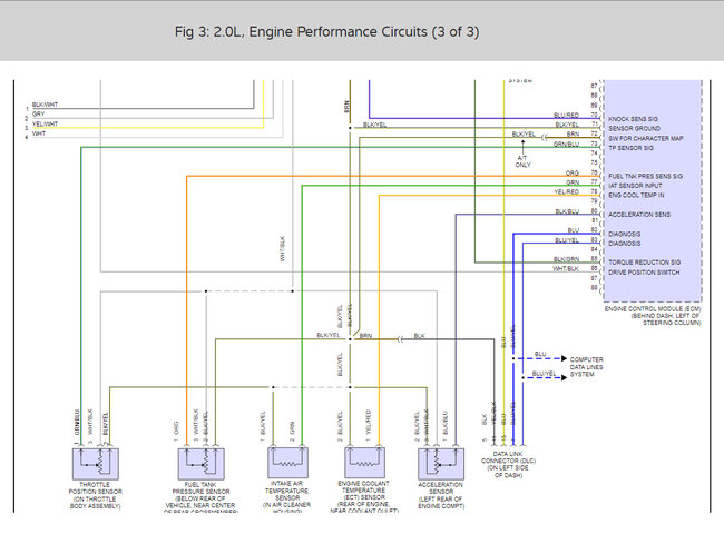

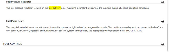

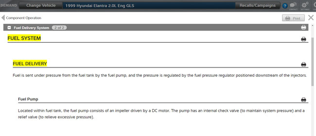

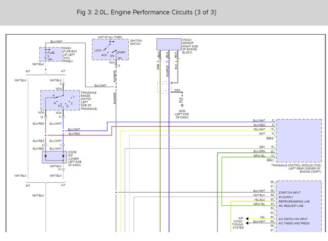

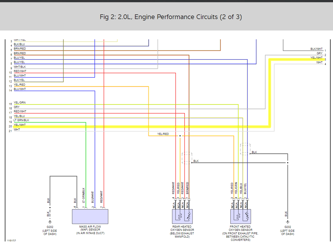

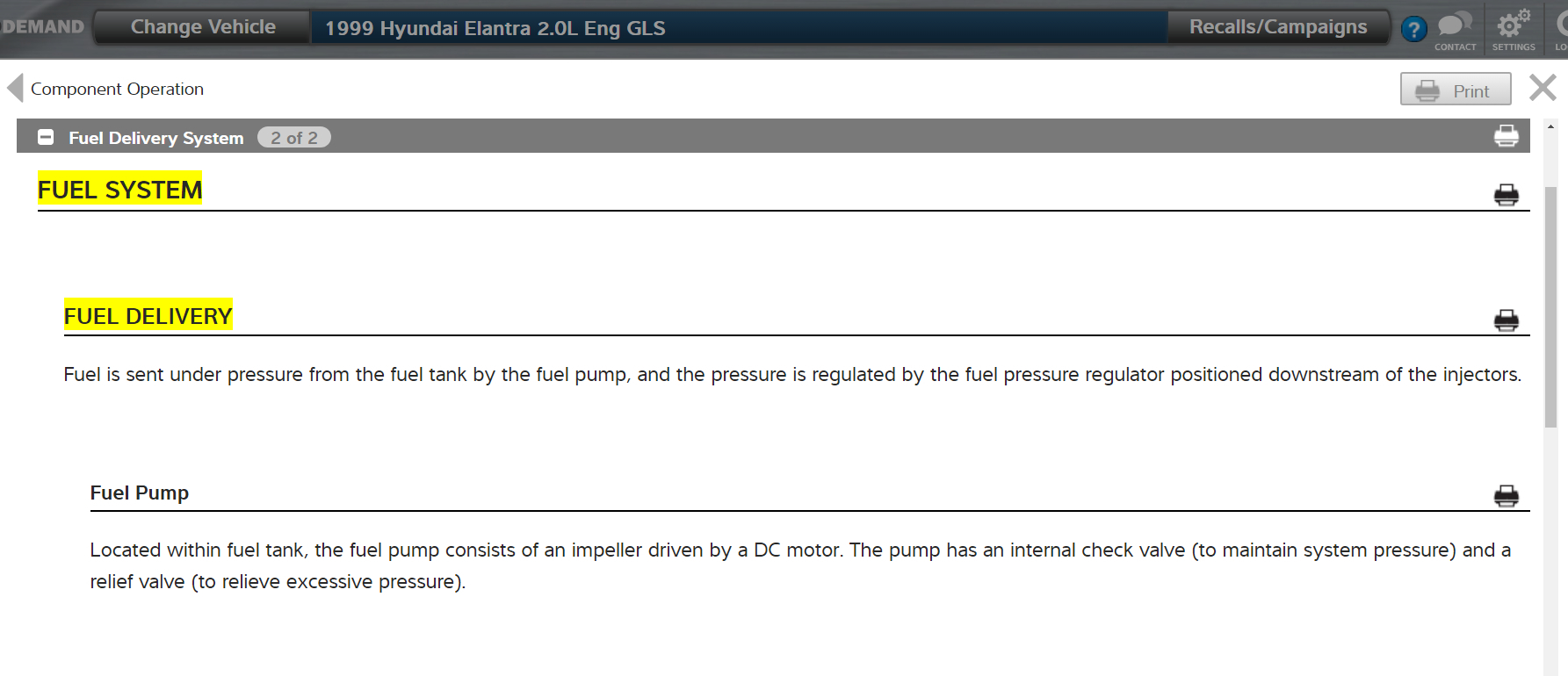

As far as I can see your vehicle does not have an intertia fuel cutoff switch in it. I have included the fuel system description and the fuel system wiring diagrams for you in the diagrams down below. Please get back to us and let us know what you find out.
