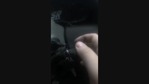

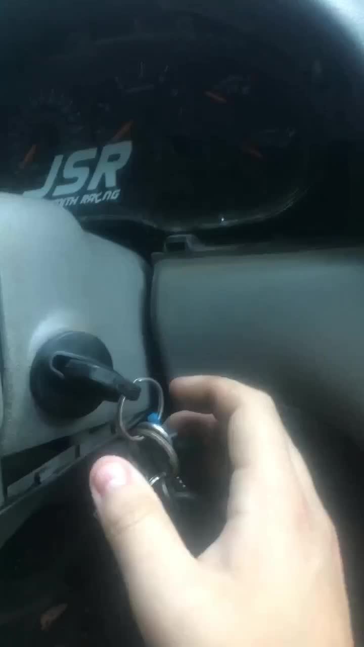

I have the car listed above GT and I absolutely love the car. I replaced the transmission solenoid in the car it was running perfectly fine perfectly okay before hand. then I replace the transmission solenoid now the car will not start whatsoever. I replaced the starter but every time I tried to start the car it just shows up low oil doesn't turn over nothing doesn't even start. have no idea what the problem is. really love the car. someone please help me figure it out. I'll try to add a video to show what it's doing.
Mar 12, 2021 at 2:51 PM
JAY EARWOOD JR.
This is the video of what it's doing.
Mar 12, 2021 at 2:52 PM

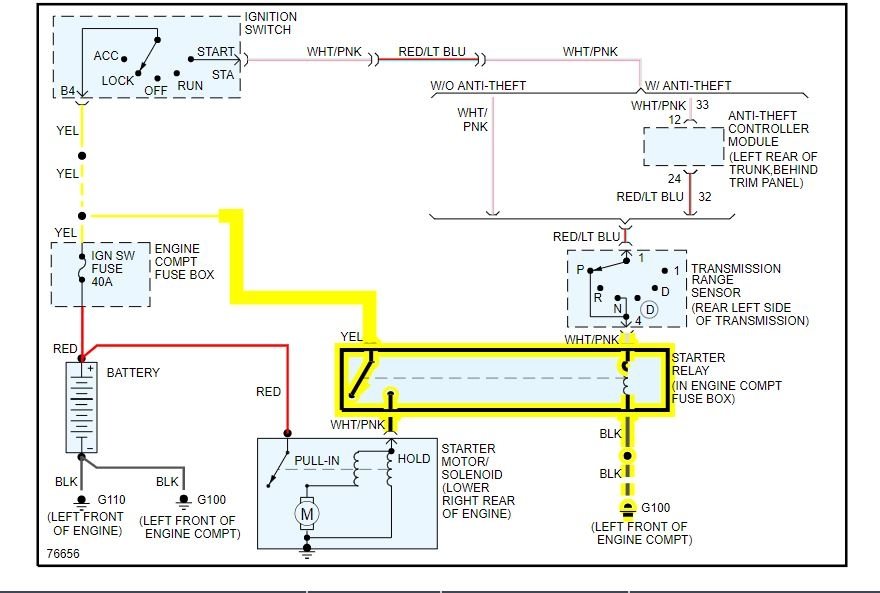

Good morning,
Which solenoid did you replace? Where was it located?
I attached a wiring diagram for you of the starting system. You need to test the little wire at the starter solenoid with the key in the start position.
