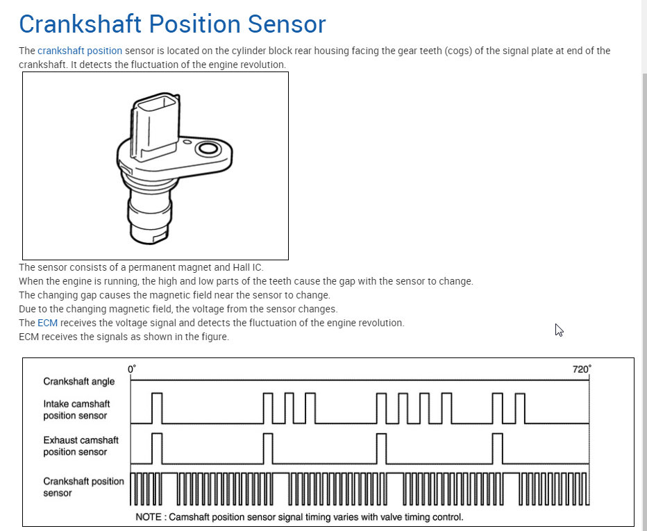

The other major cause is a crank sensor. Clearly we need to test this before just replacing it but let's start with fuel.

If it is the ignition system we need to start with if there are or were any codes. Then we need to monitor the signal from the crank sensor that the ECM is seeing. If there is no crank signal then it will not start or run because the ECM will not know where the engine position is. This is where we need to start because it is the most common cause of a no start that is not fuel related. Clearly we need to do all this testing when it acts up.
