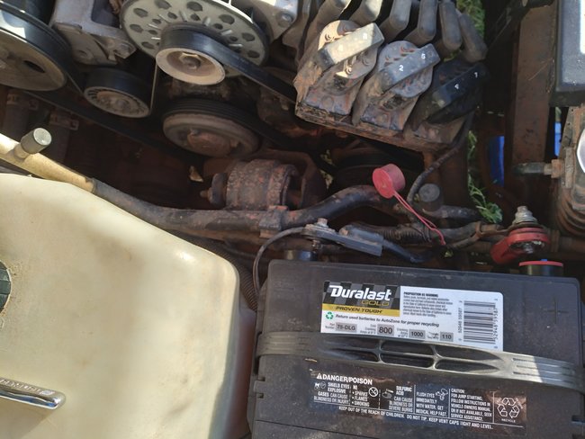

One morning my car wouldn't start so I looked into getting a new starter and find out that my battery was bad. I replaced both and my car still won't start. She is my first car and i don't want to give up on her. Please help.

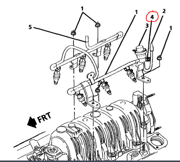

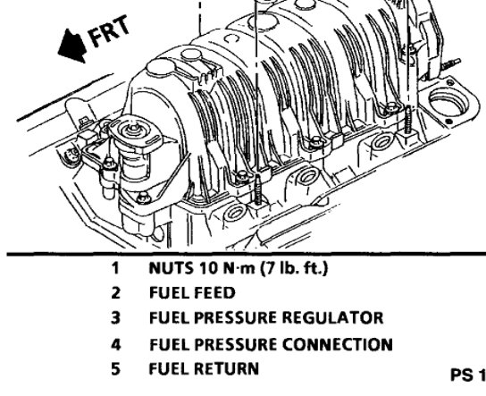

Every once in a while it will crank maybe once then nothing. I'm having trouble trying to find where to connect the fuel pressure tester. I found two ports and i can't get it connected to either.
Dec 1, 2020 at 6:34 AM
DANNY L
  • 5,648 POSTS
Hello again.
I've attached pictures below of the fuel schrader valve where you can attach a fuel pressure tester for testing. It is location number 4 on the pictures. Let us know what you find after testing and we'll go from from there. Hope this helps and thanks again for using 2CarPros.
Danny-

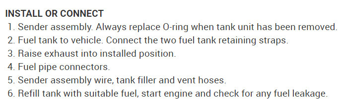

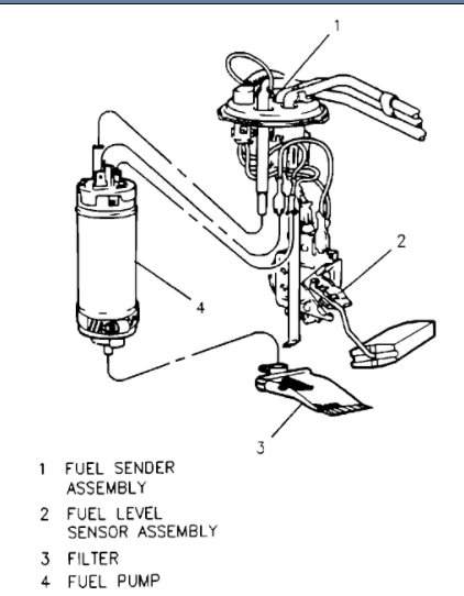

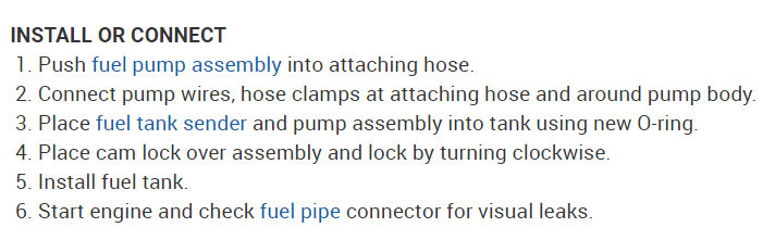

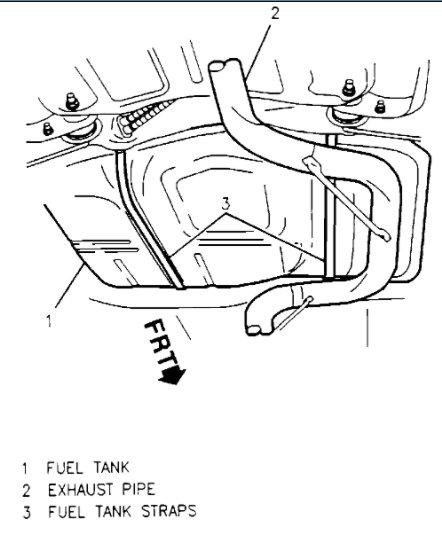

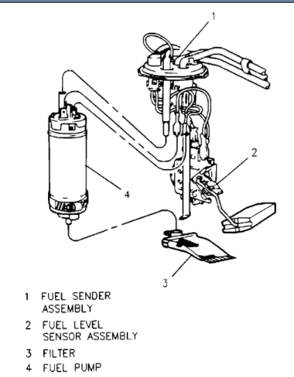

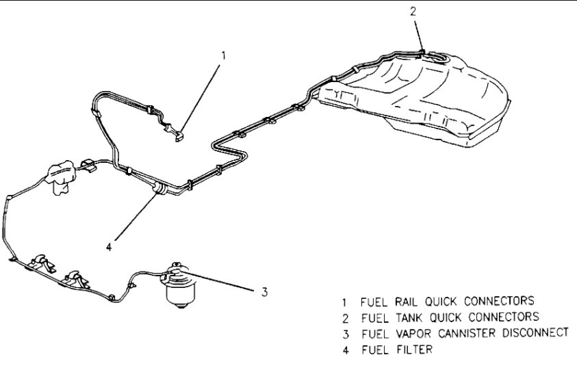

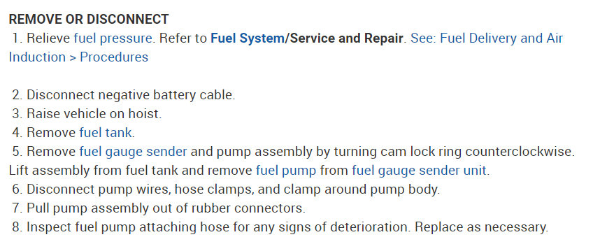

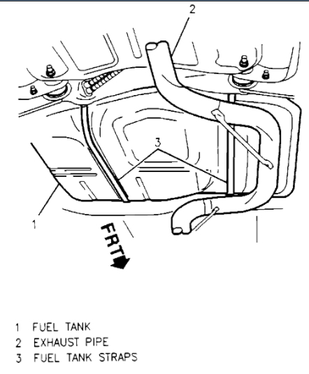

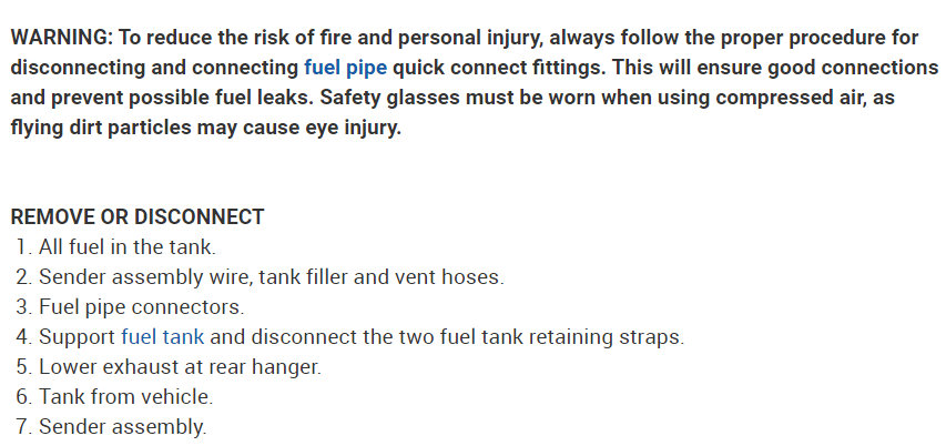

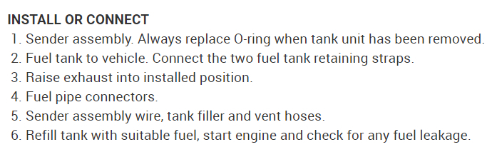

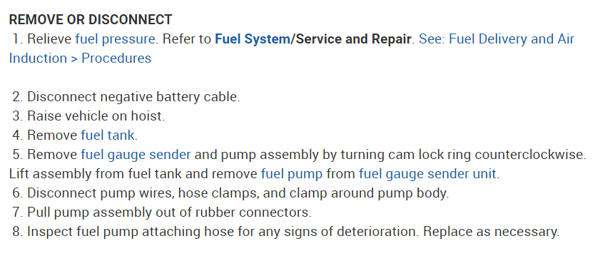

Yes, that is way too low. It is your fuel pump. The pressure should be 41-47 PSI with the key on. Here is a tutorial showing what is involved in changing an in-tank fuel pump:
https://www.2carpros.com/articles/how-to-replace-an-electric-fuel-pump
I've attached picture steps below on how to remove and replace the fuel tank and fuel pump for your car. Keep us updated with your progress and let us know if you have any further questions on this issue. Hope this helps and thanks again for using 2CarPros.
Danny
