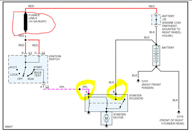

okay, here goes; I had some trouble with the exhaust system. I got that fixed two plug wires got cut (please don't ask) fixed that (new wires) then she refused to start. took the alternator in got it tested came back fine pot it back on checked the battery not perfect, so i replaced it with a new one. still no start. tried jumping the solenoid per mechanics suggestion didn't work. so, pulled the starter took it in for a rebuild mechanic insisted on checking it first. I'm glad he did, it was fine. so, brought it back put it on and hunted down the 20-amp fuse but again it was fine. so, i popped open the fuse panel and checked all of those fuses, all fine. put in a new set anyway just in case still no start. I really do not know what to try next. a guy at the parts store said a switch on the steering column, but I'm not sure what he meant. If you could help me out i would really appreciate it.

If you turn the key and get nothing, either there is a wiring issue, a bad starter, an issue with the park/neutral safety switch, or a power issue. Take a look through this link. It explains what to test when you have a starter not working.
Also, see if it will start when you place it in neutral. If it doesn't, we need to determine if or where the power loss is.
I pulled up the wiring schematic. There is a fusible link that may have failed. It powers the ignition switch.
I attached the wiring starting system wiring schematic below. Here is what I need you to do: First, there is a black heavy gauge wire direct from the battery. It should have 12v at all times. Confirm that.
If that is good, locate the thinner purple wire on the starter. That wire should have no voltage until the key is in the start position. Have a helper turn the key to the start position while you check for voltage to the purple wire.
If there is no power, either the fusible link has failed or there is an issue with the ignition switch. However, my guess is it would be the fusible link.
See pic below.

hi, i'm back. sorry for the delay it has been raining more often than not here. but i did finally get back to work on the car still haven't located the problem. Unfortunately, someone added a couple of things to the harness under the dash and they were not very tidy about it. You wouldn't have a diagram of those wires would you?

hi, well, i tried the neutral position and still nothing. All of the lights, light up inside but as soon as you try to start it everything goes off.

You indicated as soon as you try starting it, everything goes off. That sounds like a loose connection at the battery. Check to make sure they are clean and tight, and the battery is fully charged.

Hi, sorry it took so long to get back to you, but everything started dropping babies and i couldn't get to the car. Well, long story short. A friend had it towed to a mechanic where they replaced the starter and declared it fixed. I'm afraid it's just a band aid and this will happen again. So, I'm going to replace both the battery cables because I cannot find anything wrong with the other wires and apparently the bouncy ride on the tow truck giggled something just right because it turned over for them right after they dropped it off the wrecker. Does any of this make sense to you?

If the cables were loose or corroded, you are correct. The bouncing around on the truck could have allowed it to work.
As far as replacing the cables, if they appear to be in good condition, just make sure they are tight and clean. I'm here if you have trouble, so please feel free to let me know if things change.
