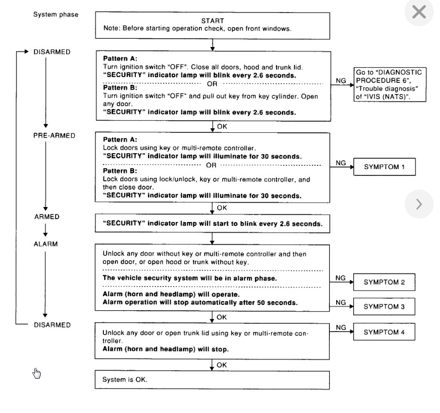

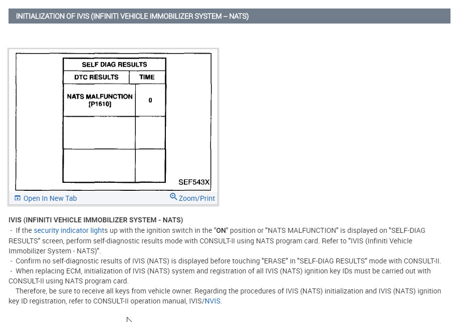

I put a new battery in and it won't start now. When I connected new battery the horn went off used the key in driver's door to shut it off. But car won't start. I have lights,etc. but engine won't turn over.
Nov 1, 2019 at 12:00 AM
Do you have multiple keys? Have you tried using another key?
If so it sounds like the immobilizer system has lost the key programming and you are going to need a scan tool to relearn them.
Let me know if you have access to a scan tool and we can go from there. Thanks
