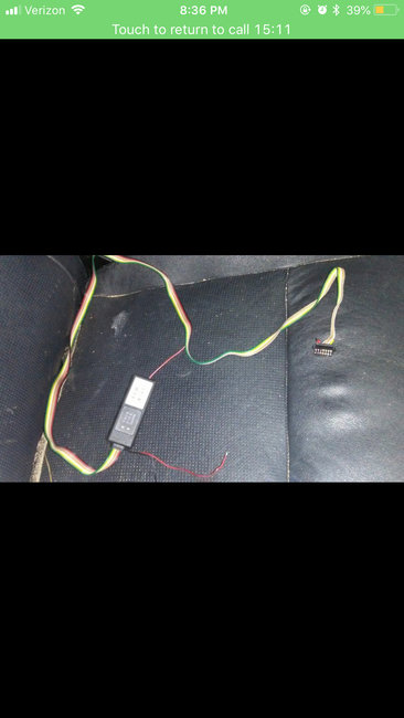

What do you think it can be? I need help ASAP. I already spent a lot of money on the car. He thinks it is something with the computer, because he says there is no signal sent to the spark plugs from the computer. He said he checked compression, time belt, and everything. He said he does have current on the coils. He also found this:

I meant to put he says there is no current on the coils*

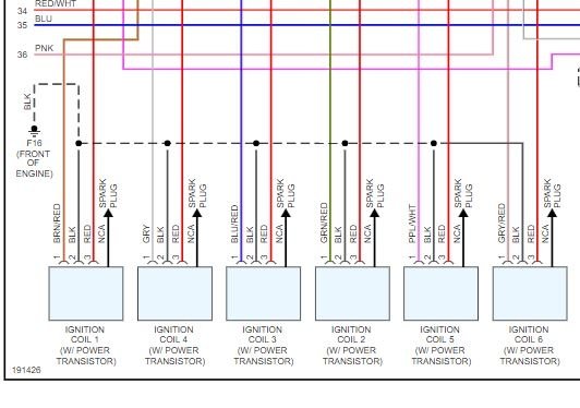

Did he check all the fuses?
Wednesday, February 6th, 2019 AT 12:25 AM
  • 52,797 POSTS

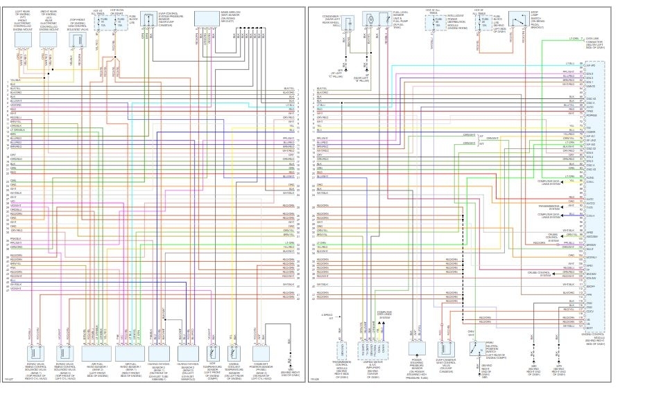

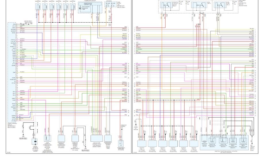

Here are wiring diagrams for him to view and needs to check the red wire to the coils.

The wiring needs to be checked. All the signals need to be checked and powers and grounds.
