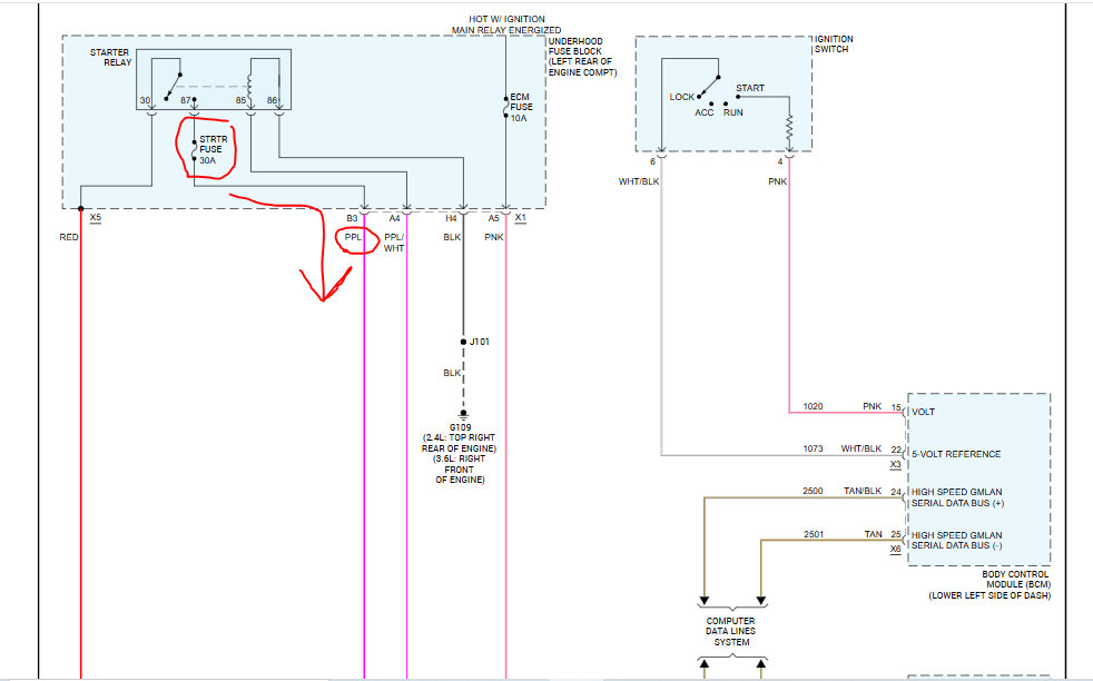

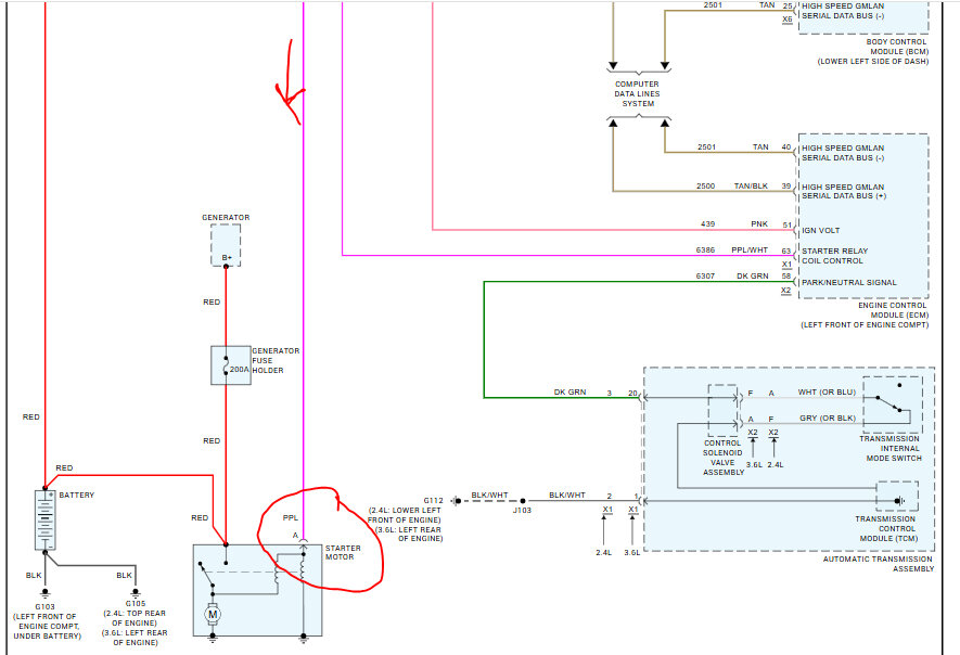

Okay, if you hear the relay click, it sounds like it is working. If the starter doesn't engage, we need to work backward from the starter motor to see if it has power and, if not, where it is lost.
I attached the wiring schematic below for the starter circuit. At the starter motor, there will be a smaller gauge purple wire. Have a helper turn the key to the start position while you check if the purple wire gets power.
The purple wire is the trigger wire and should only have power when the key is in the start position. Try this and let me know what you find.
See pics below. Note: I had to cut the pic in two to make it readable. I overlapped the two so you can follow from one to the next.
Jan 29, 2025 at 10:58 AM
