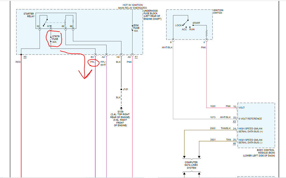

I went to the car one morning and the car wouldn't start. It still was the original battery, so I replaced it, and the car ran fine for about a week. That's when I noticed that the engine control relay was continuously ticking. Pulled the starter and had it tested, and it was good. I checked it with a OBD2 scanner, and I had no codes. Checking all the fuses I could find that has to do with starting the car and I couldn't find any that are bad. There were other things in the past week that have me thinking it's the engine control module, but I don't want to drop another $400.00 to $500.00 if that's not it. Any thoughts?

When I turn the key, nothing happens except for the relay clicking. I replaced the relay with a new one and have the same result. The battery is now and fully charged.

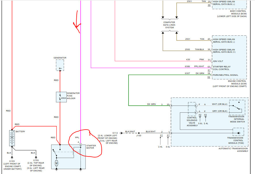

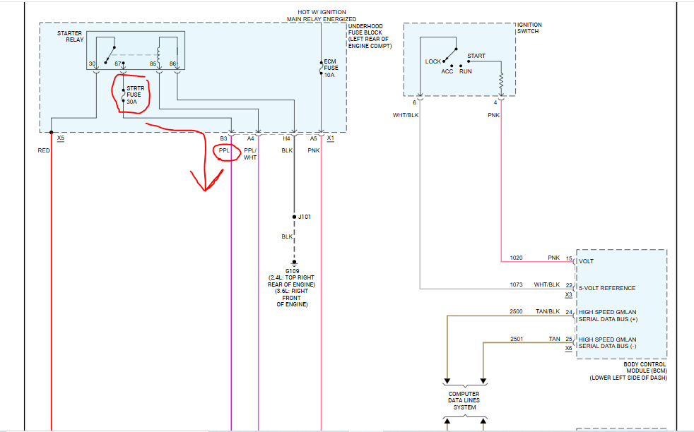

Okay, if you hear the relay click, it sounds like it is working. If the starter doesn't engage, we need to work backward from the starter motor to see if it has power and, if not, where it is lost.
I attached the wiring schematic below for the starter circuit. At the starter motor, there will be a smaller gauge purple wire. Have a helper turn the key to the start position while you check if the purple wire gets power.
The purple wire is the trigger wire and should only have power when the key is in the start position. Try this and let me know what you find.
See pics below. Note: I had to cut the pic in two to make it readable. I overlapped the two so you can follow from one to the next.
