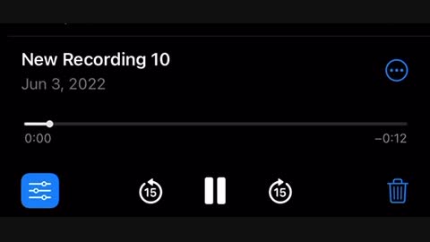

That’s the sound it’s making.
Aug 9, 2022 at 12:22 AM
  • 110,194 POSTS
Listening to that doesn't indicate a timing issue. Have you tried the other things I suggested?
