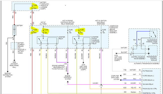

My coolant reservoir was cracked and after I replaced it my car wouldn't start again. So, I bought a new starter motor, new alternator with belt, and a new battery with new ground wires but when I go to start the car nothing happens.

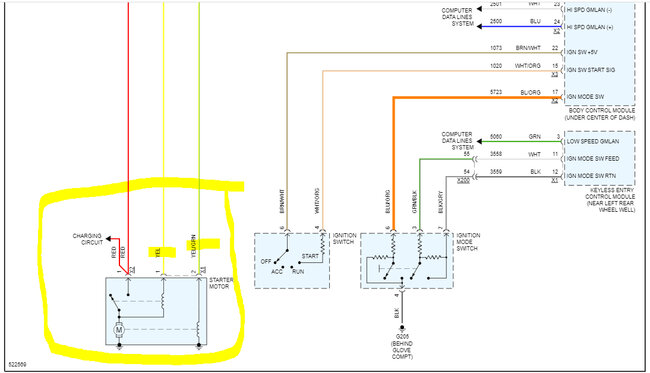

When you turn the key to the start position, do you hear a click or anything? I attached the wiring schematic below for the starter circuit, so you have a reference. I need you to check the fuses I highlighted.
Let me know what you find.

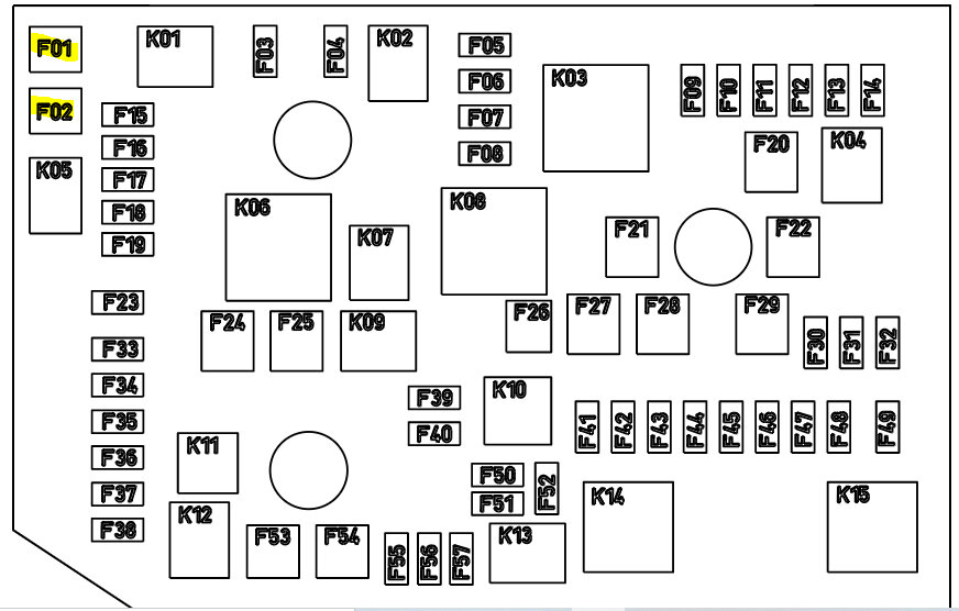

My fuse box is set up differently. I don't know what I'm looking at with the pictures you sent. I can send you pics and videos to help and show you what my display reads.

Absolutely, that would be helpful. I'm not sure why the fuse box is different. Are you checking the one in the engine compartment?
