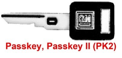

Changed fuel filter and pump injectors and put a new starter in. It won't crank or start, but a week ago was running fine the vehicle is the Limited model. I need some ideas please.

HARRY P
  • 2,292 POSTS
Have you checked the key and security system? Does the key have a chip in it like the one pictured below? If so, then you have to check into the security system. If there's a problem there, then the immobilizer in the body control module will keep it from doing anything.
Jan 15, 2019 at 6:55 AM
CHRIS GORDON
The key does not have a chip in it and the car does not have any kind of anti-theft on it. plus we changed the wires from the battery and still the starter isn't getting any juice. thanks for the help.

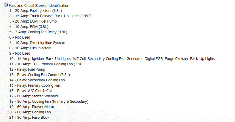

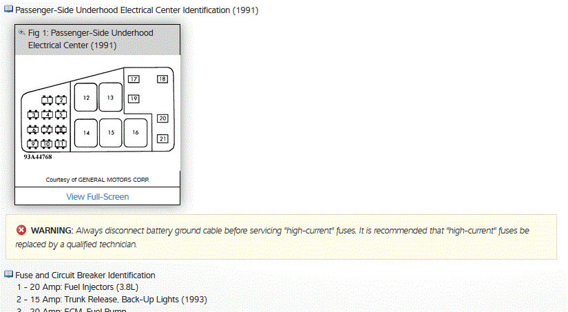

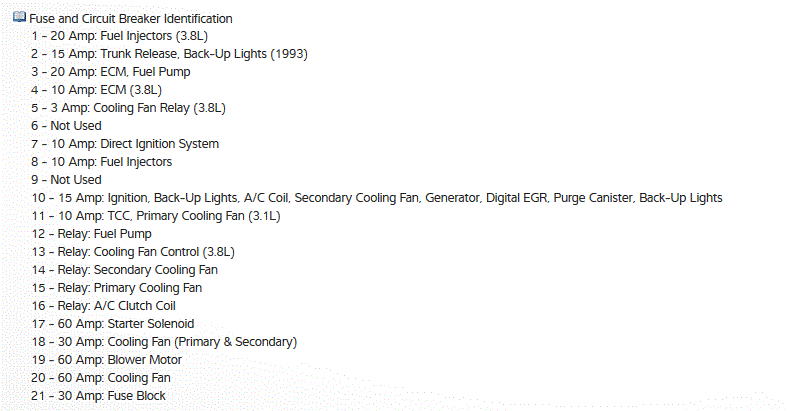

HARRY P
  • 2,292 POSTS
Also, here's the layout of the passenger side under the hood fuse box. Check #17. It'd be nice if it were that simple.
