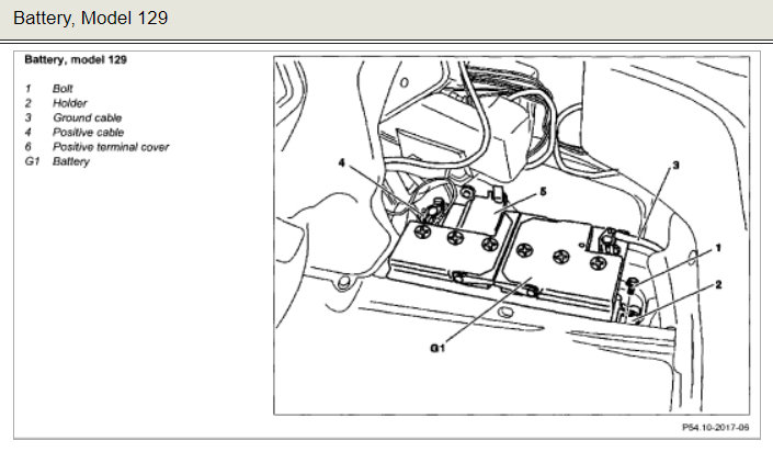

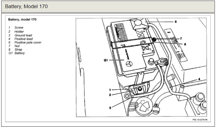

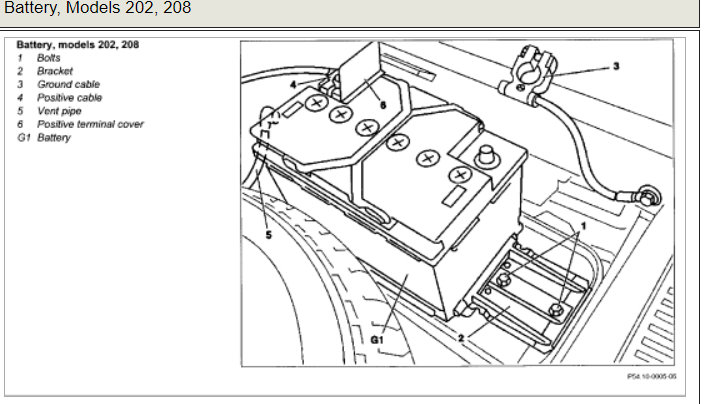

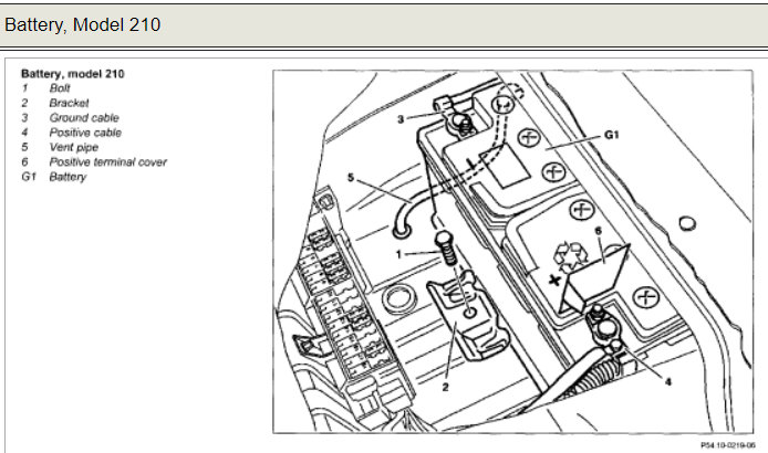

Oh man that is cold. It sounds lie to me that you have a battery that is getting weak. To confirm the failure please do this test.
and if bad this guide will give you an idea on how to change it out.
https://www.2carpros.com/articles/how-to-replace-a-car-battery
Is could be a bad connection as well.
Please run this test and get back to us.
