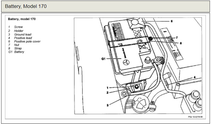

The car model is an E320. It is below zero weather when i turn the key the gauges are clicking up and down the trunk popped open by itself. the dash says display defect, the climate control screen says eee.
Jan 2, 2018 at 12:19 AM
  • 55,381 POSTS

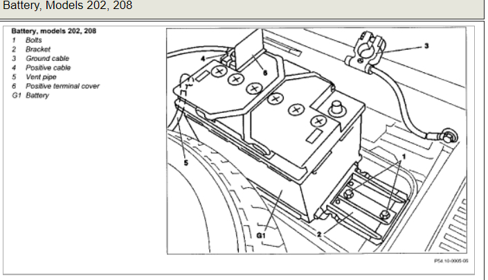

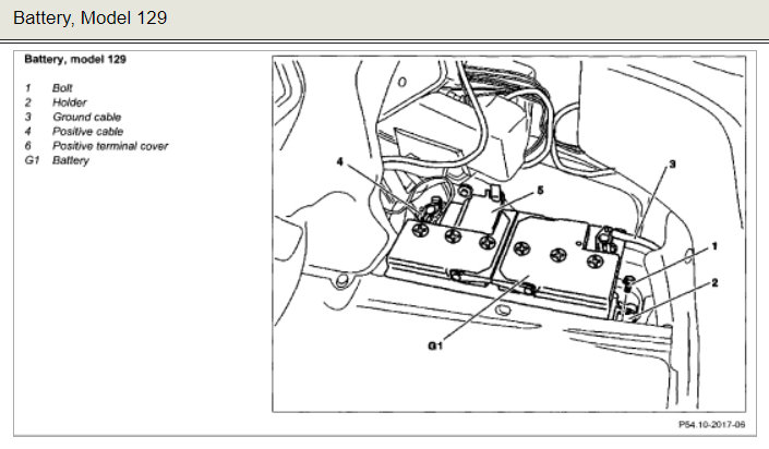

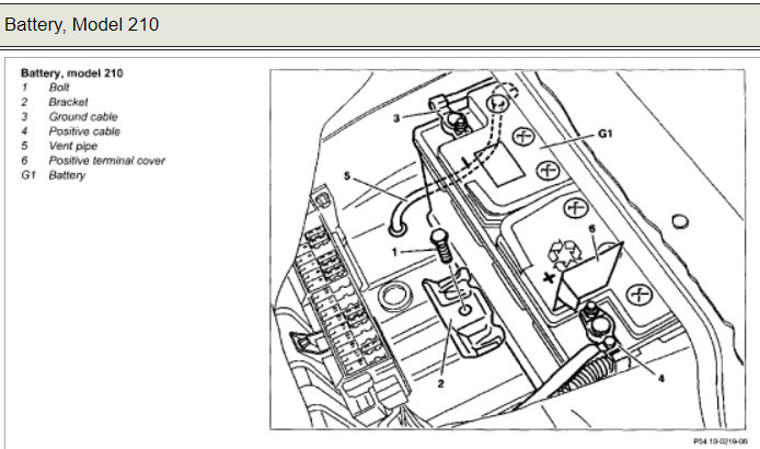

Oh man that is cold. It sounds lie to me that you have a battery that is getting weak. To confirm the failure please do this test.
and if bad this guide will give you an idea on how to change it out.
https://www.2carpros.com/articles/how-to-replace-a-car-battery
Is could be a bad connection as well.
Please run this test and get back to us.
