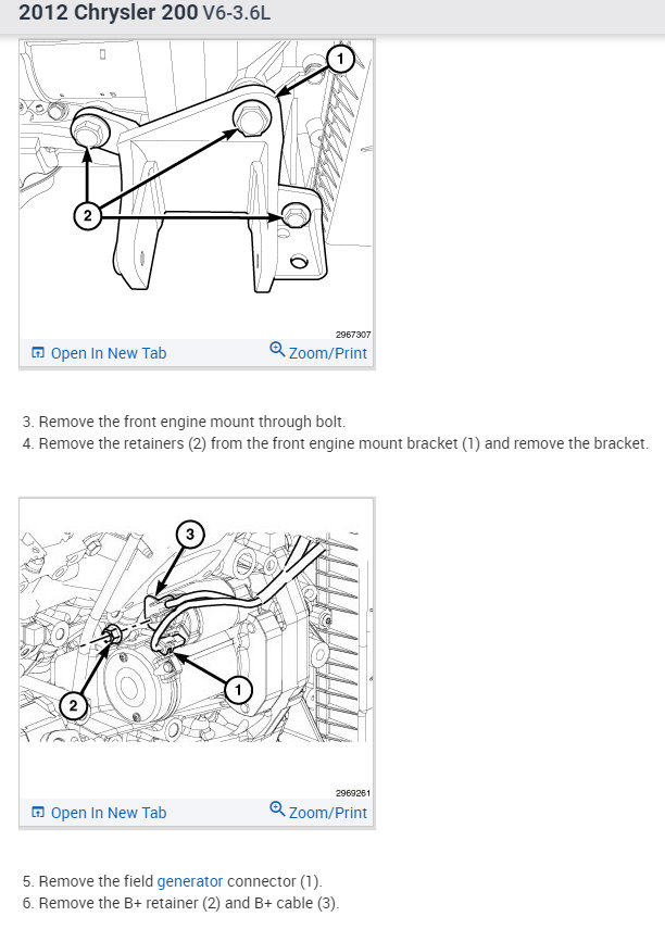

So, is it cranking over but not starting or when you turn, the key it only makes a clicking noise?
If it just makes clicking noise, it could be due to a faulty starter. It can also be due to corroded battery cables.
If the engine is cranking over but not starting it could be due to not getting spark or fuel.
Let me know a little more details of what you are experiencing.

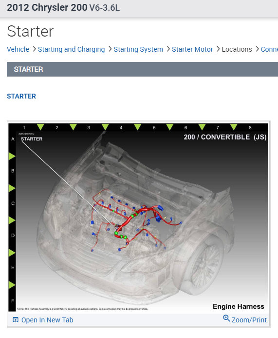

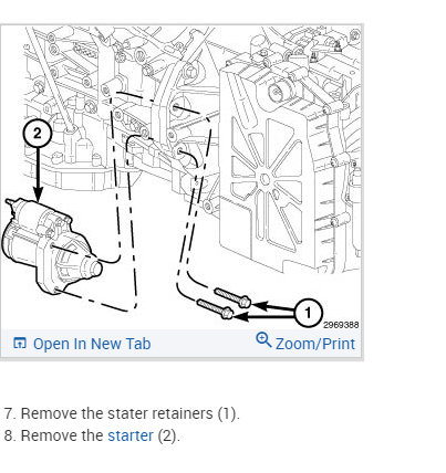

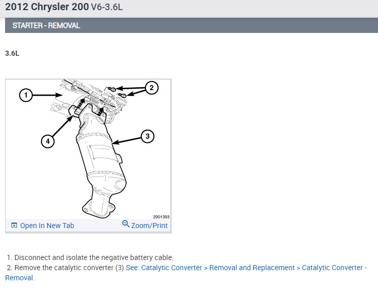

I have attached the starter replacement procedure below for your reference.
