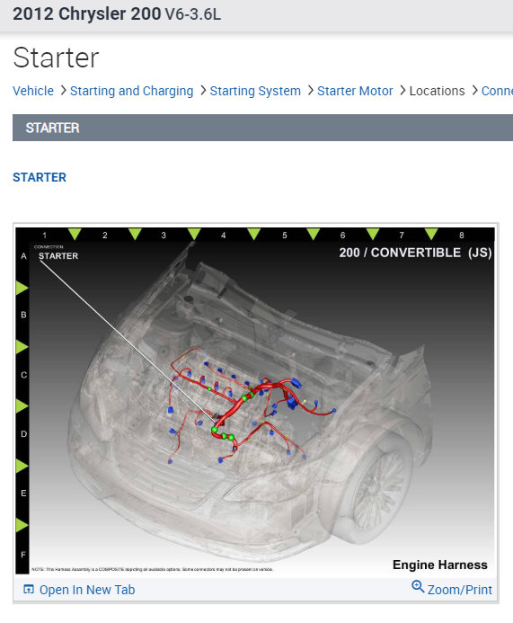

AAA said it's not my battery, my battery is good. I really need some suggestions of other things to look at and maybe how to look at them to find out what else could be wrong and making it not start.
Jun 5, 2022 at 9:39 AM
SQM
  • 6,383 POSTS

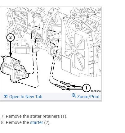

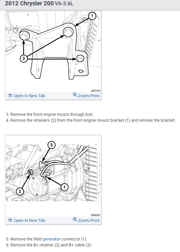

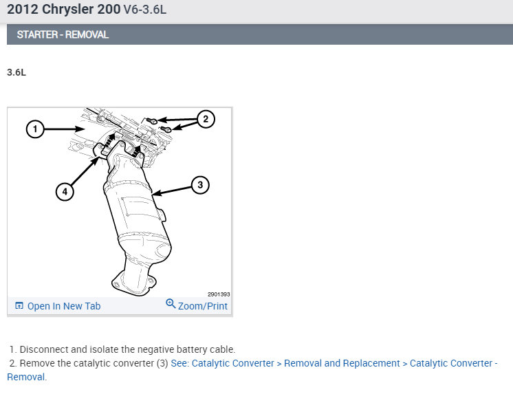

So, is it cranking over but not starting or when you turn, the key it only makes a clicking noise?
If it just makes clicking noise, it could be due to a faulty starter. It can also be due to corroded battery cables.
If the engine is cranking over but not starting it could be due to not getting spark or fuel.
Let me know a little more details of what you are experiencing.
I have attached the starter replacement procedure below for your reference.
