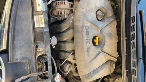

My car won’t start, it isn’t a battery issue, the motor turns over, but I think the problem either has something to do with the spark plugs or maybe a clogged fuel line. I included a video of me trying to start the engine. Any ideas what the problem could be?

It does fire off on a couple of cylinders. So, it could be a fuel pressure, ignition, or compression issue. Did it start this all at once? Were there any indications of a problem prior to this point? Was the check engine light staying on prior to the no-start?
Before I send you different tests, I think we should pull the spark plugs to see their conditions. In reality, the manufacturer recommends replacing them at 100K miles, but you may have a couple that failed.
I need to know the engine size or the 8th digit of the VIN so I can get you the correct procedure.

It started all at once. The check engine light wasn't on and I don't believe there were any issues starting it before.
The VIN 8th digit is E.

Will it start if you press the throttle to the floor?
Also, here is a link that explains how to test fuel pressure. You will need a fuel pressure gauge. Most parts stores will lend one to you.

The engine doesn't start when I press the throttle down, but the sound does change a bit.
I'll check the fuel pressure next.

Let me know about the fuel pressure. I listened to the video a few times. If the fuel pressure is good, we may need to check to see if engine compression is off. It sounds odd to me when cranking.
