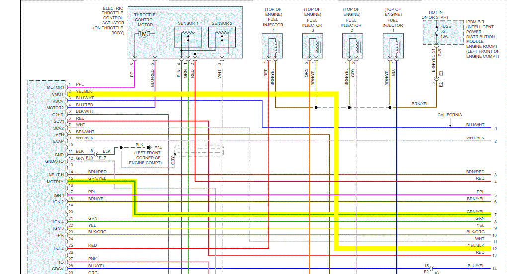

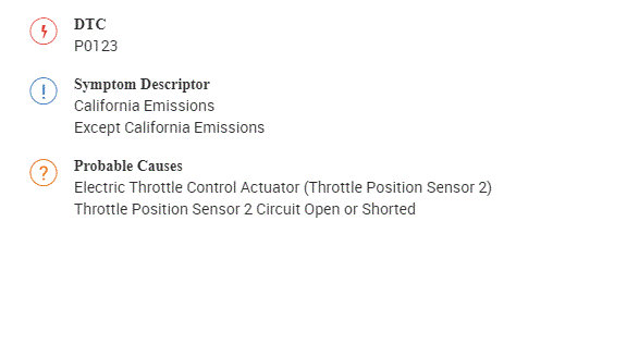

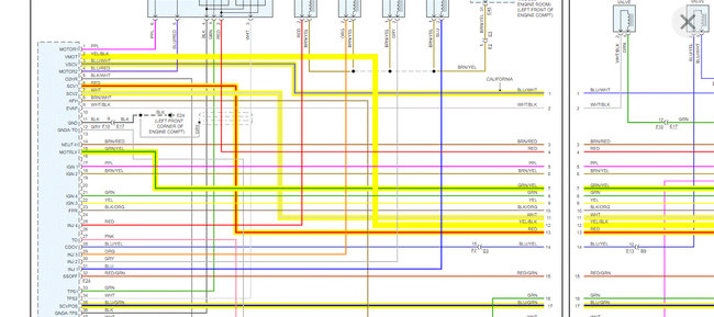

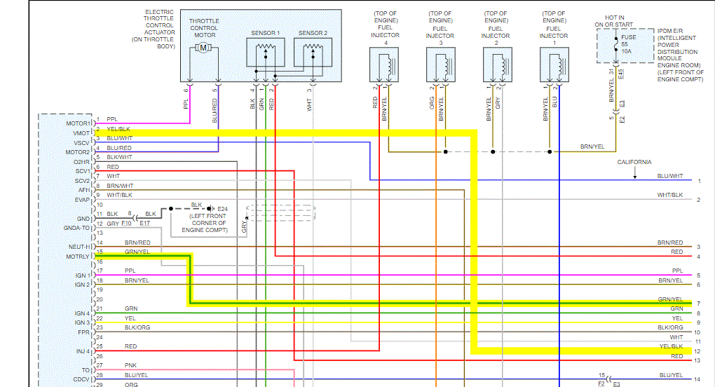

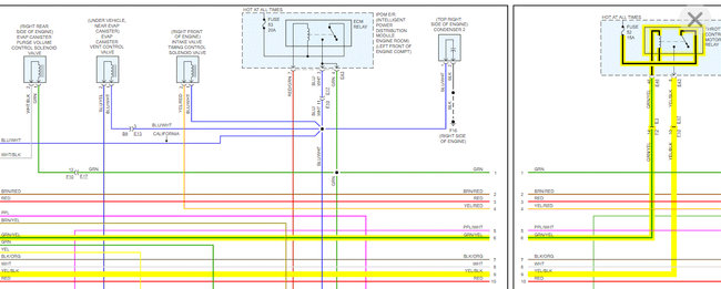

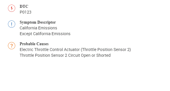

Am getting approximately 9.6 v from the injector connectors, am also getting codes about throttle/pedal; p0123 throttle/pedal position sensor/ switch A/B high, p2119 throttle actuator control throttle body range performance etc. is the voltage supply to the injectors not supposed to be battery voltage?
Aug 12, 2020 at 12:00 AM
Correct.
What is your battery voltage?

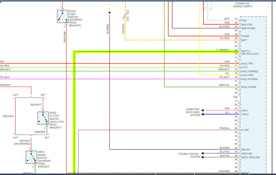

The voltage is low for the injectors. I would verify the connections and test the battery.

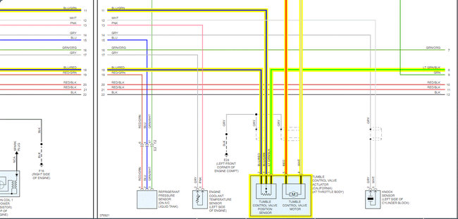

The 123 is for the throttle actuator as well. check the connections to the throttle body for any damage.
I attached a wiring diagram for you to view of the actuator system. You will need a scan tool to monitor the operation of the throttle.
In most cases, the throttle assembly is the issue.
