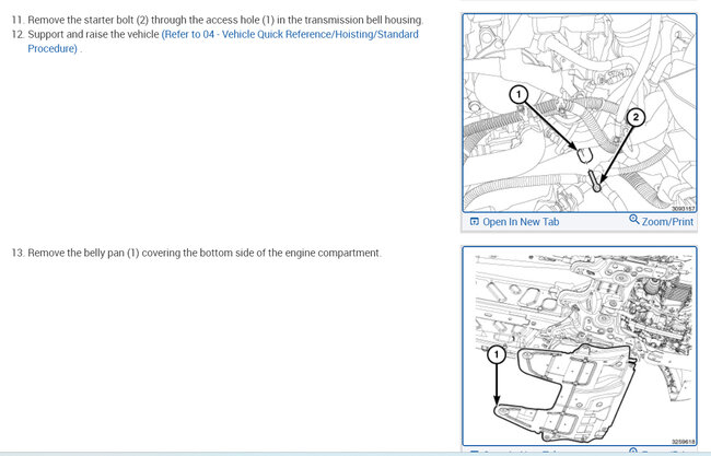

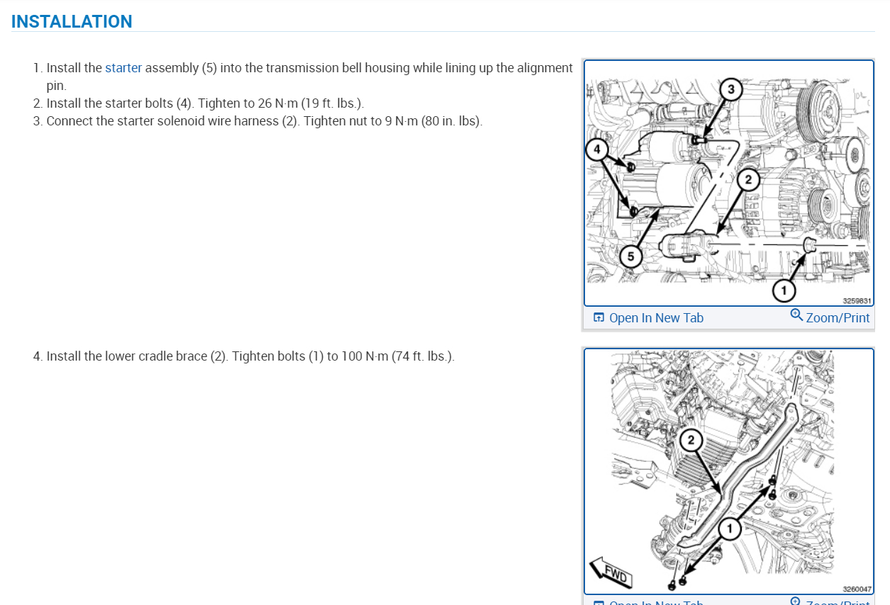

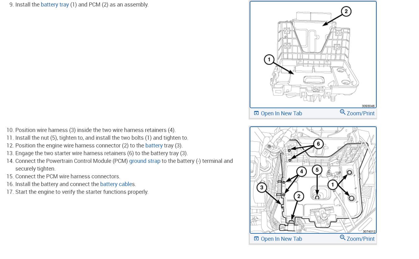

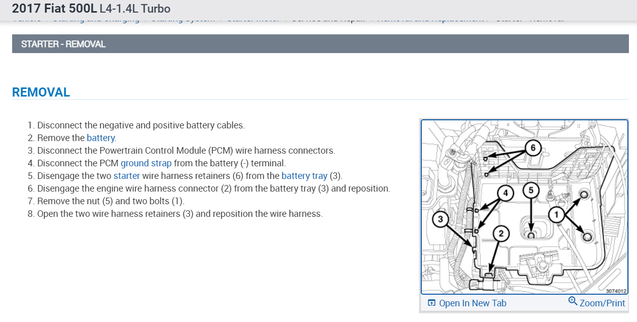

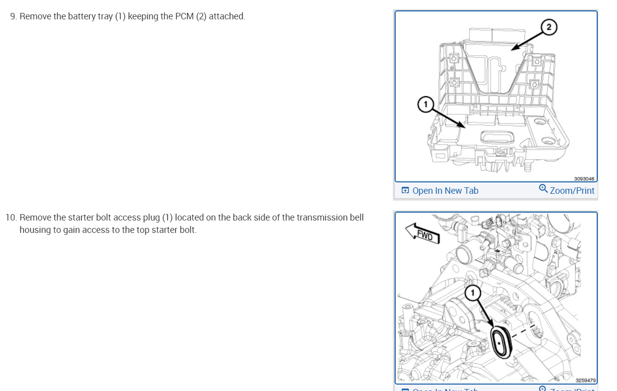

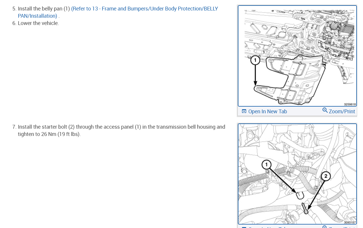

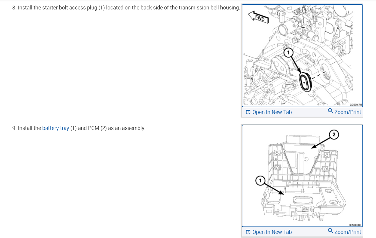

Will go with a jump start then once engines off won't start again. Replaced battery still nothing. Dashboard lights all on, electrics work and key fob works. Got display saying check number plate light now too. People saying earthing strap or starter motor but not sure where to begin, any advice please?
Apr 28, 2023 at 9:17 PM
  • 55,402 POSTS

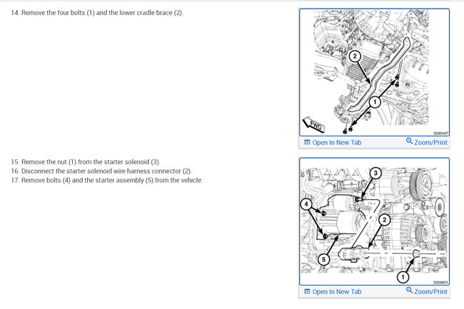

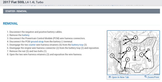

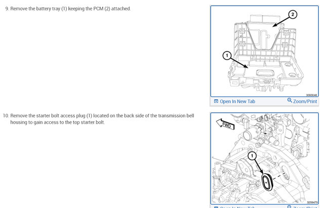

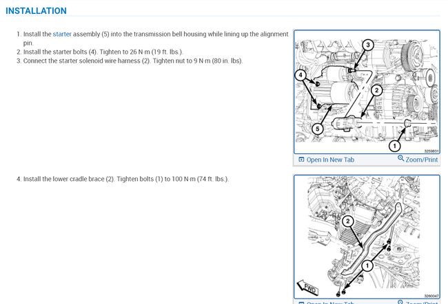

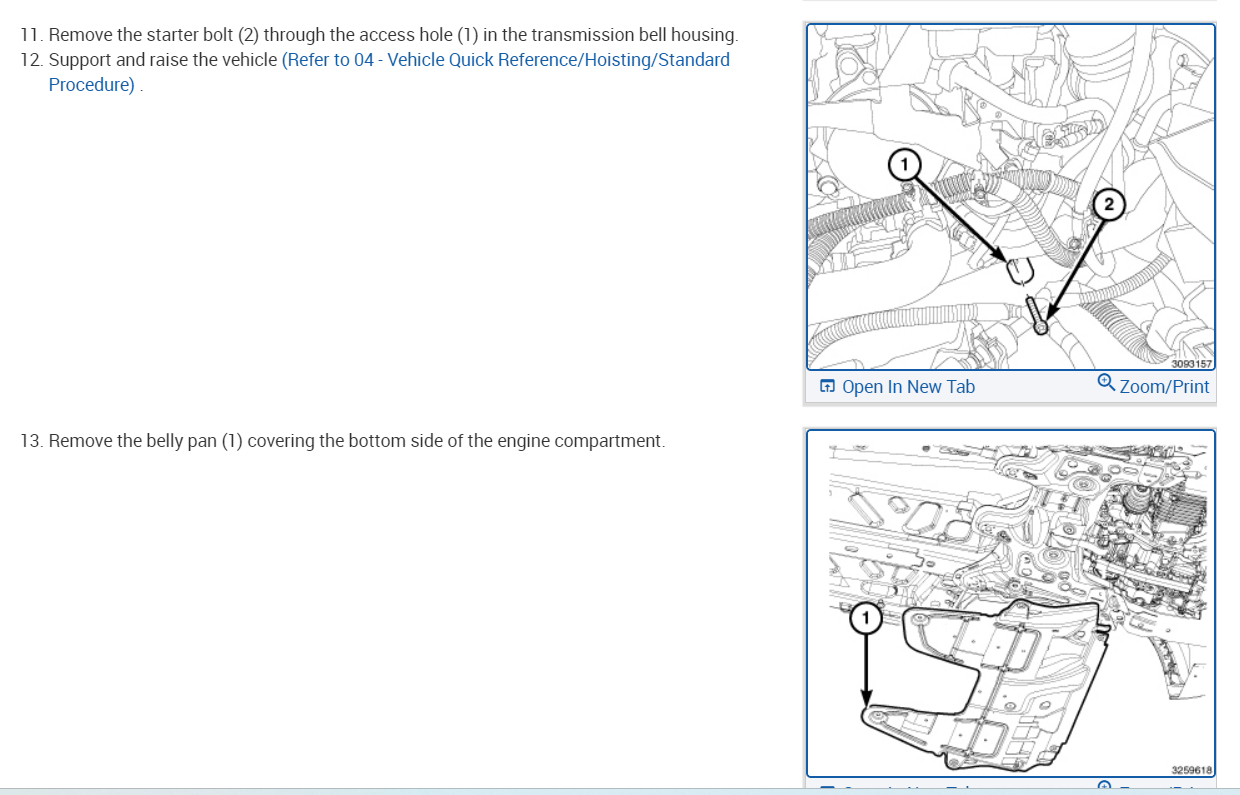

I would check the negative and positive battery cables to make sure they are clean and tight. If so, the next step is to replace the starter motor because it sounds like you have high resistance.
Here is a guide to help and the starter replacement instructions in the images below:
