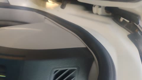

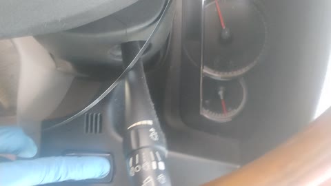

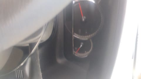

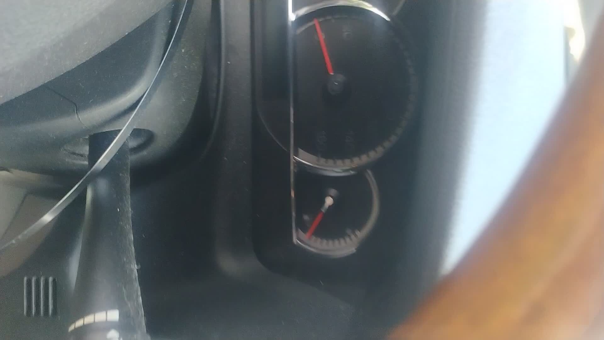

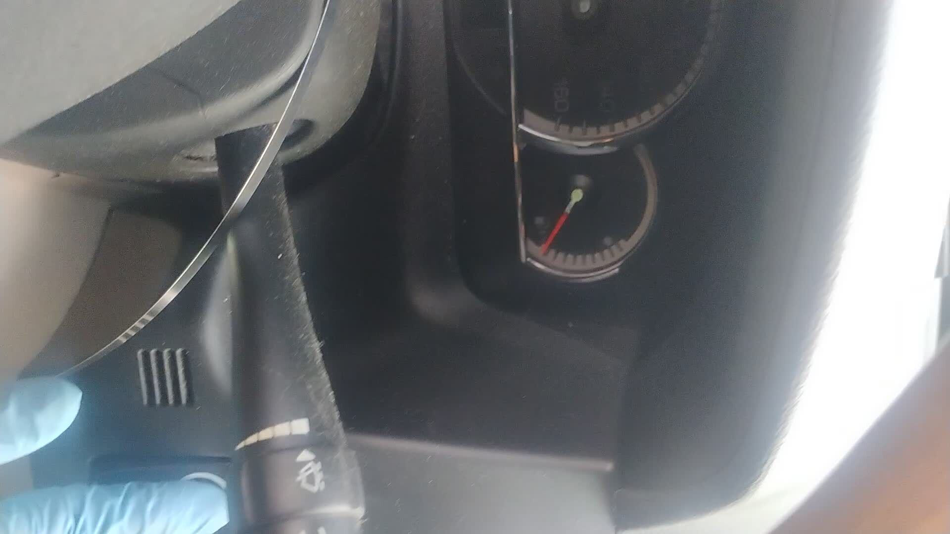

ASHLEY0839
  • 9 POSTS
And yes I lose electrical power, I can't tell really where the clicking noise is coming from but it sounds like it's coming from the area in the video I just uploaded... It does have a good battery, and it's got a good connection... Everything is clean as far as the connectors. It just makes no sense cause when I bought it , I myself heard the car run after that guy jumped it with his jumper box and it ran perfectly fine... The motor sounded brand new . And I get it home and now this?

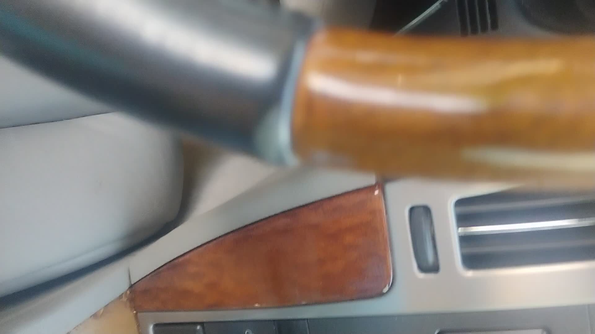

ASHLEY0839
  • 9 POSTS
Now also, so this car has a push start button, but it doesn't look like it came from the factory, but on the key fob it's like a regular key fob, yes it has a key in the fob but that only goes to the doors.. I'm wondering if this push start button is working right??? It just doesn't look like something a factory would put in it.
Jul 13, 2025 at 6:12 AM
  • 55,395 POSTS
It sounds like you found it, the aftermarket push button starts are not very good and fail often. I would remove it and put he wiring back to stock.
