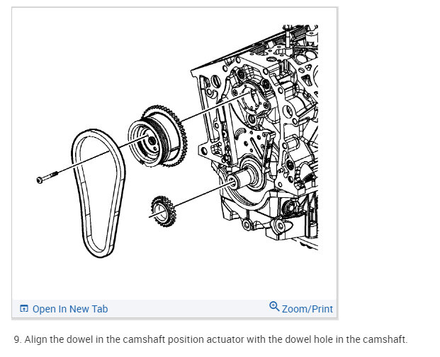

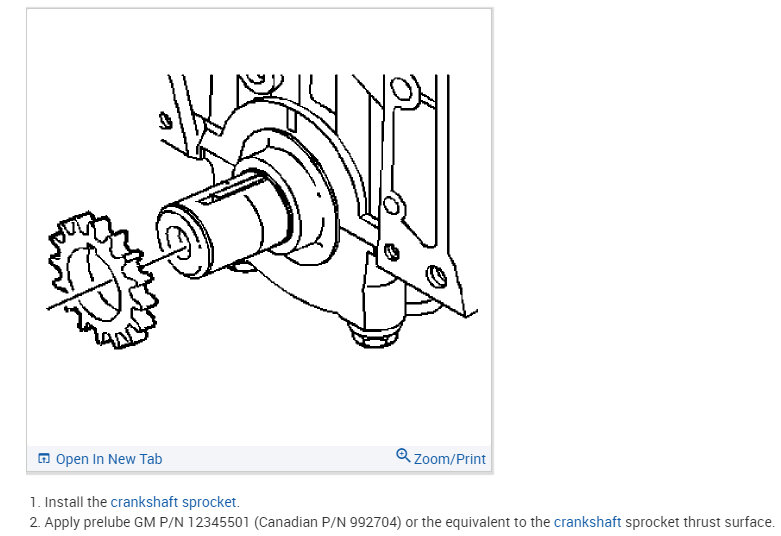

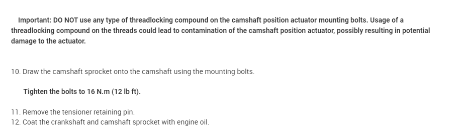

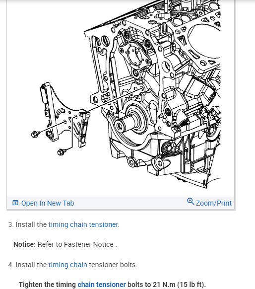

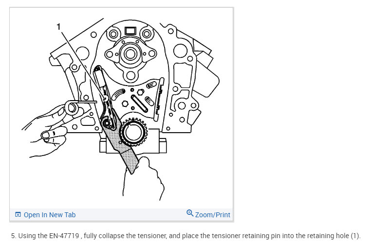

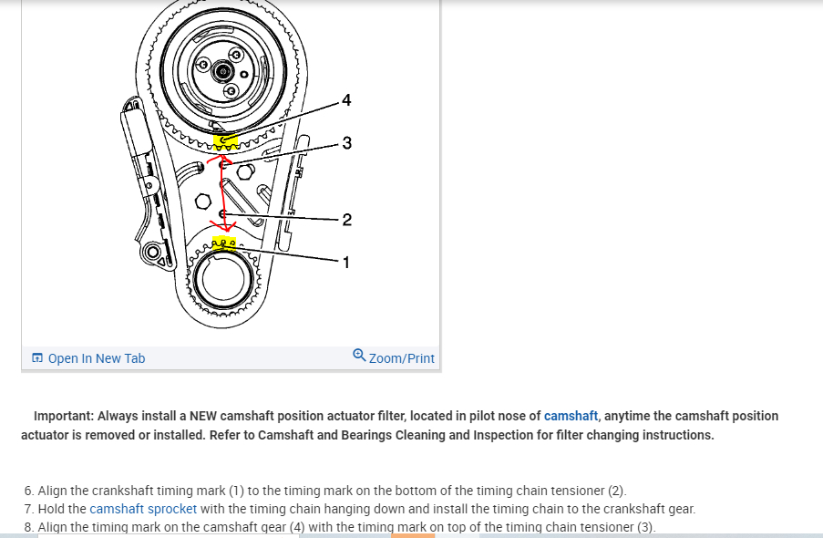

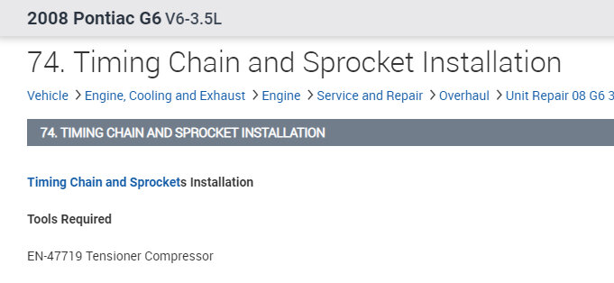

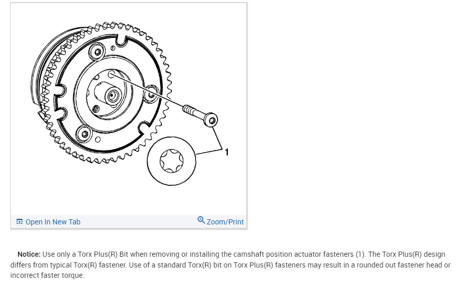

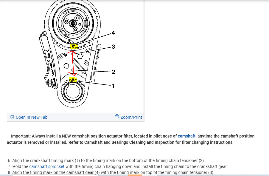

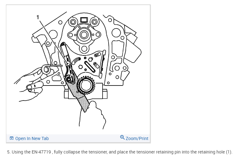

Also, this is an easy one to time as far as the timing chain is concerned. I attached the directions below for the installation. Take a look at them and let me know if you have questions.
Basically, the crank sprocket has a mark that points at 12 o'clock and the cam has one that points at 6 o'clock. I highlighted them below.
Take a look and let me know.

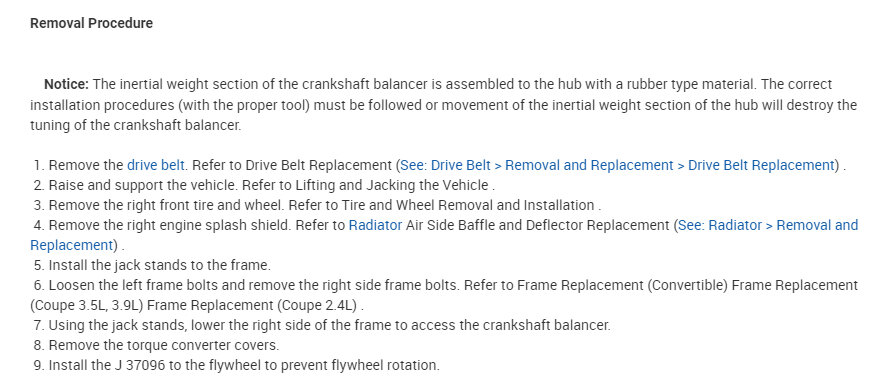

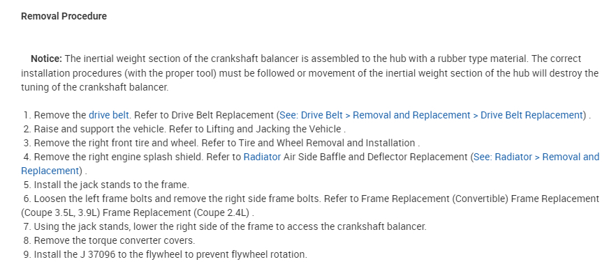

Thanks, I have spark now but still won't start. I can't get the crankshaft pulley off; I've been at it all day. Is there any way to do it with the pulley on? I'll send you the video of how it sounds.
May 3, 2023 at 9:47 AM
  • 110,251 POSTS

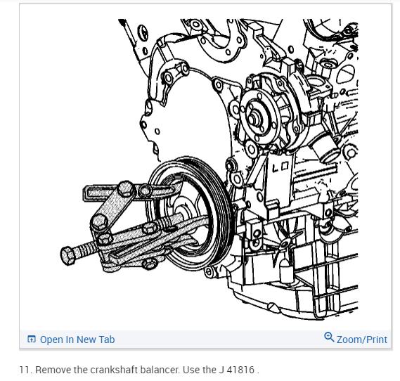

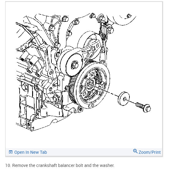

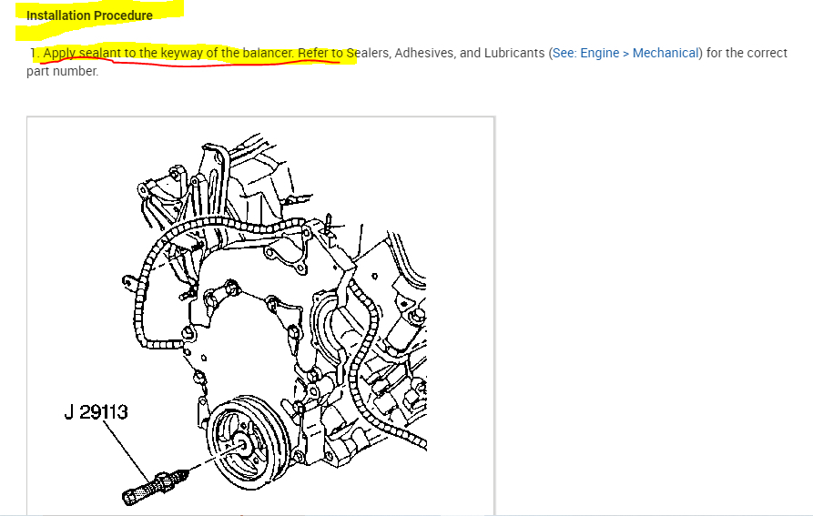

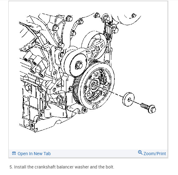

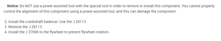

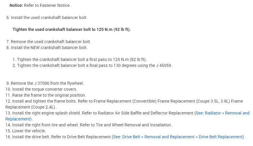

If you have spark, have you checked if it will start with starting fluid? Also, is there a reason to remove the harmonic balancer? I'm not sure if you are doing it to replace the crankshaft position sensor. If that is the reason, leave it the way it is for now. Let's see if it starts with starting fluid. If it does, we have a fuel-related issue.

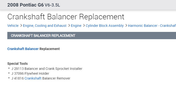

I attached directions below for removing the crank pulley/balancer. Let me know if they help.
