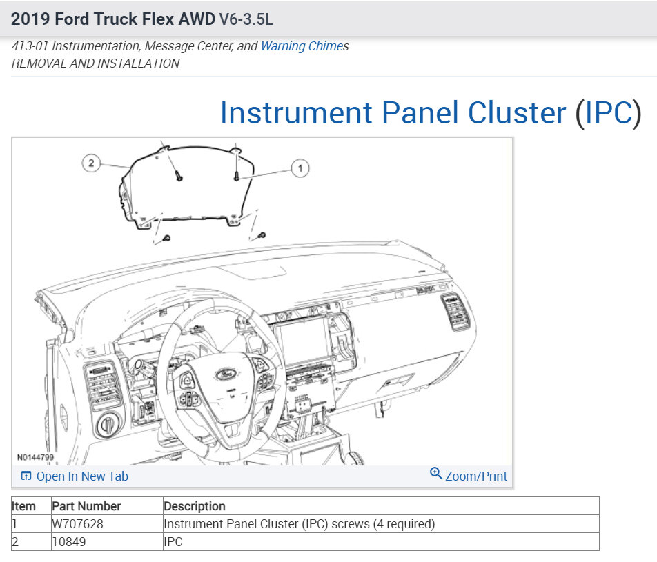

Yes, I have seen this when the instrument cluster goes out which will cause the problem you are describing. To be sure we should do a CAN scan. You can get a CAN scanner (Controller Area Network) which will work on most cars from Amazon.
https://youtu.be/u-4syLc-ifQ

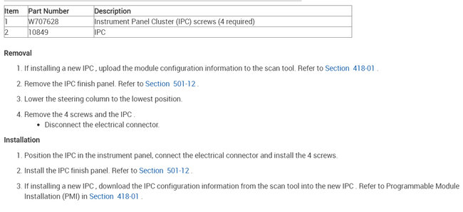

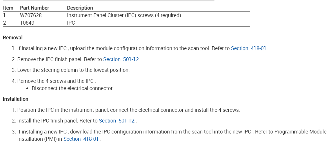

Please get back to me with the codes, here is how to change the instrument cluster out in case a code is stored for it. You can get a preprogrammed unit by searching Google or Ebay make sure to have your VIN number ready. Check out the images below. Please let us know what happens.

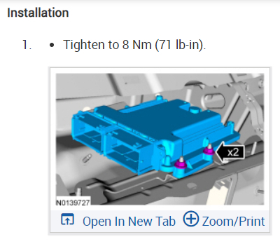

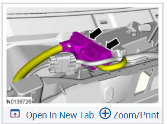

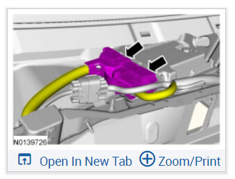

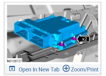

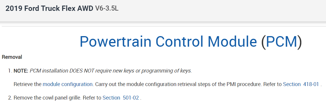

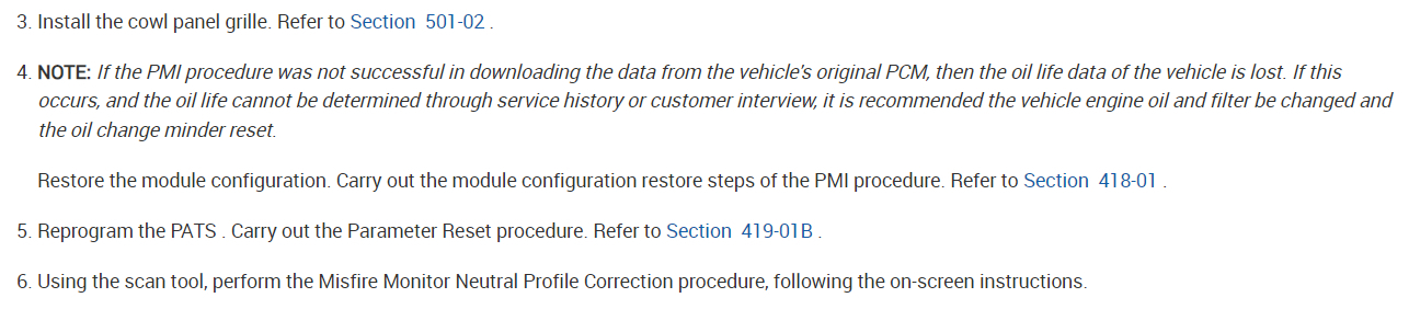

I believe the PCM could going bad though, but I would drive it until it had another problem then I would send the PCM for testing or get a rebuilt unit. I have left the location and instructions on how to change out the PCM, you can get a preprogrammed unit by searching Google or Ebay. Check out the images (below). Let us know how it goes.

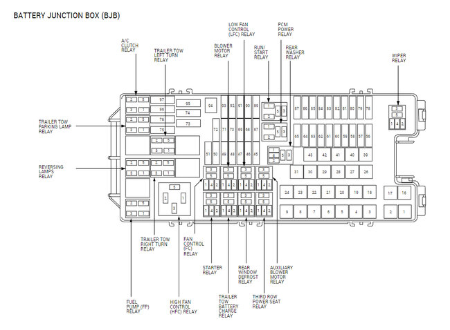

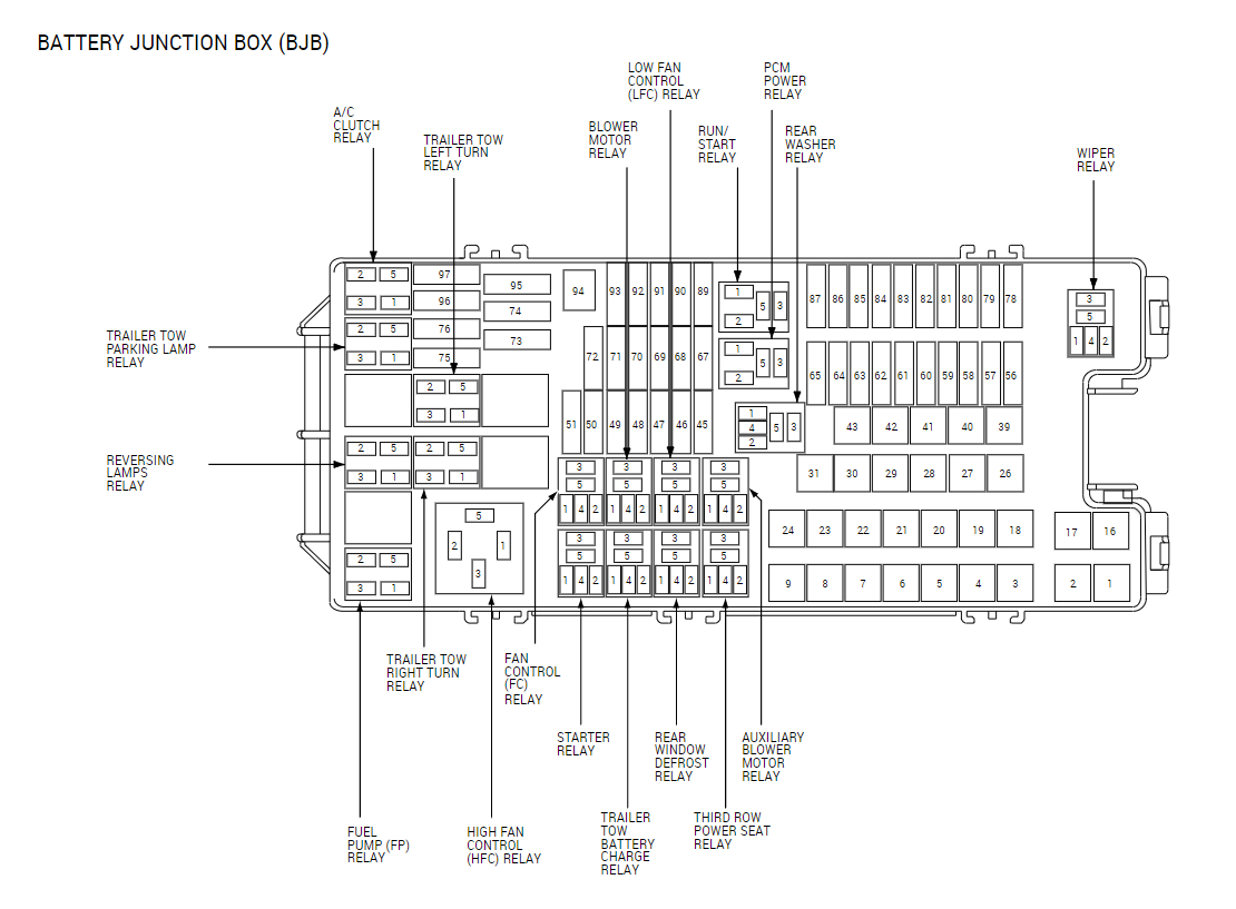

Did you try the hard reboot? Here are the fuse locations so you can check them out. Check out the images (below). Please let us know what happens.

Do I need to check every single fuse, or are there any particular fuses that could be causing this? I already ran through the fuses and all interior fuses were good, some fuses in the engine compartment didn't seem to have power even with the key in the on position. Also, do you know how I can locate the ground wires for the PCM, as I have heard that can be an issue and prone to corroding?

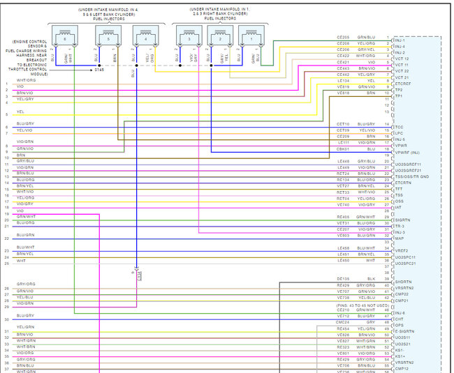

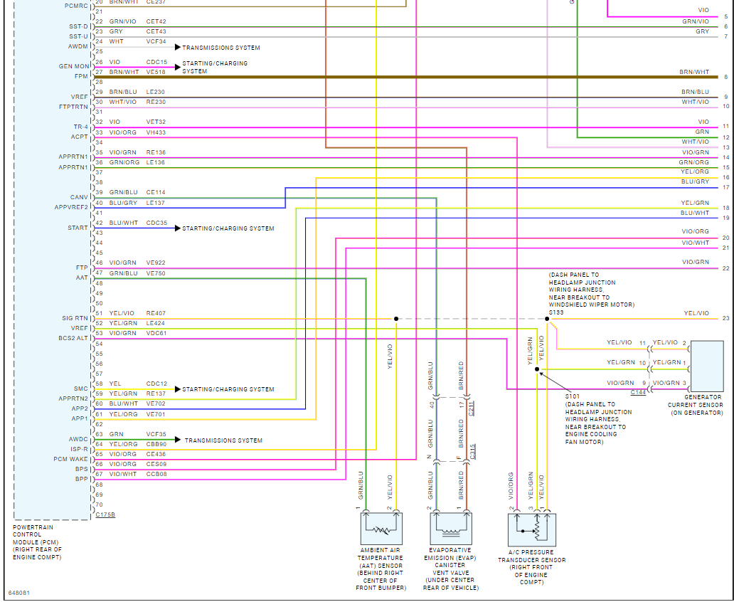

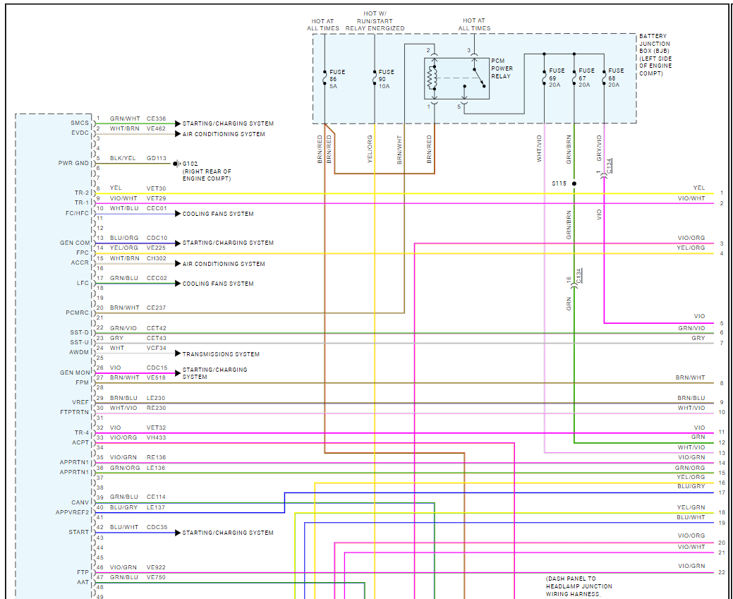

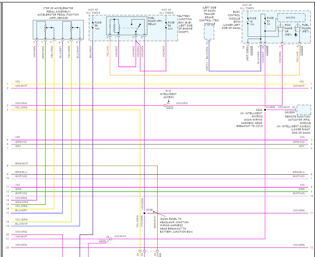

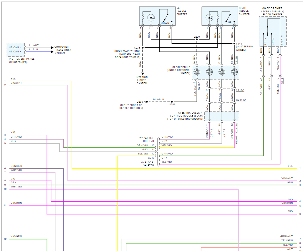

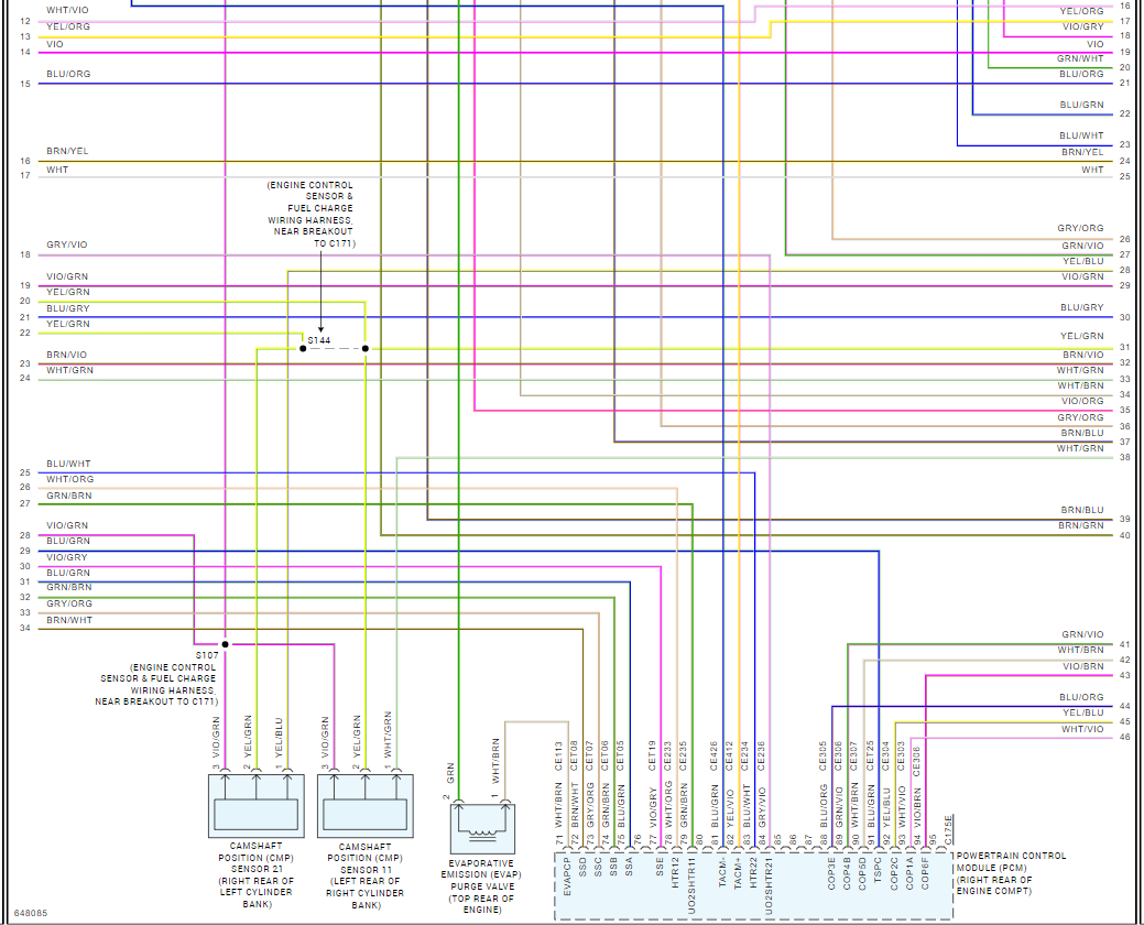

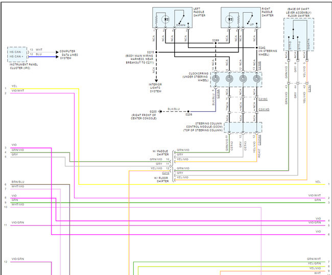

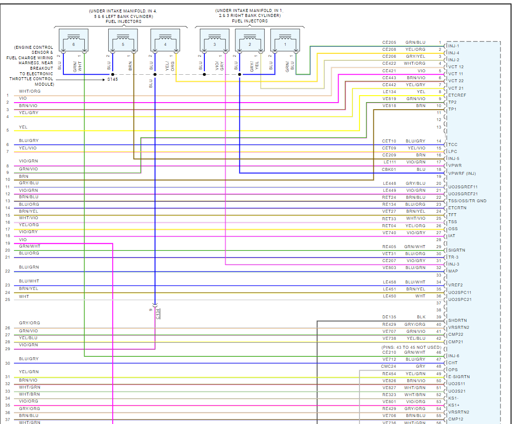

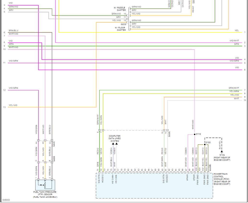

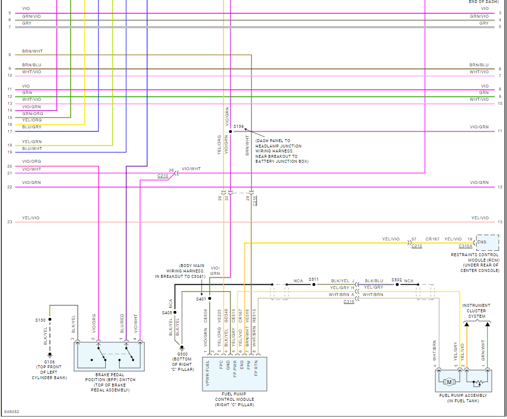

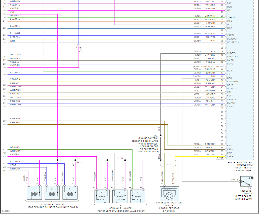

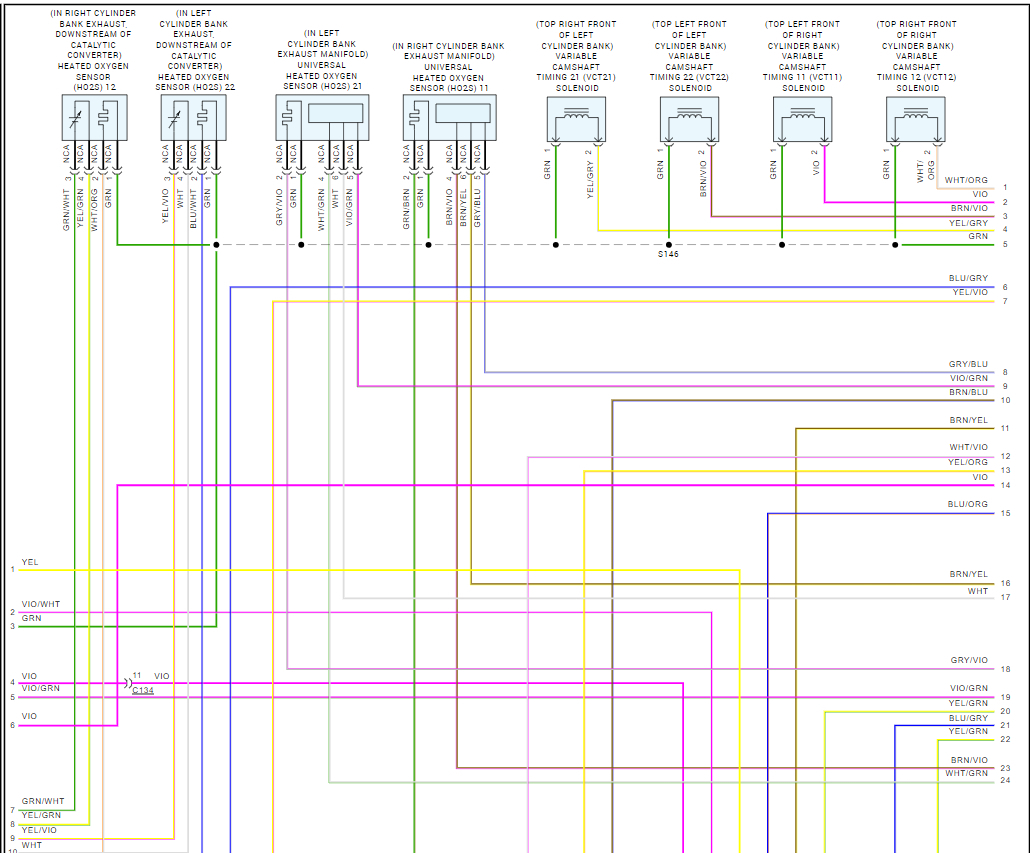

The fact that the mileage is held in the cluster and that it had dashes is a sign the cluster is out, so I am back to that which could cause the entire problem. Did you try the CAN scan? Here is the wiring and locations of the PCM grounds as requested. Check out the images (below). Let us know what you find.

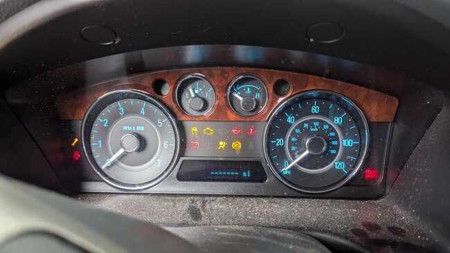

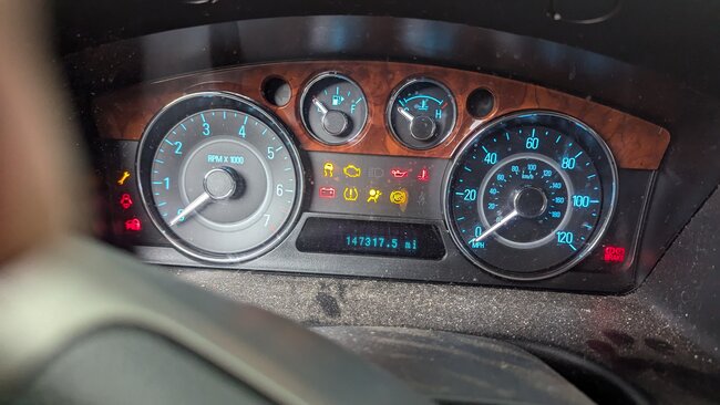

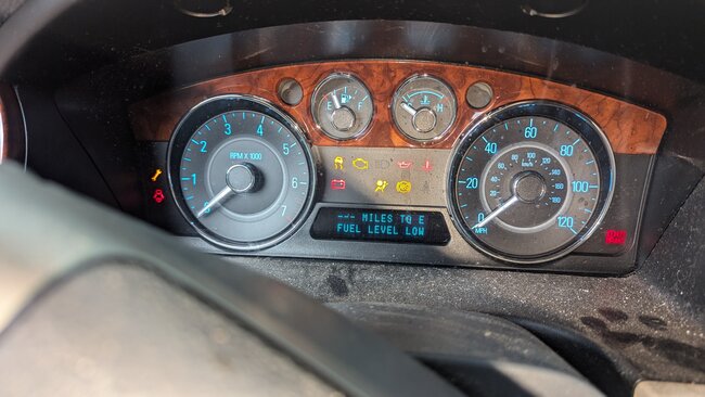

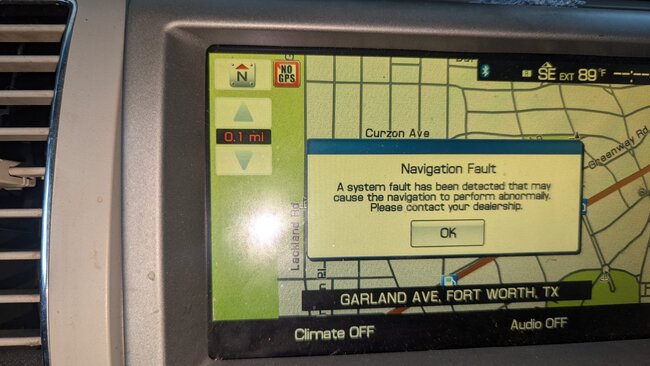

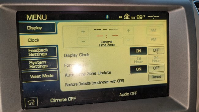

Thanks a bunch my guy! I started tracing the grounds but it started raining so I didn't finish yet, but I thought I'd send you a couple pictures of some issues I'm not sure if I mentioned to ask if you thought this would be instrument cluster, or PCM, or some wiring issue. The first picture is of the clock on the nav panel, it will not set or allow me to set it through settings menu. The second is the error that I get when I go to the navigation menu. The third is the ODO when I turn the key to the run position without cranking, and the forth is what it shows after I try to crank it. Pats does not recognize the key in either case. The final shot is of the fuel level either in the run position or after a failed crank. With the software error and the clock thing do you think it could still be the instrument cluster, or more likely PCM? Or could it be wiring, or something else? Thanks again sir, I really appreciate all your help, and I'm sorry I keep bugging you. Also thanks for the wiring diagram, I think I found the ground for the PCM. Just let me know what you think when you have a chance.
Jul 17, 2024 at 4:41 AM

Sorry, I missed that, thanks they help. Can I ask if the scanner you have does the CAN? Can you please upload an image of the scanner?

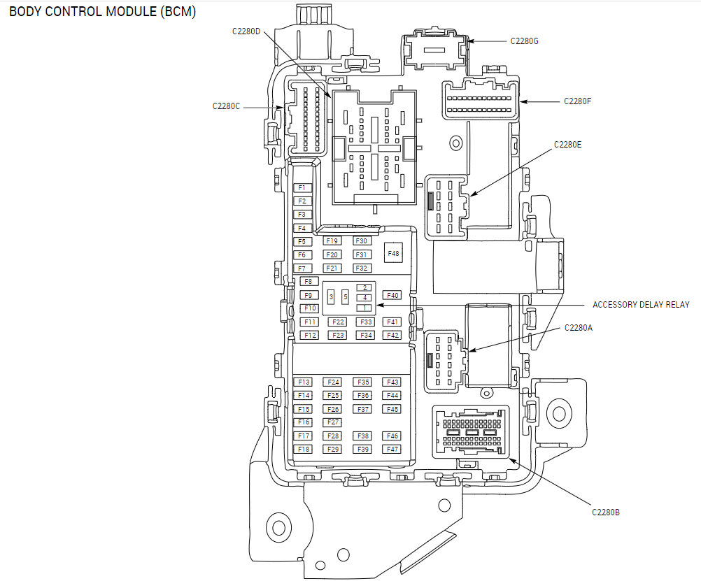

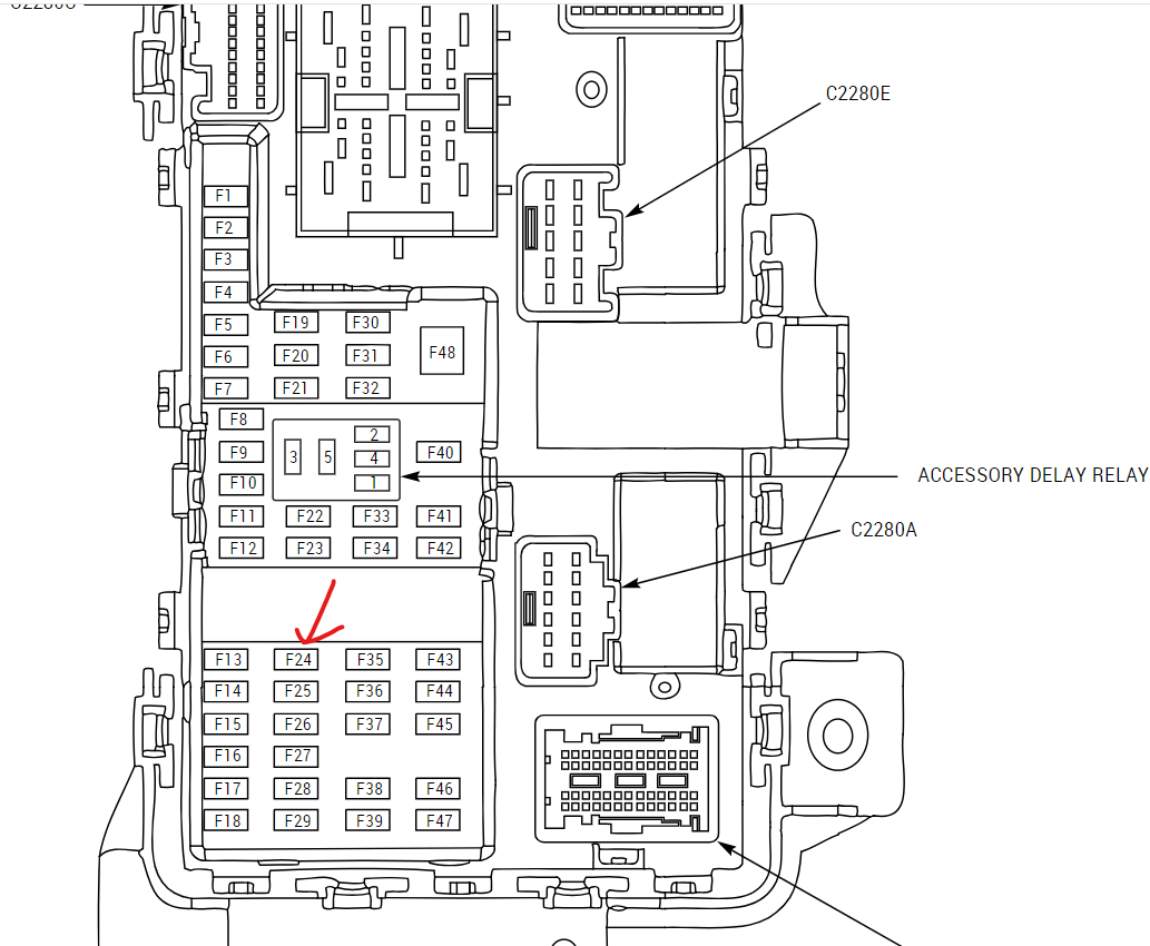

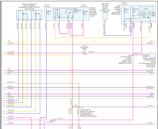

Can you please check for power at fuse the #24 one th BCM, it should be hot at all times. This guide can help.
Here is the location of the fuse. Check out the images (below). Please let us know what happens.

Sorry man, I couldn't check the fuse. That's not the fuse diagram for my car. The bcm doesn't match. I have a 09 Ford flex limited. Could you help me with which fuse I should check?
