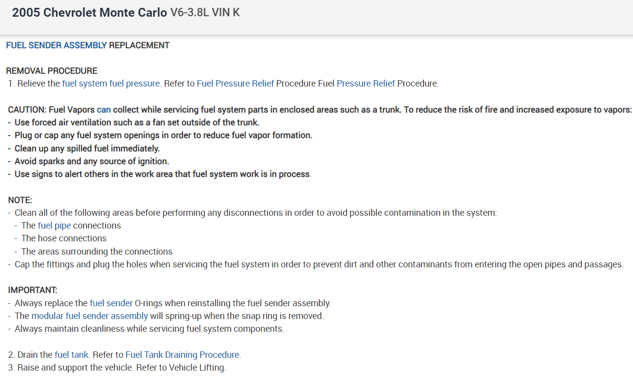

The car listed above an SS model Supercharged. I was driving for about 2-3 hours with no issues then car just shut off and was coasting just battery light was on. I was able to restart and drive a few more blocks then shut off again. Then got it started again, made it to the garage and it shut off. Was able to start it up a couple more times and it started surging and shut off. Let it sit. Starts fine when cold runs for about 8 minutes then surges and shuts off. It can start up again a few more times then it shuts off in under a minute until it won’t start again just crank.

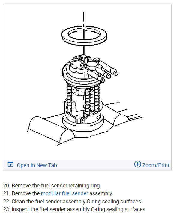

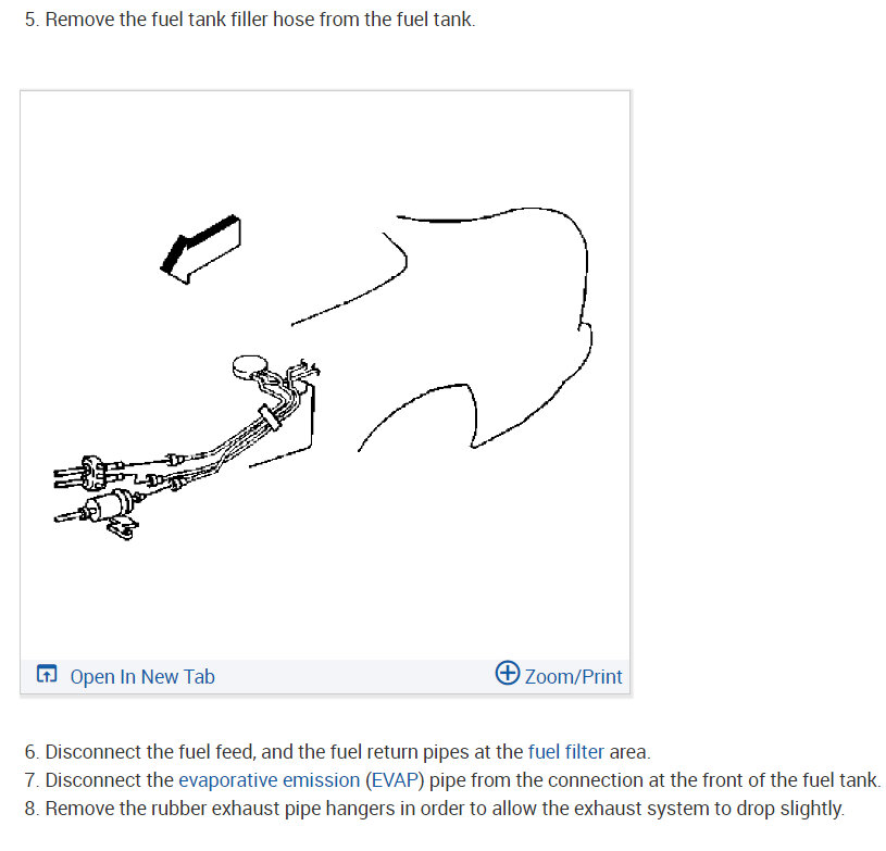

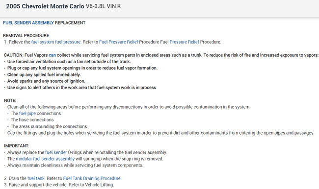

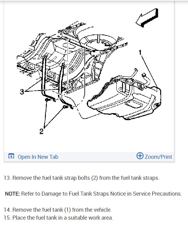

Yep, this sounds like a classic fuel pump problem, but to be sure please go over this video which can help confirm the issue:
https://youtu.be/lXLJbuAZ4CE?si=-r2bluAtXZCh3_8A
We should run the codes in case any are stored.

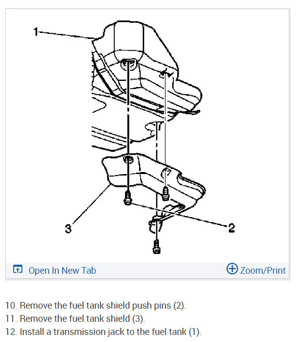

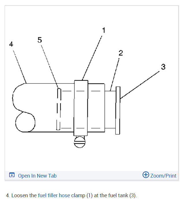

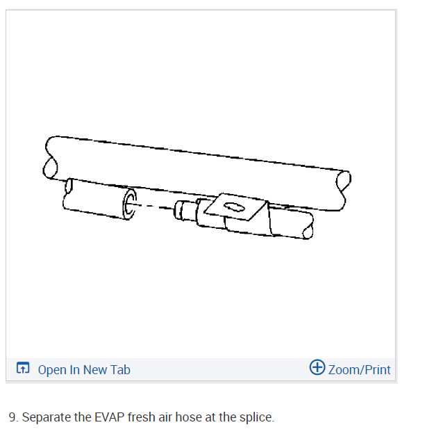

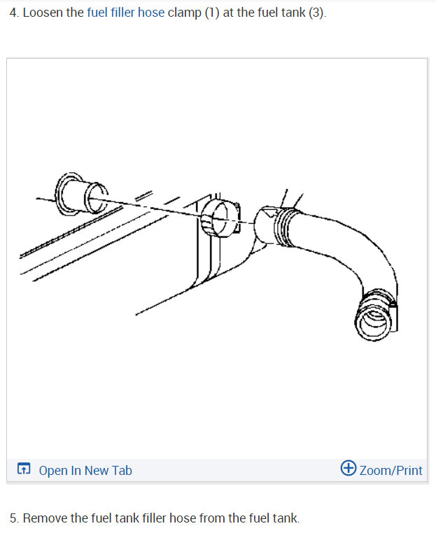

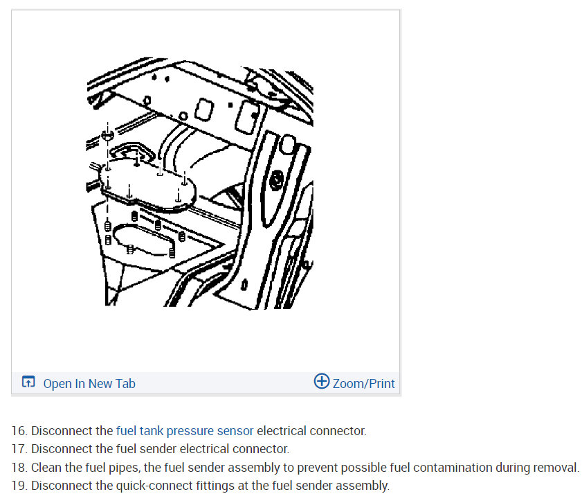

See if it starts with starting fluid to help confirm the fuel pump issue, here is how to change the fuel pump out. Also, if you turn the key on without cranking the engine over can you hear the fuel pump hum for about 5 seconds? Check out the images (below). Please upload pictures or videos in your response of any problems so we can see what to help you with.

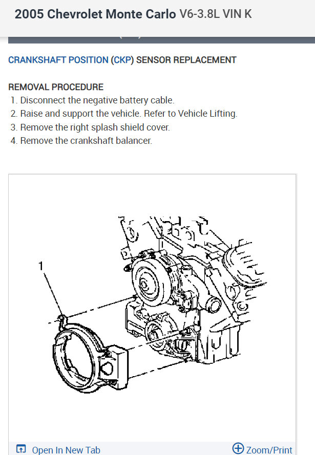

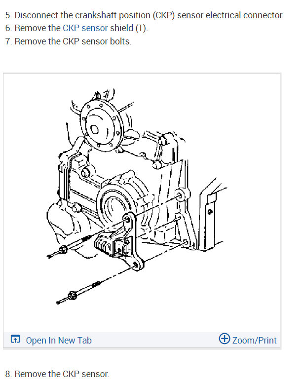

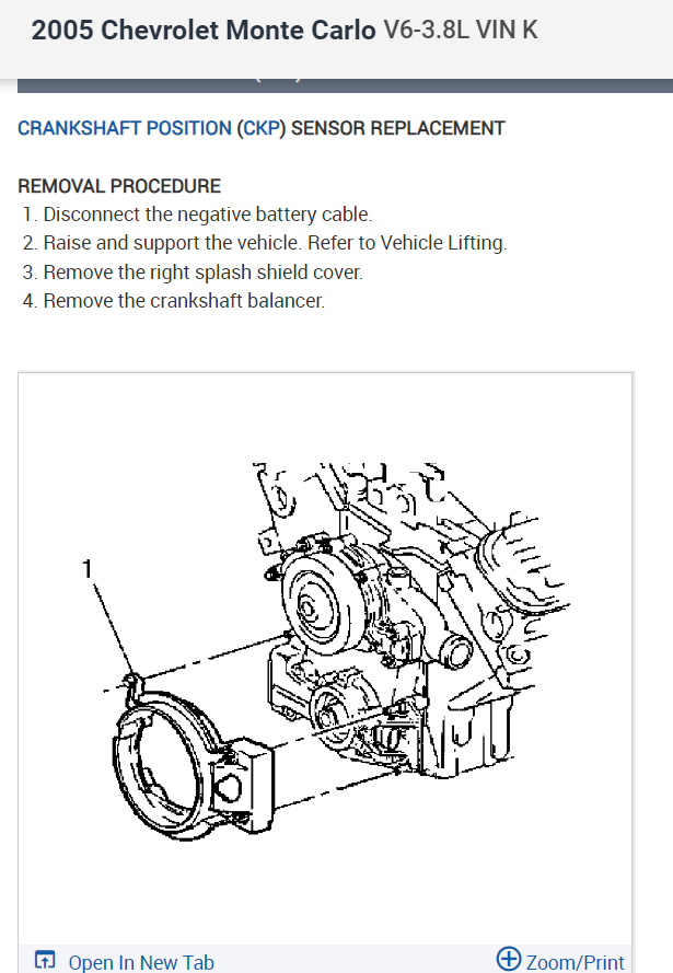

When it shuts down and will crank but not start, we need to check for spark because the crankshaft angle sensor can cause this problem. Please go over this video to help us find the problem:
https://youtu.be/lXLJbuAZ4CE?si=DJajZE5zfJX8mdL1
Here is the location of the crankshaft sensor so you can check it out. Check out the images (below). Let us know how it goes.

Has spark and injector pulse.

I replaced the fuel pump with a new one from the dealer and it ended up being bad would not hold pressure. So, I bought a Delphi from AutoZone and it’s good now. Chevy needs more fuel pressure to run. At 40 where it was at was no good now it’s around 50 psi and is running great. thanks for your time.
