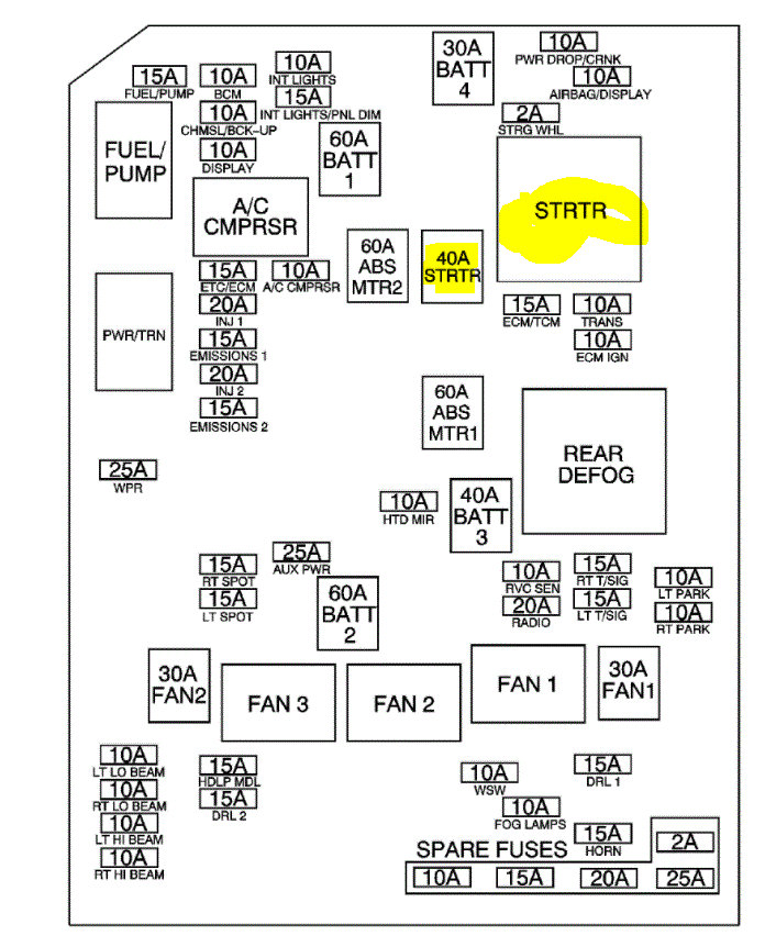

My car listed above won't even crank over. I had to have it towed to my house and now still it won't start. Help please.

Next, check the starter fuse and relay in the under hood fuse box. See pic below for locations. As far as the relay, if there is another one that has the same part number, switch them to see if it makes a difference. If there isn't here is a link that shows how to test a relay. Check the fuse as well. Make sure there is power both to and from it.

See pic below
