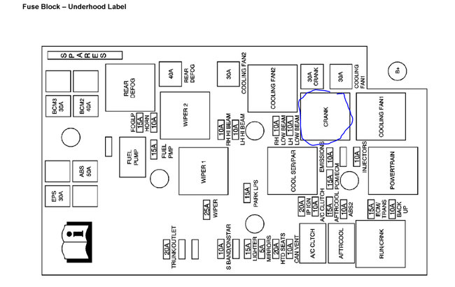

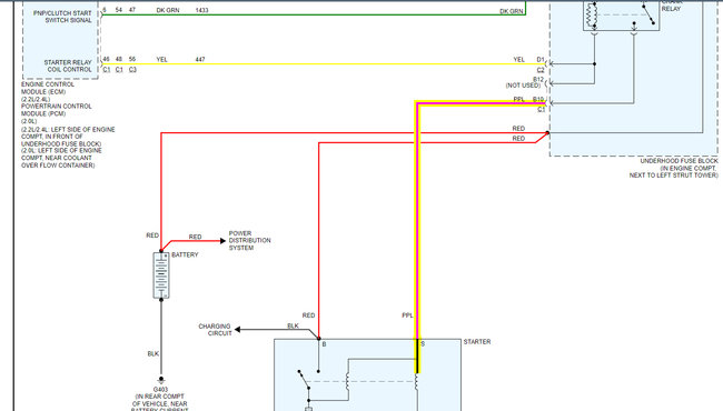

I disconnected the positive terminal on the battery to replace a starter on the car listed above (Ls sedan) and now won't start after reconnecting the positive terminal on the battery. so can you help me please?

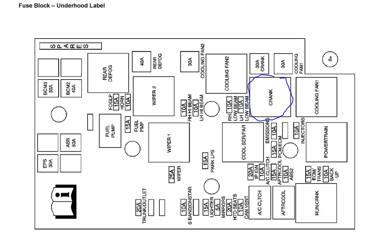

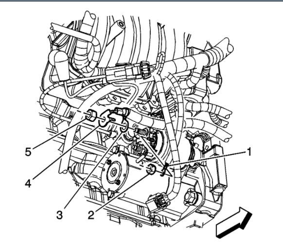

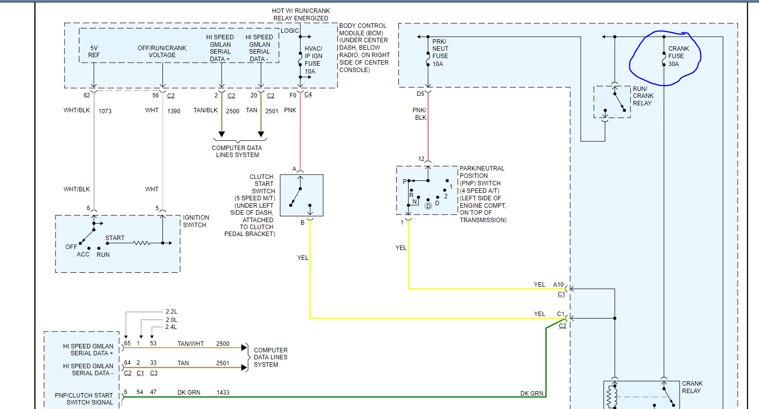

Also, it could be a bad starter motor itself even though it is a replacement. I attached a wiring diagram of the system for you as well. Check the small wire on the solenoid for power with the key in the start position.

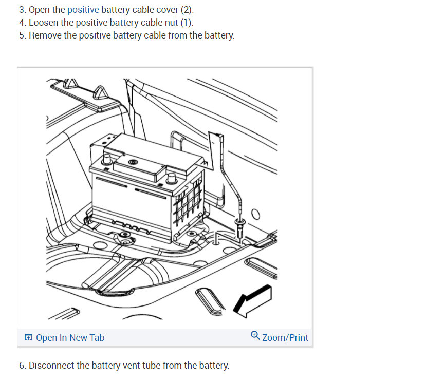

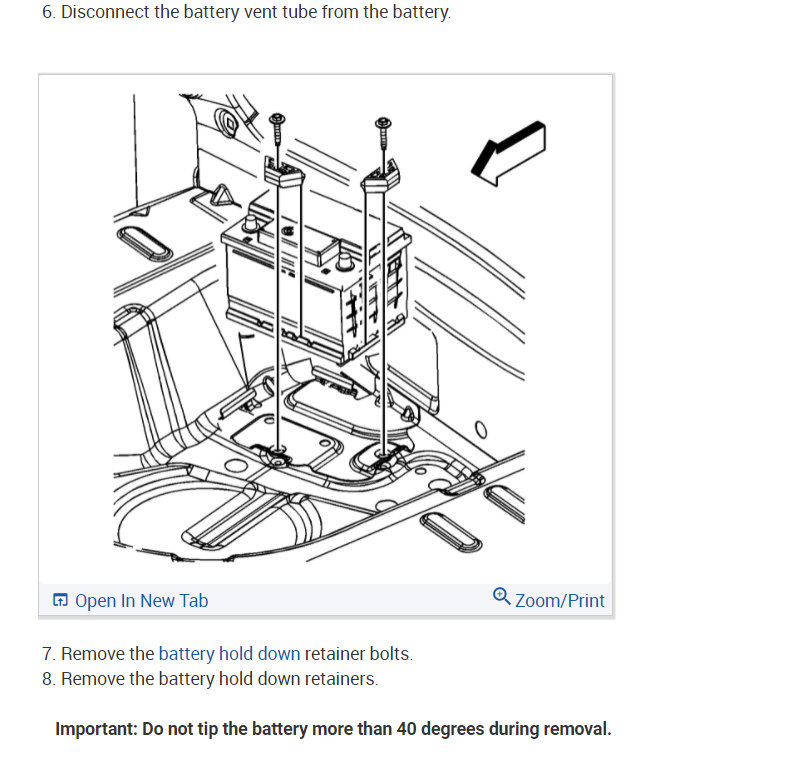

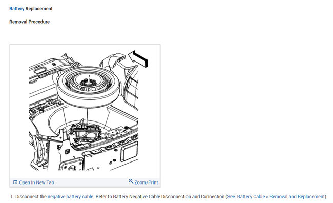

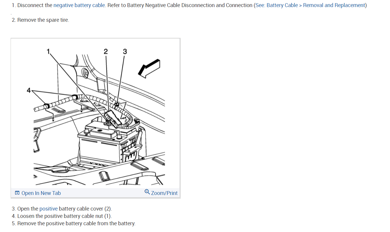

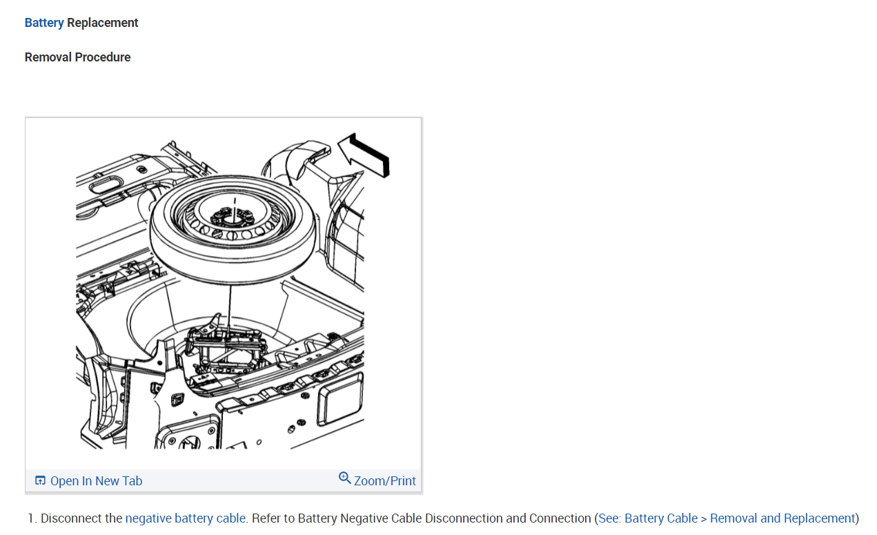

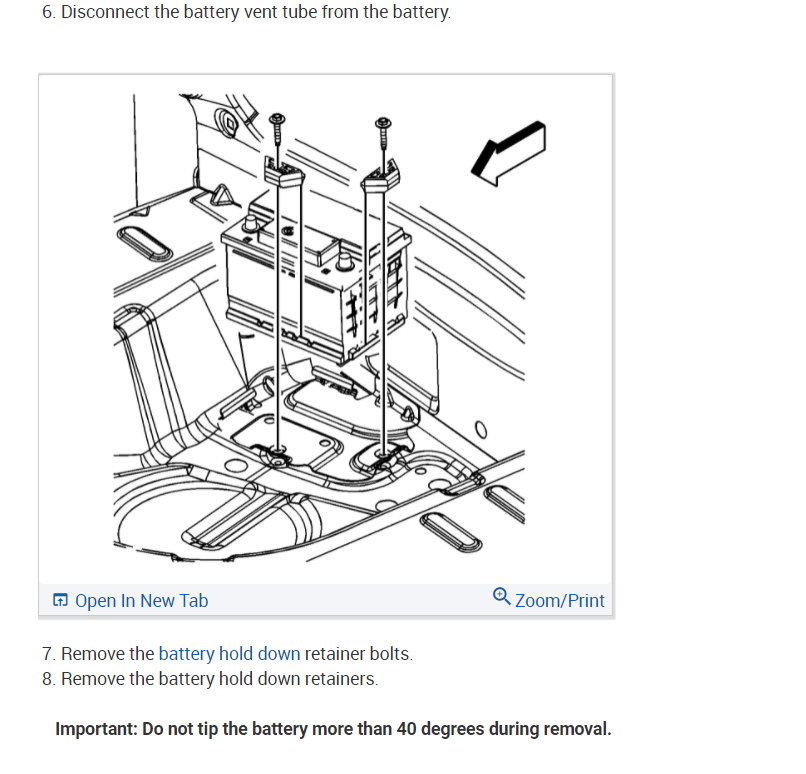

When I put a brand new battery in my car would I have to do anything else or should the car start right up?
Jun 6, 2021 at 2:52 AM
You may have to do the reset procedure for the security system. I attached that in my initial response.
https://www.2carpros.com/articles/how-to-replace-a-car-battery
I attached the procedure for replacing the battery. It is located in the trunk rather than under the hood.
Let us know if you have any other questions.

Okay, then check for power to the starter with the key in the start position. The little wire on the solenoid is the one that needs the power to activate the starter motor.
Check that wire for power.

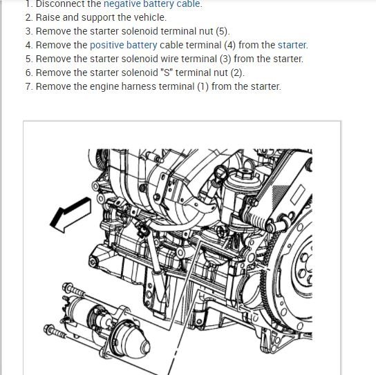

Did you check the voltage at the wire for the starter as I suggested? If you have power, the starter motor is the issue.
https://www.2carpros.com/articles/how-a-starter-and-solenoid-works
If you do not then we need to do some testing.
I attached the procedure for replacing the starter motor below for you.

I got my car listed above Ls sedan towed to a Chevrolet dealership so they could put on a new starter and new battery and when they tried to start my car nothing happen. so then they ran a diagnosis test to find the problem. It was a bad positive wire going to the starter and a bad ground wire going to the starter and now my car runs great.
