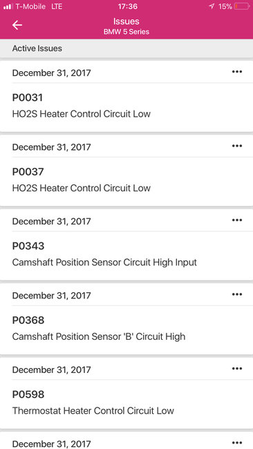

Car will not start
2014 BMW 535I
80,000 MILES • 3.5L • 6 CYL • TURBO • 4WD • AUTOMATIC
MFD229

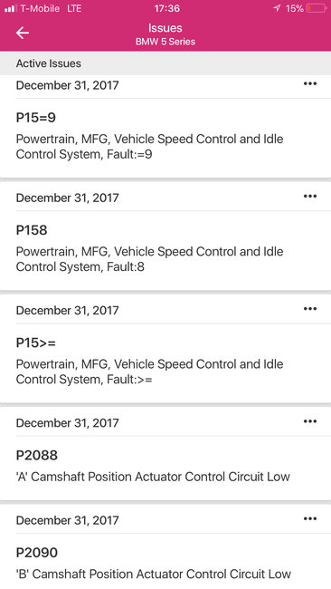

Drove the car home from work just fine. Fifteen minutes later, went to run an errand and my car would not turn over. Goes to start but turns off right away. No issues before this. Error codes I received are attached.
Dec 31, 2017 at 7:43 AM
MHPAUTOS
  • 31,937 POSTS
Start with clearing codes and doing a restart, will it run if you hold some throttle open on start? let me know what codes reset after a clear and restart test.
Dec 31, 2017 at 12:44 PM
MFD229
I have not cleared an codes yet, but about twenty minutes later it started up again with no issues. I will reset the codes when I get home.
Dec 31, 2017 at 1:15 PM
  • 55,399 POSTS
Too me it sounds like you have a low battery can you do a load test to see if it passes?
