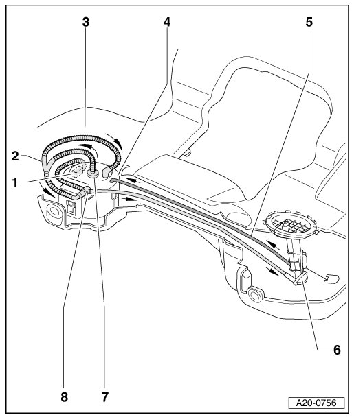

You do not specify which fuel pump has been removed and repaired/replaced. This 2.5 V6 diesel engine has 3 fuel pumps, 2 in tank and the main, high pressure, pump mounted on the engine.
Please see illustration below to show the in tank fuel pumps.
1 - Suction-jet pump (right-side)
2 - Y-connector
3 - Fuel supply pipe
4 - Baffle housing
5 - Fuel supply pipe
6 - Suction-jet pump (left-side)
7 - Fuel pump
8 - Connecting piece

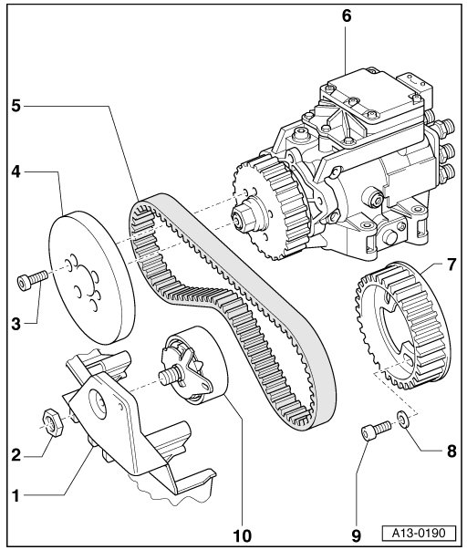

The in tank fuel pumps supply fuel to the high pressure pump at the engine. If this pump was removed then it is vital to ensure correct timing of the toothed belt. See illustration below .

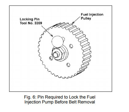

The drive sprocket for the injection pump needs to be locked in place by a special tool.
See 3rd and 4th illustration below.

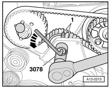

It sounds like the pump timing is not correct
Please see the below link on how to set up the timing.
https://www.techtips.ie/Contitech/audi-a4-25-v6-tdi-ake-timing-belt-guide.pdf

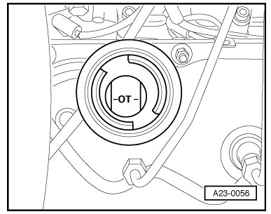

Ensure that the engine is set on TDC before you check the injection pump timing.
Then insert the locking pin on the injection pump, see image below.
The PDF has some good images relating to TDC marks and special tools needed.
Please let us know how you get along.
Cheers, Boris
