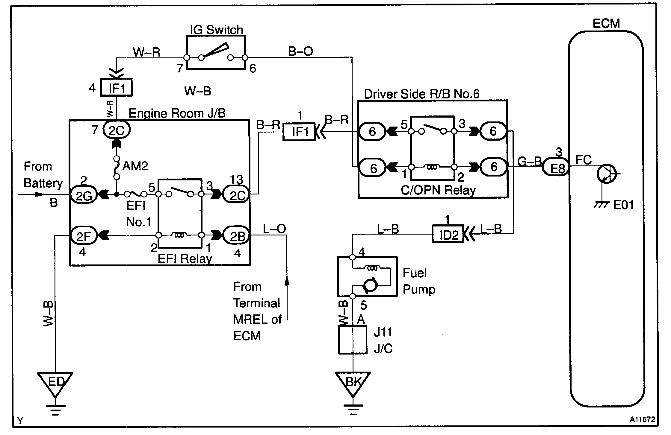

Change spark plugs on car checked and changed the oil, car ran fine. next morning turned on for two minutes turned off turn back on. checked relays from fuse box all were good. low-voltage to your pump.

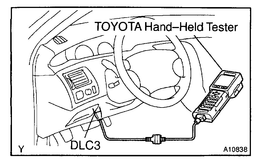

1. CHECK FUEL PUMP OPERATION
Picture 1

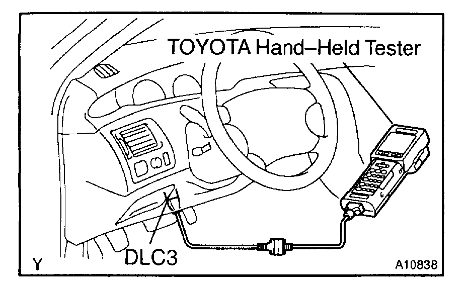

a. Connect a TOYOTA hand-held tester to the DLC3.
b. Turn the ignition switch ON and TOYOTA hand-held tester main switch ON.
NOTE: Do not start the engine.
c. Select the active test mode on the TOYOTA hand-held tester.
d. Please refer to the TOYOTA hand-held tester operator's manual for further details.
e. If you have no TOYOTA hand-held tester, connect the positive (+) and negative (-) leads from the battery to the fuel pump connector (See step 7).
Picture 2
f. Check that there is pressure in the fuel inlet hose from the fuel filter.
HINT: If there is fuel pressure, you will hear the sound of fuel flowing.

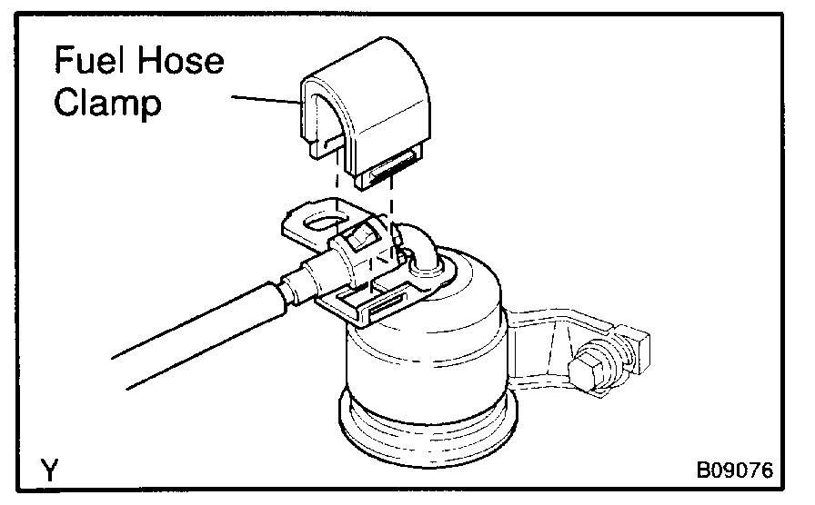

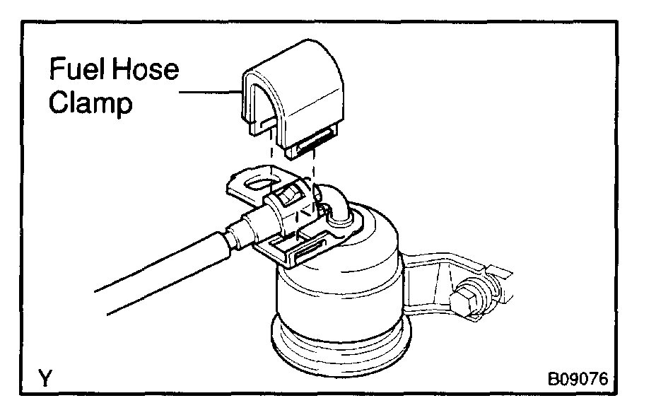

Picture 3
2. CHECK FUEL PRESSURE
a. Check the battery positive voltage is above 12 V.
b. Disconnect the negative (-) terminal cable from the battery.

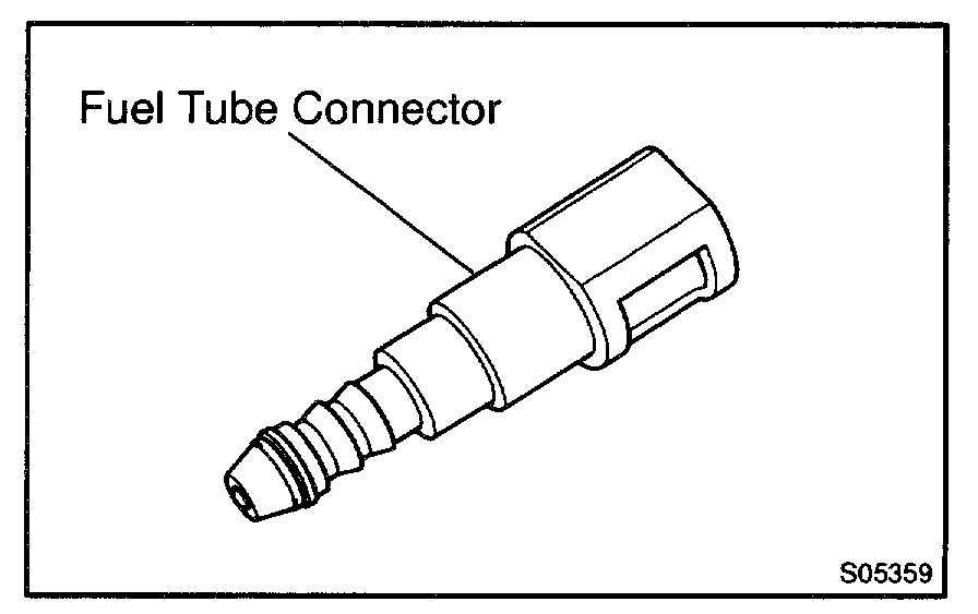

c. Purchase the new No.1 fuel pipe and take out the fuel tube connector from its pipe.
Part No. 23801-20070
Picture 4

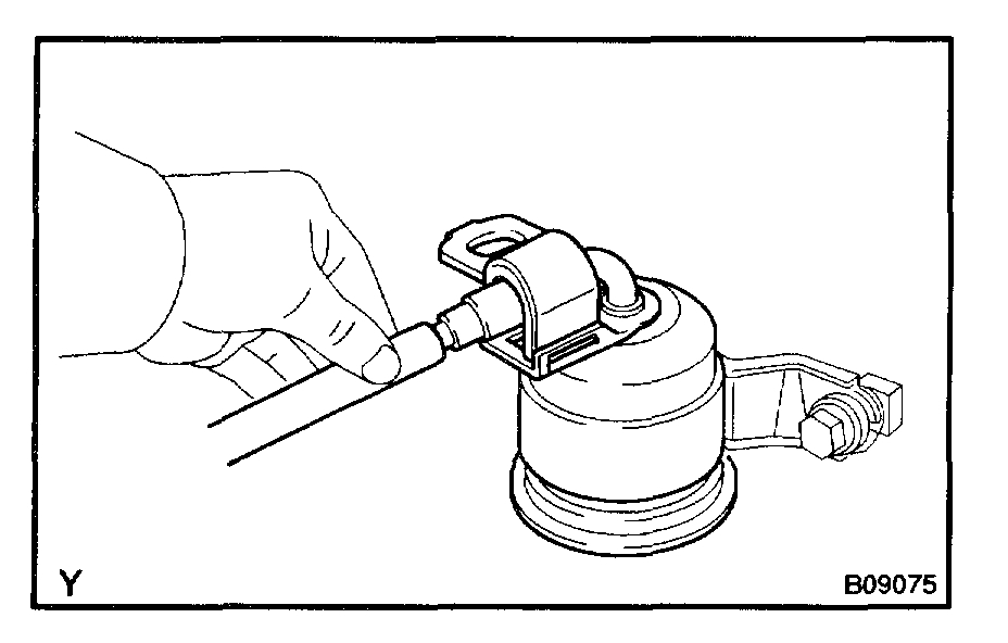

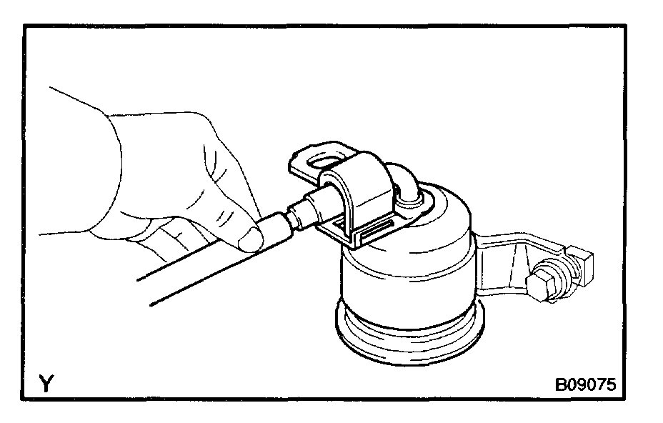

d. Remove the fuel hose clamp.
Picture 5

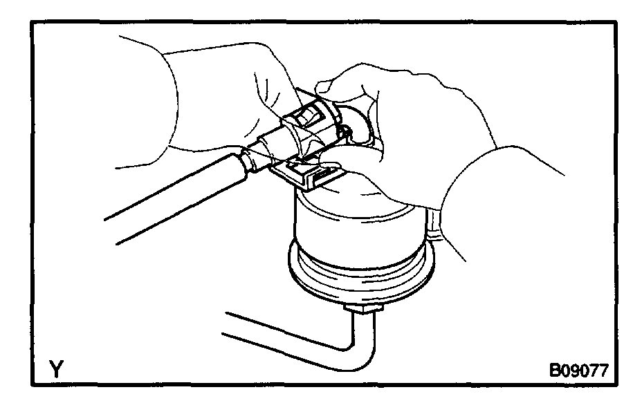

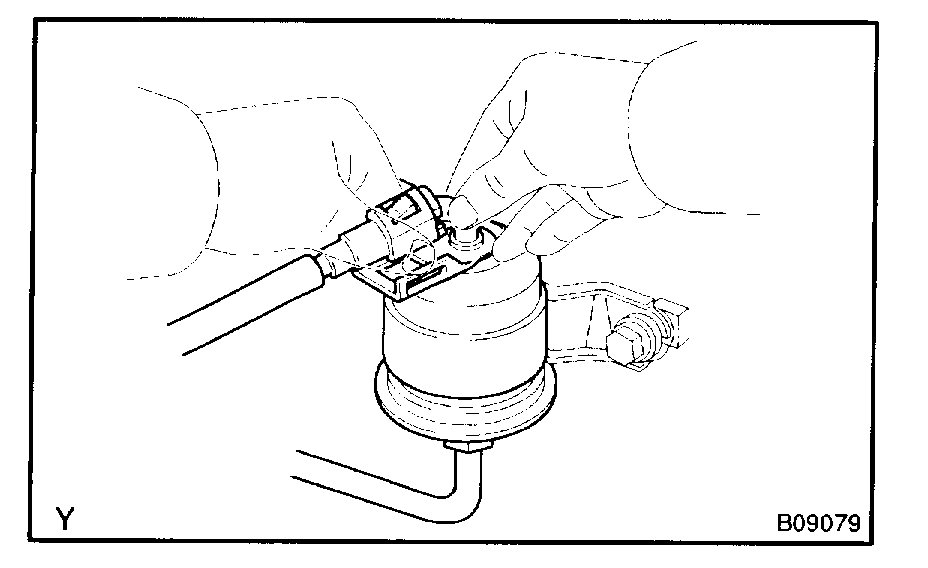

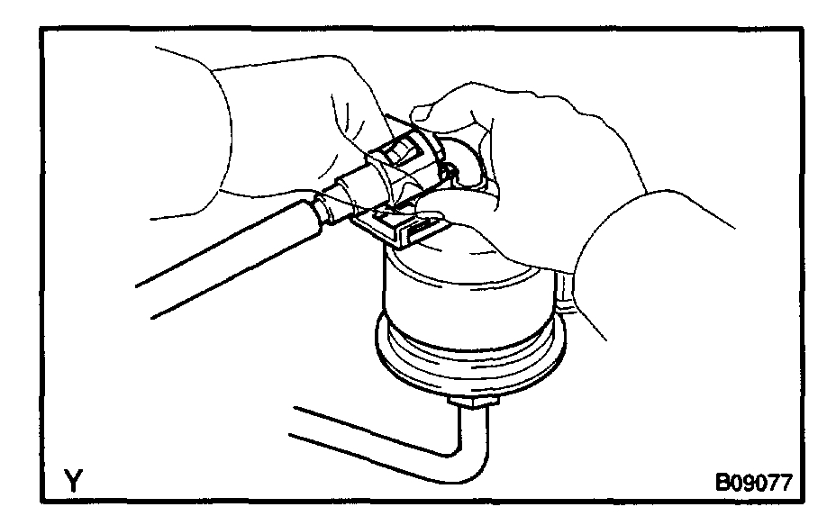

e. Disconnect the No.1 fuel pipe (fuel tube connector) from the fuel filter outlet.
CAUTION:
- Perform disconnecting operations of the fuel tube connector (quick type) after observing the precautions.
- As there is retained pressure in the fuel pipe line, prevent It from splashing Inside the engine compartment.

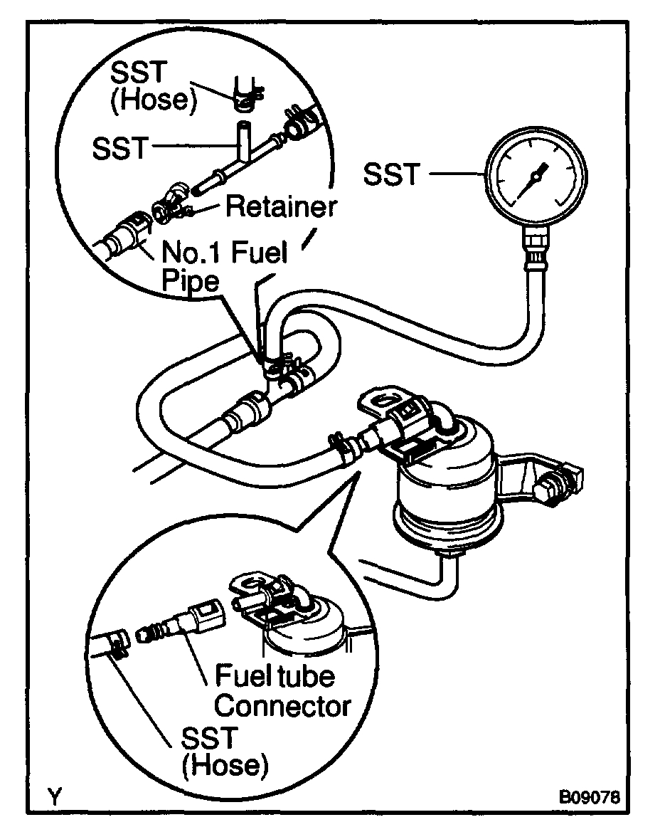

Picture 6
f. Install SST (pressure gauge) as shown in the illustration by using SST and fuel tube connector.
SST 09268-41047, 09268-45014
g. Wipe off any splattered gasoline.
h. Reconnect the TOYOTA hand-held tester to the DLC3 (See step 1).

r. Surely install the hose clamp to the fuel filter with "click" sound.
s. After installing the clamp, check that the clamp is fixed by pulling up to the clamp.

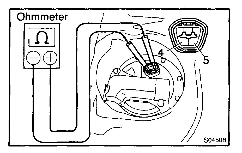

6. INSPECT FUEL PUMP RESISTANCE
Using an ohmmeter, measure the resistance between terminals 4 and 5.
Resistance: 0.2 - 3.0 ohm at 20 °C (68 °F)
If the resistance is not as specified, replace the fuel pump.

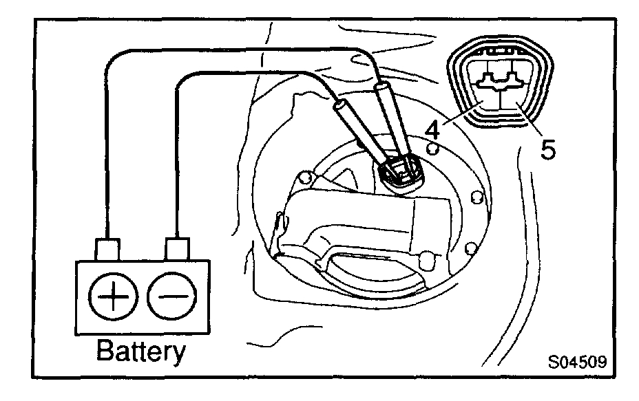

7. INSPECT FUEL PUMP OPERATION
Connect the positive (+) lead from the battery to terminal 4 of the connector, and the negative (-) lead to terminal 5. Check that the fuel pump operates.
NOTE:
- These tests must be done quickly (within 10 seconds) to prevent the coil burning out.
- Keep the fuel pump as far away from the battery as possible.
- Always do the switching at the battery side.
If operation is not as specified, replace the fuel pump or lead wire.

Hi, thank you for your response. the car was running fine. I changed the plugs and oil. Ran the car for about twenty minutes turned off. rechecked the oil level turn car back on ran fine. The next morning turned on ran for about two minutes shut off. car turns on with help of fuel starter but shuts off. changed fuel pump and fuel filter. EFI relays are good found three. don't have good voltage at pump does not turn on.
Jan 30, 2019 at 12:29 PM
LIDO1970
  • 5 POSTS
Hi thank you. For yourself response. I have replaced fuel pump and filter and still nothing
Jan 31, 2019 at 10:47 AM
LIDO1970
  • 5 POSTS
Got low voltage at connector to pump check relays 2 in fuse box and the on the side of drivers side kick panel

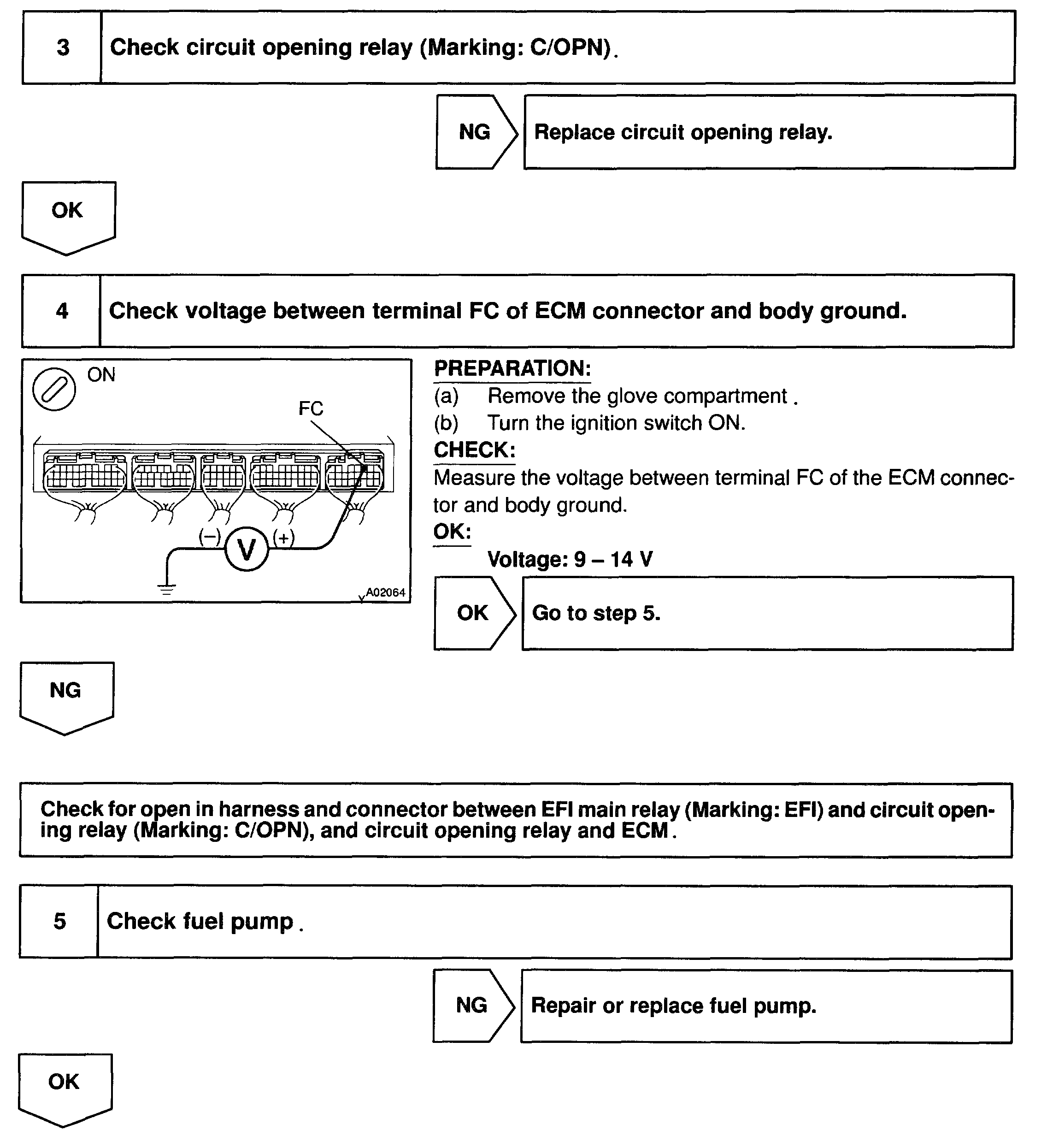

Hi and welcome back:
Here is the diagnostic flow chart for locating the problem. All attached pictures correlate with these directions. Several of the pictures are the actual flow chart.
______________________________________________

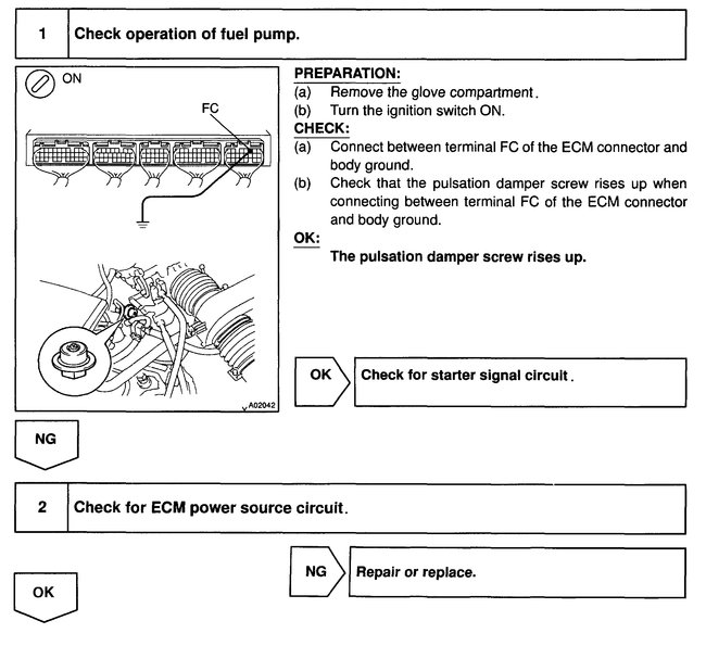

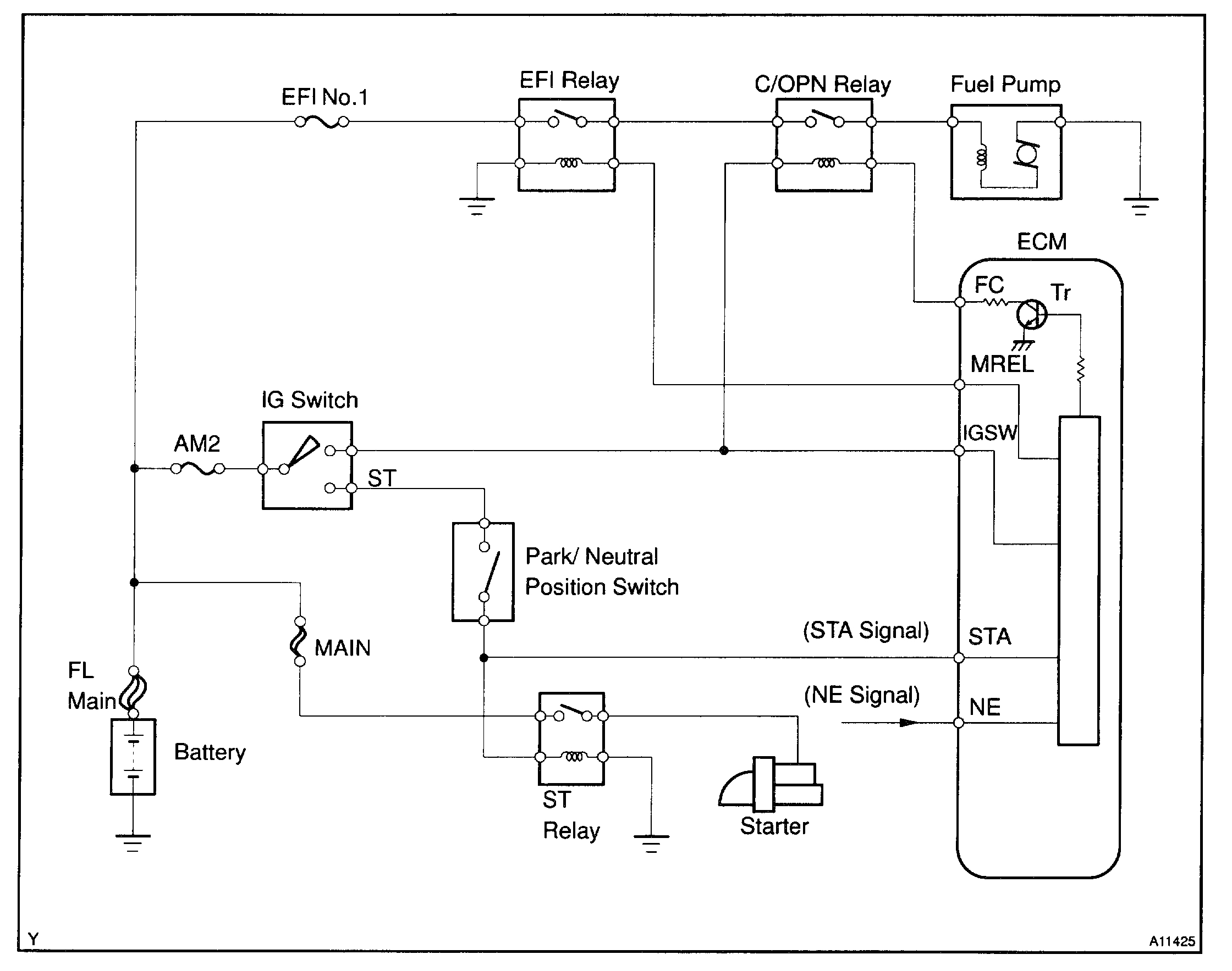

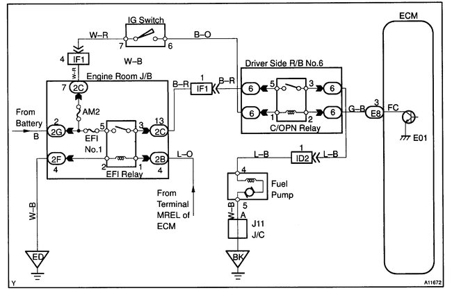

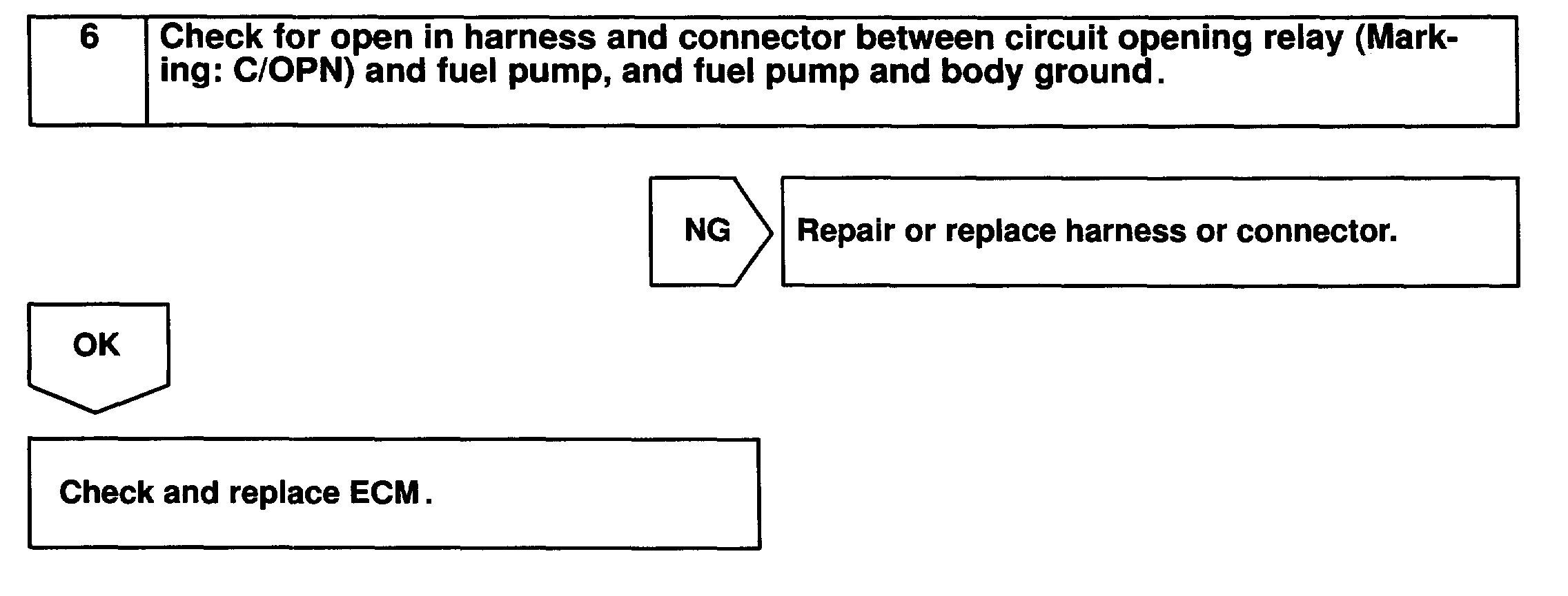

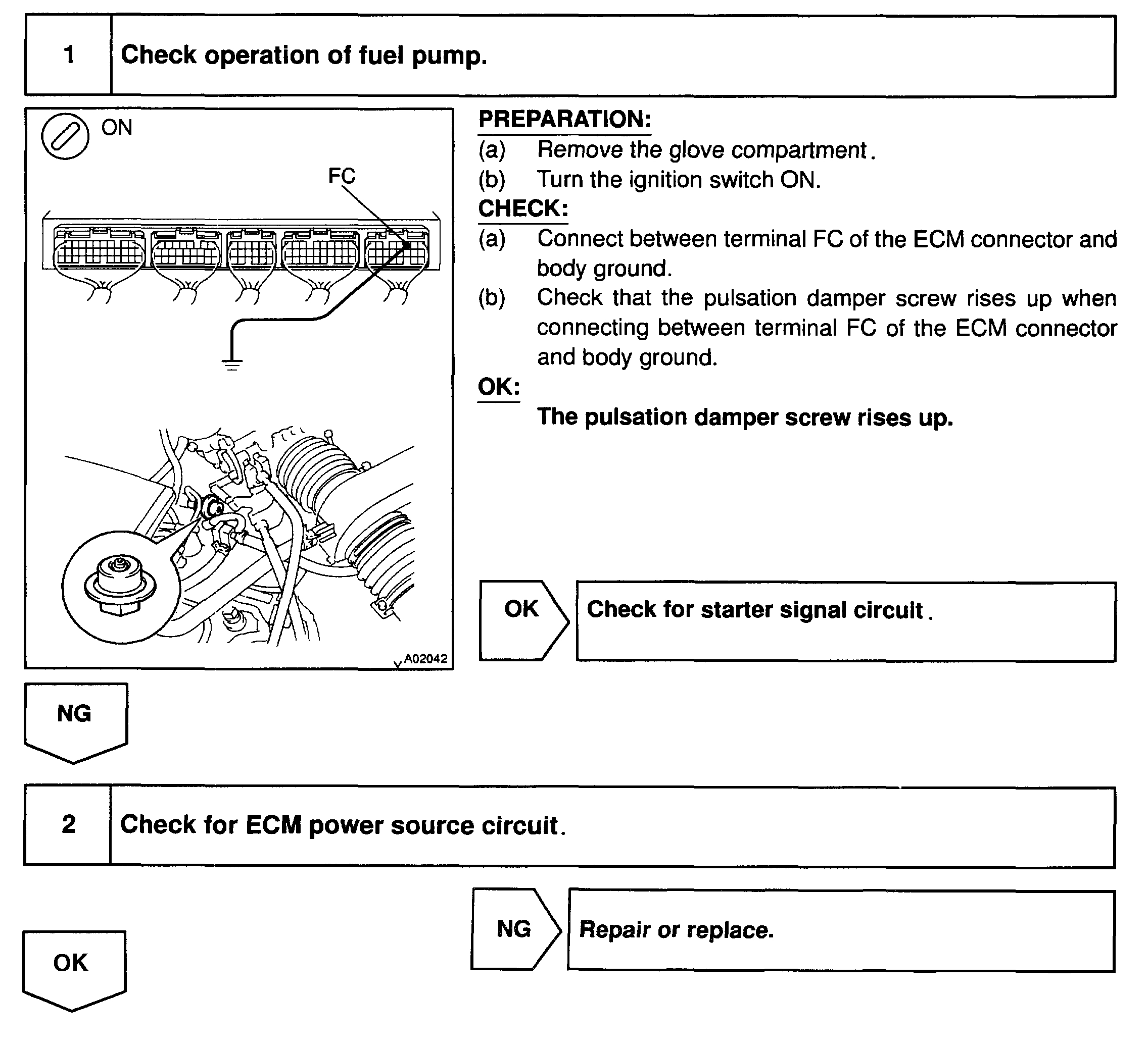

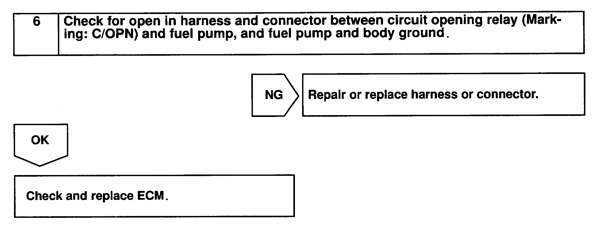

FUEL PUMP CONTROL CIRCUIT
CIRCUIT DESCRIPTION
Picture 1
In the diagram , when the engine is cranked, current flows from terminal ST of the ignition switch to the starter relay (Marking: ST) coil and also current flows to terminal STA of ECM (STA signal). When the STA signal and NE signal are input to the ECM, Tr is turned ON, current flows to coil of the circuit opening relay (Marking: C/OPN), the relay switches on, power is supplied to the fuel pump and the fuel pump operates.
While the NE signal is generated (engine running), the ECM keeps Tr ON (circuit opening relay ON) and the fuel pump also keeps operating.
Wiring Diagram
Pic 2

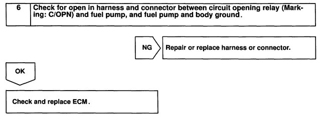

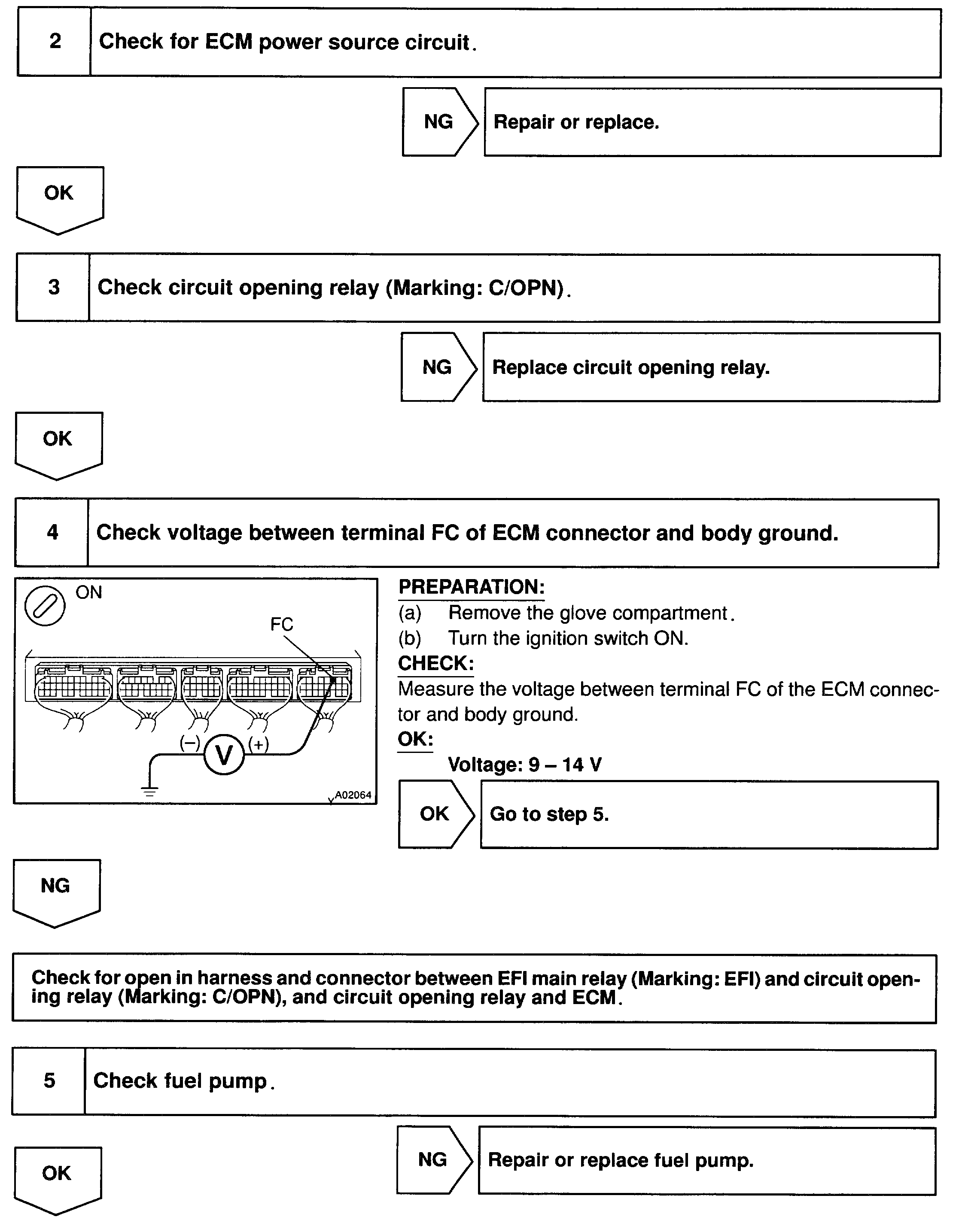

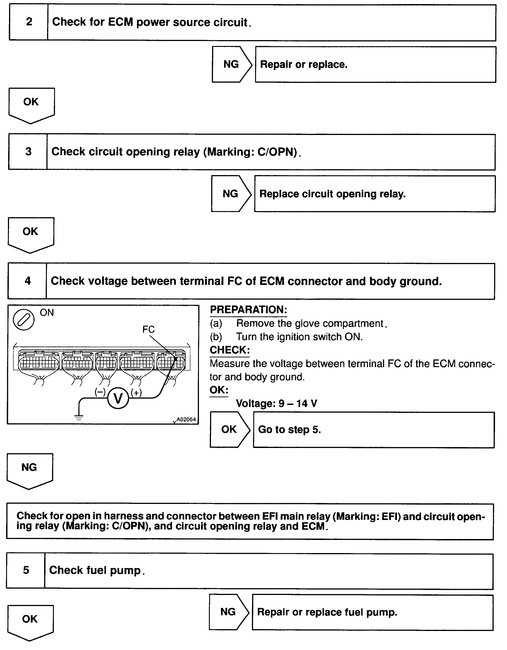

INSPECTION PROCEDURE
Step 1
Picture 3
Steps 2 - 5
Picture 4

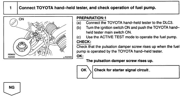

Step 6
Picture 5
TOYOTA hand-held tester:
Steps 1 - 2
Picture 6
Steps 3 - 5
Pic 7
Step 6
Picture 8
