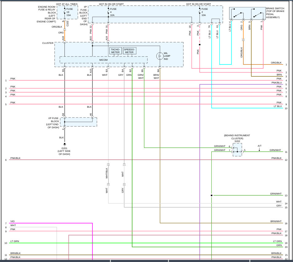

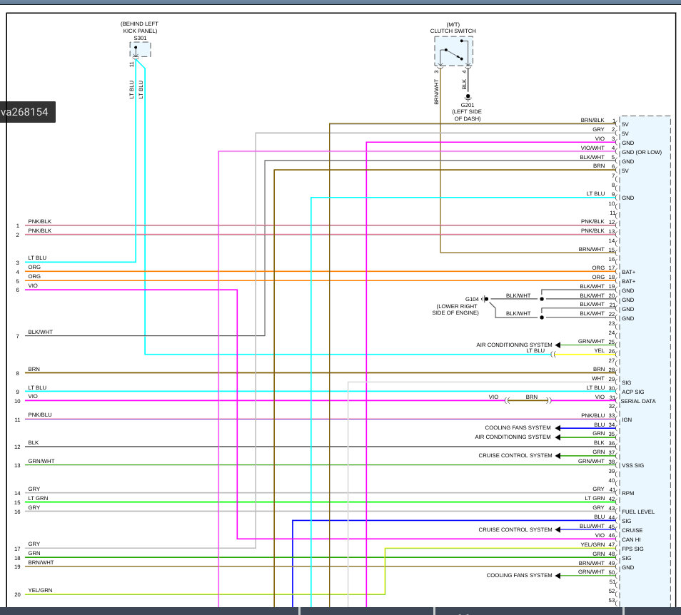

Checked voltage at the pump and has only 5 volts. Checked fuses and replaced relay. Cannot find why there is only 5 volts at fuel pump connector.
Jan 3, 2020 at 8:08 AM
SCGRANTURISMO
  • 4,897 POSTS

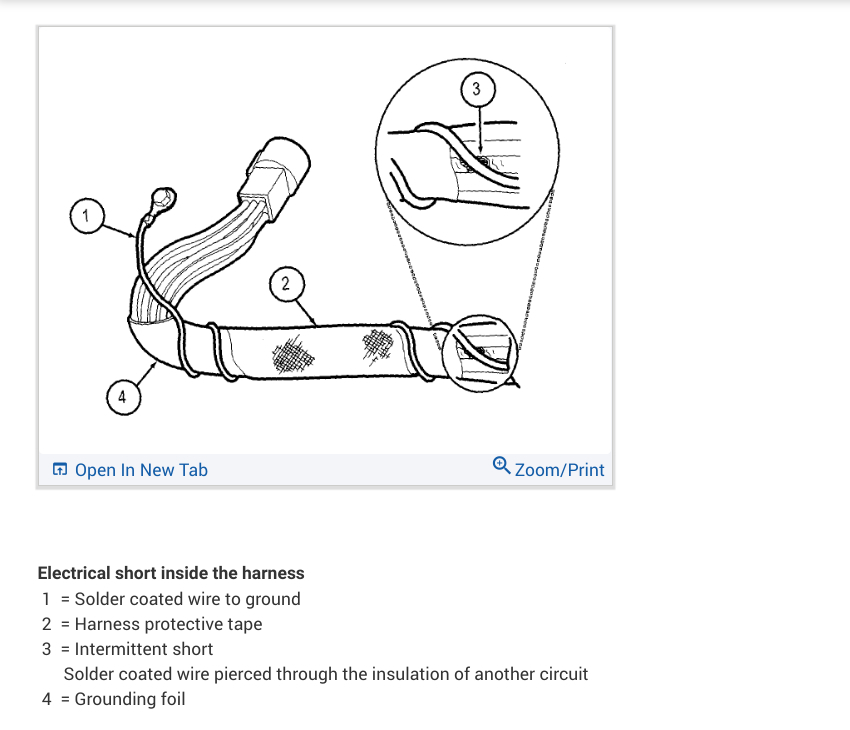

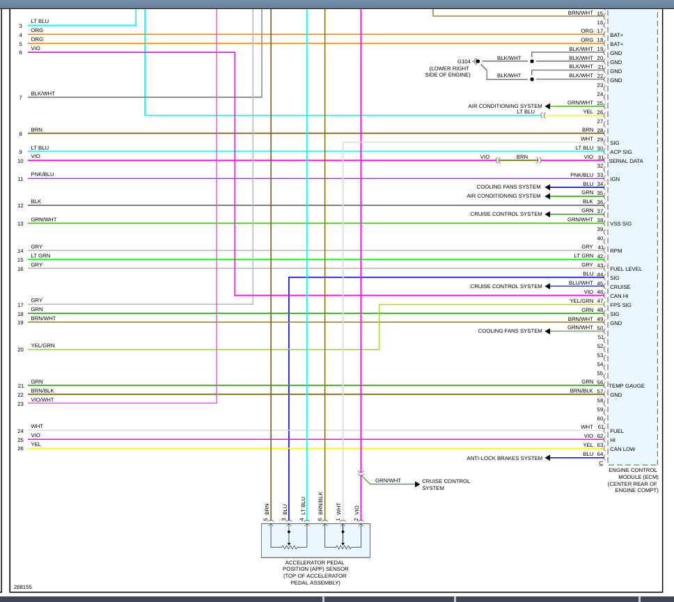

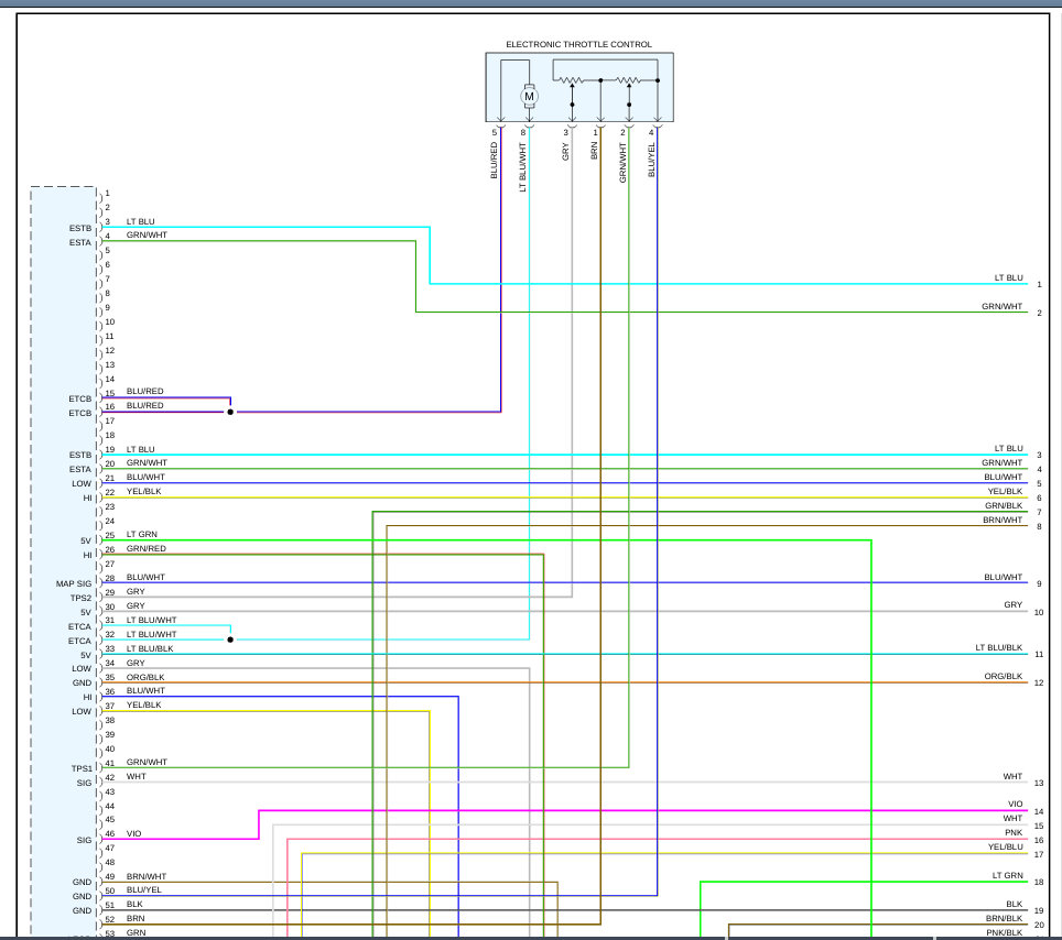

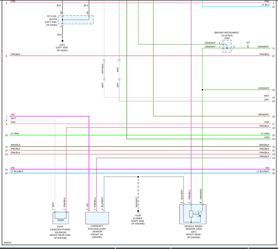

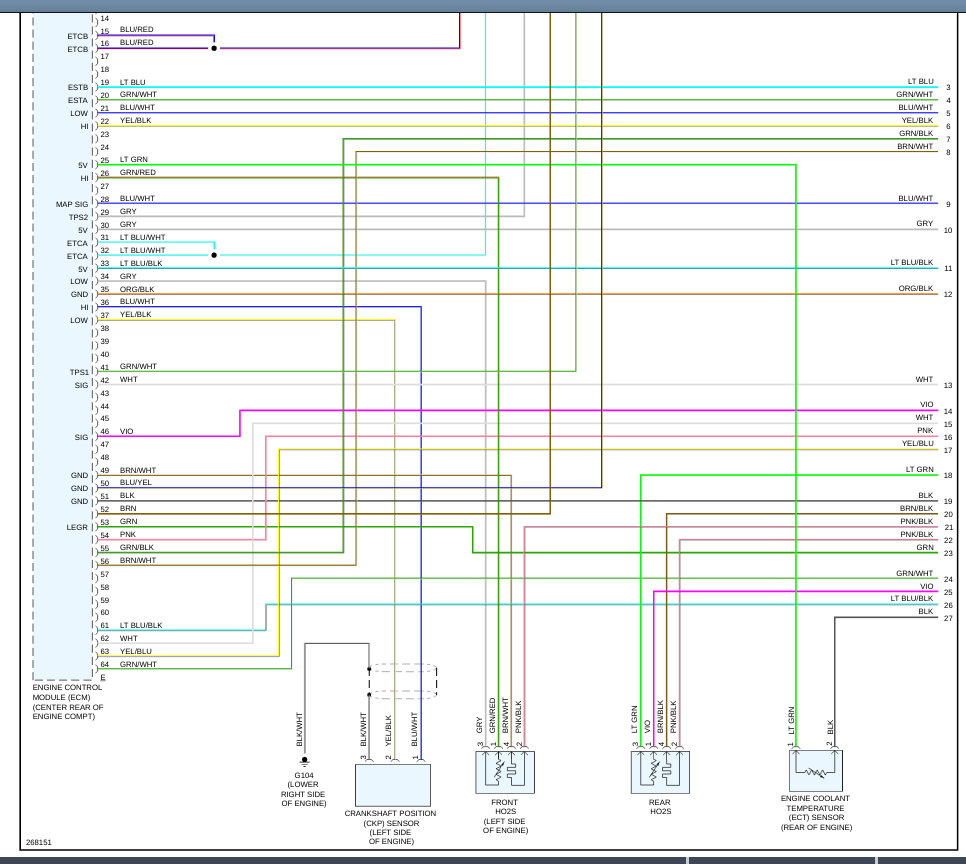

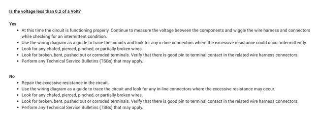

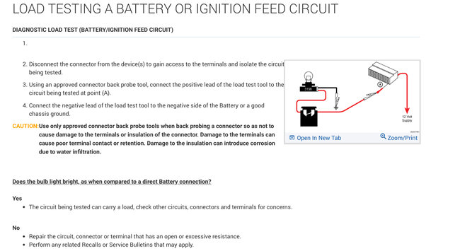

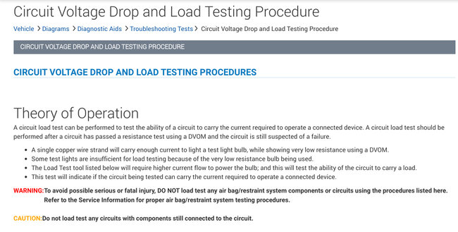

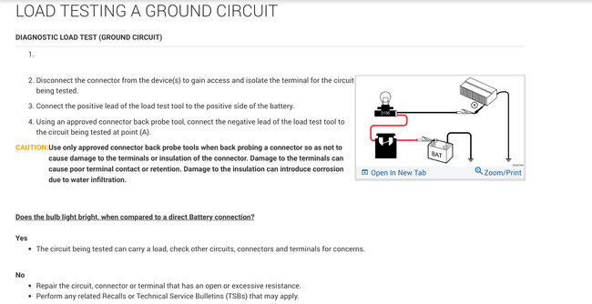

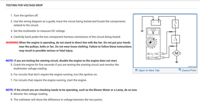

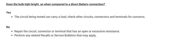

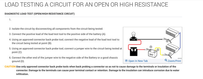

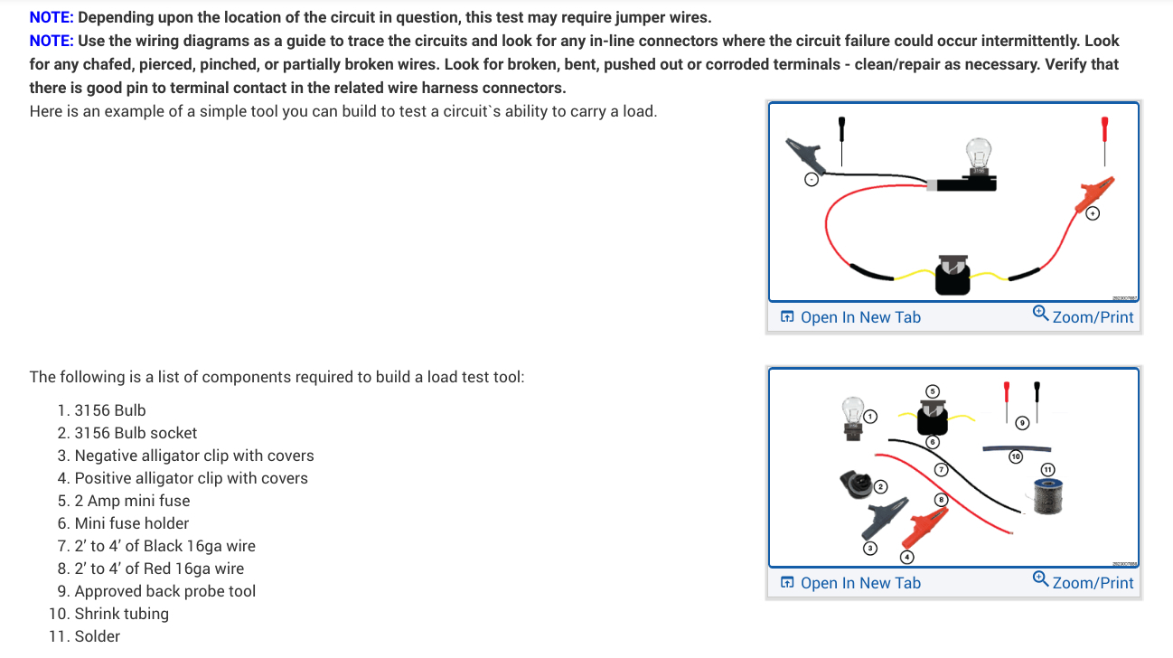

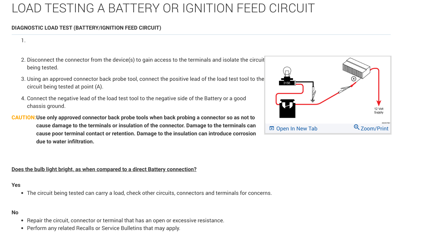

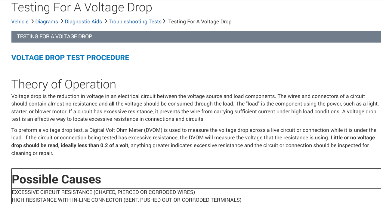

This sounds like you have some unwanted resistance in your vehicle's fuel pump circuit. In the diagrams down below I have included the engine management wiring diagrams for your vehicle including the fuel pump circuit which I high lighted for you and guides on how to find unwanted resistance using the voltage drop method. Please go through these guides and get back to us with what you are able to find out.

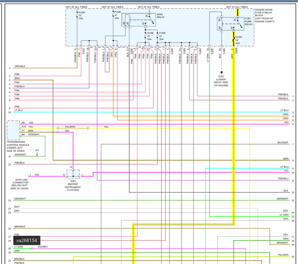

after checking the diagrams you provided it seems I was checking voltage at the wrong wires. I have checked voltage at gray and black wires and I have 0 volts. There is also 0 volts at the fuse with key on and also while cranking engine. There is no initial prime of fuel pump either. Seems I am not getting signal to relay from ECM. Would it be a faulty ECM? or is there anything else I can check before replacing ECM? also would this ECM need to be programmed by dealership or could I just pick one up at a junk yard? Thanks in advance, this has been of great help.
Jan 3, 2020 at 9:16 PM
SCGRANTURISMO
  • 4,897 POSTS
Hello again,

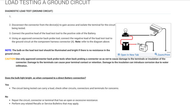

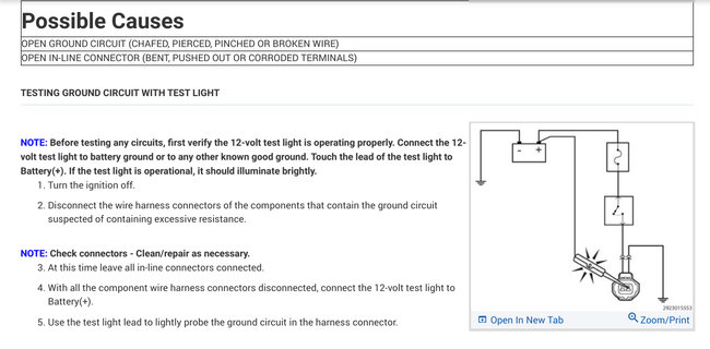

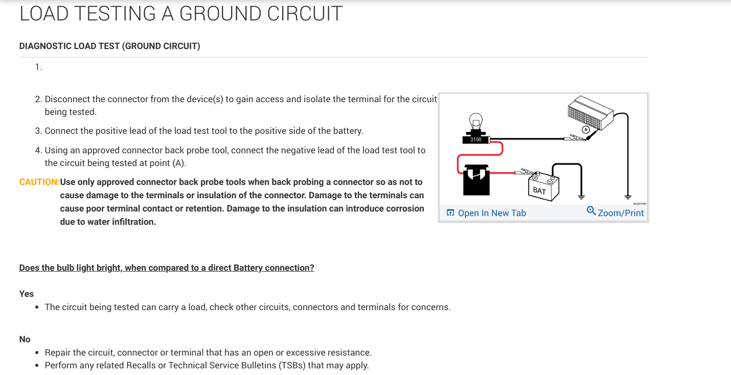

Check Ground 107, on the lower right side of the engine. Make sure that it is clean, corrosion free, tight, and making good metal to metal contact. Please get back to us with what you find out, and we can go from there, if necessary.

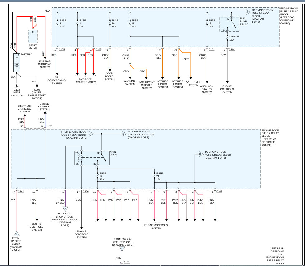

Okay, so I would recommend replacing the fuel pump relay. Please get back to us with how everything turns out, and we can go from there, if needed. Here is a link below explaining how to do that, if needed:

Hello again,

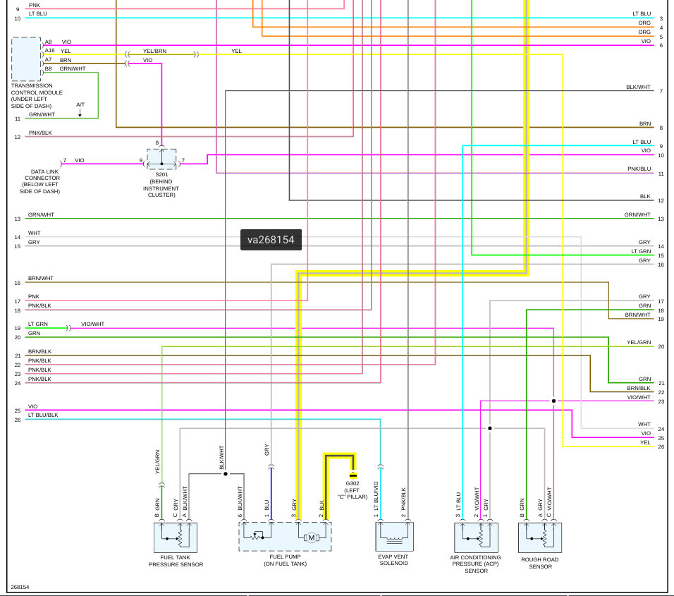

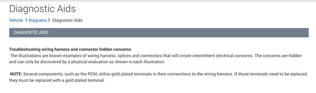

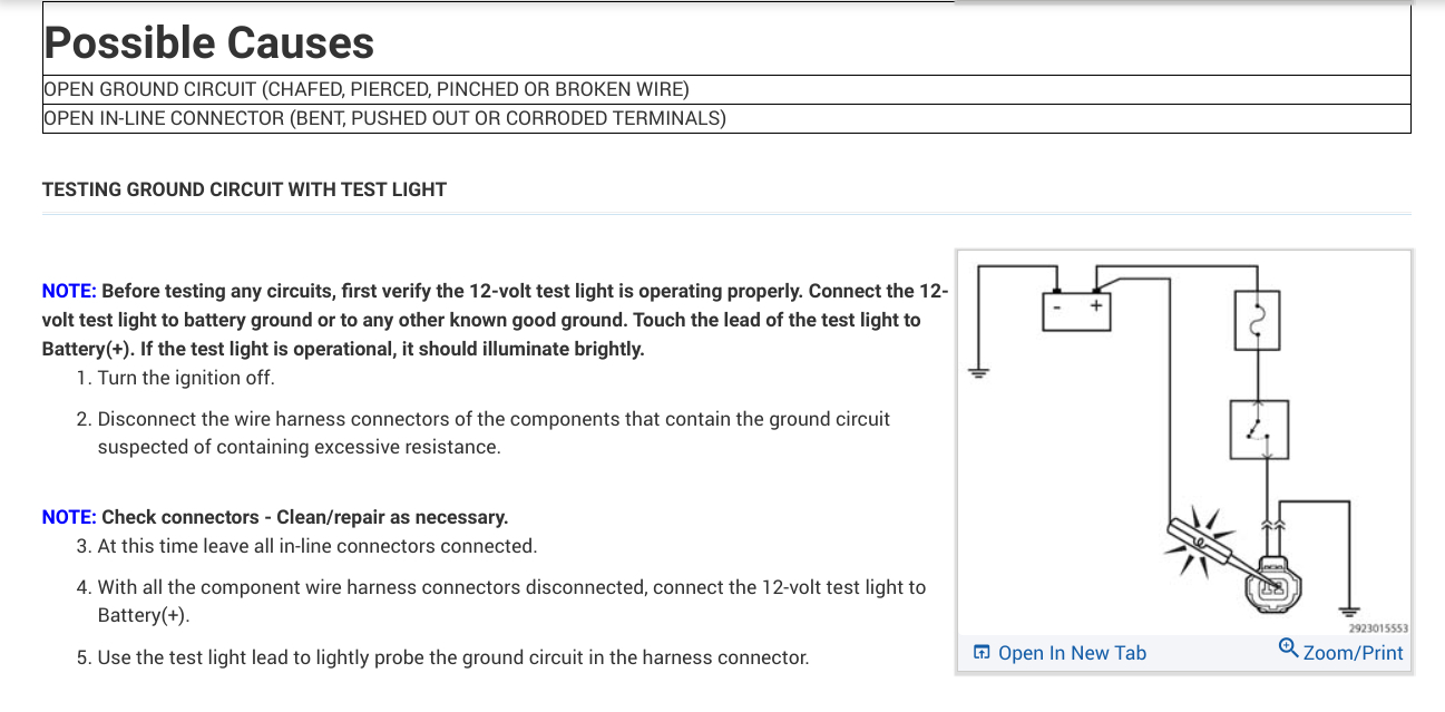

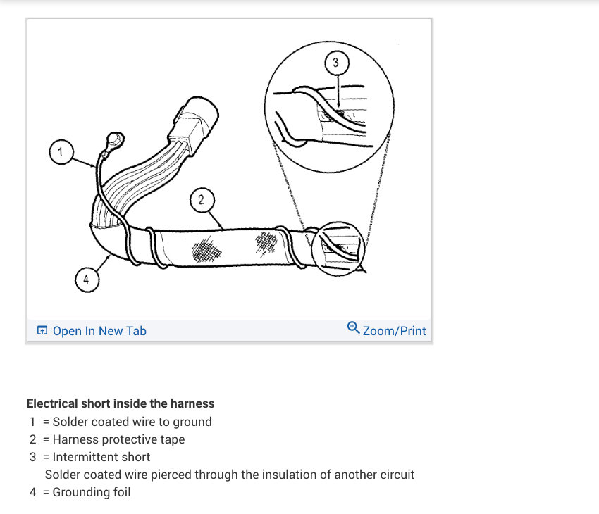

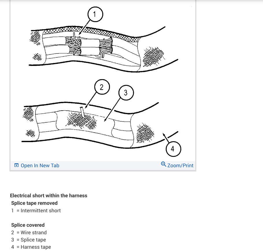

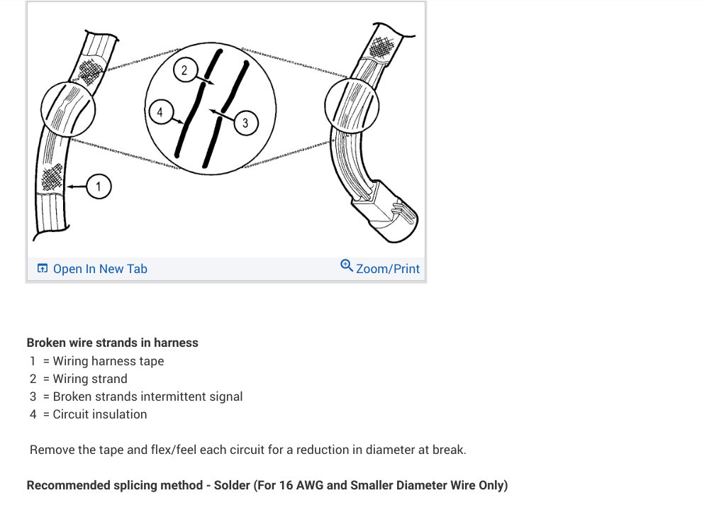

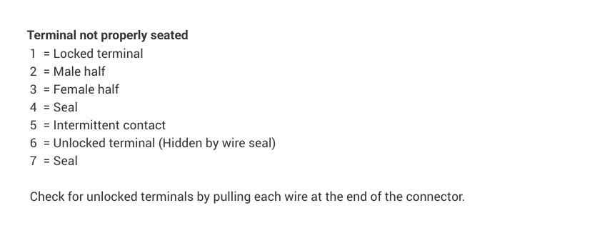

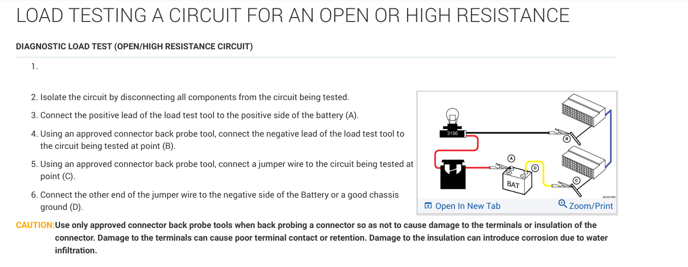

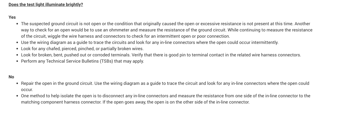

Let's make sure that there isn't an open in the light green wire that goes from pin 43 of the Engine Control Module9ECM] to pin 10 of connector 106, which connects to the engine room fuse and relay block. This is the wire that provides power to the coil of the fuel pump relay. In the diagrams down below I have included a guide on how to find intermittent electrical connections and a guide on how to find opens in an automotive electrical circuit for you. Please go through these guides and check the light green wire. If there isn't anything wrong with this wire, then, we can say the ECM has a bad driver and go from there. Please let us know.

Maybe it’s worth mentioning but I went ahead and jumped pins 30 & 87 at the relay. That gave me 12 volts at the fuse but not at the fuel pump connector.
Jan 5, 2020 at 6:44 AM
SCGRANTURISMO
  • 4,897 POSTS
Hello again,

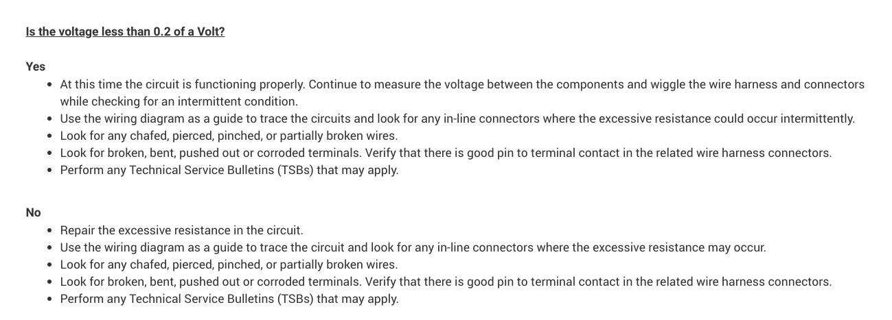

Okay, so the problem is an open in the light green wire or the fuel pump electrical connector. Just using the DMM and having it set to Ohm's is not a good way to test to see if the wire is good. I have sent you a guide on using voltage drop earlier and it is a much better method for this. If even one strand of wire is intact it will give you a continuity reading, but in reality, there is no way for any amount of amperage to pass through this one strand of wire. A voltage drop test will show this bad spot of wire though. That is why it is the preferred method to show unwanted resistance and how I would recommend testing the light green wire. Please get back to us with how everything turns out.
