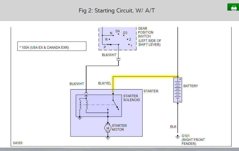

When trying to start the car it just does a click click click sound. I have replaced the starter, battery and negative battery cable. It still only does the click click click when trying to start it.

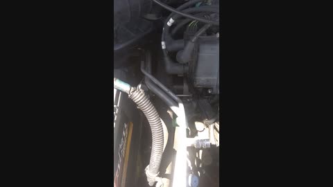

This is the sound it's making when trying to start it.

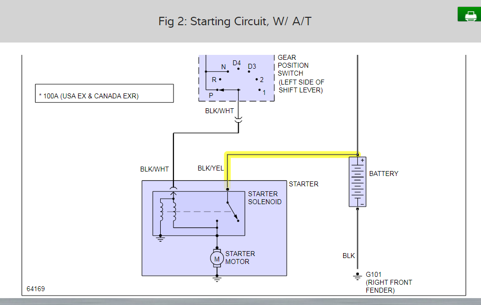

Can you please take a voltage reading for me at the starter solenoid of the black wire with a yellow stripe? I have included a wiring diagram of your starting system with the wire hilited, Please get back to us with what you find out.
Thanks,
Alex
