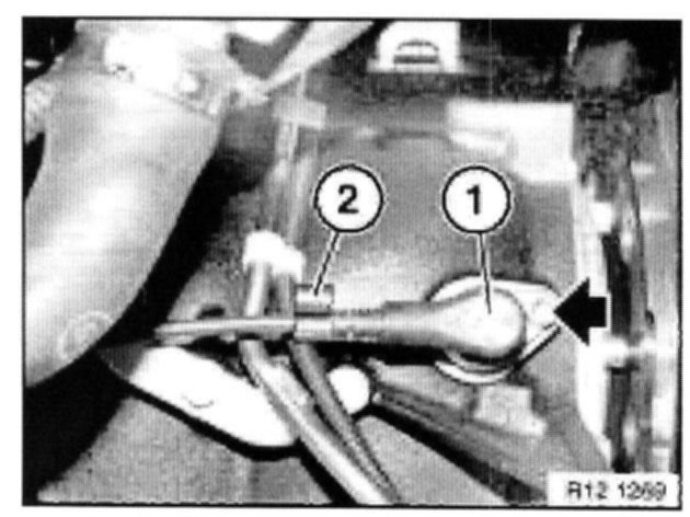

The car will not start and the entire dashboard lights up. The battery is fine. I was having difficulty with the convertible top function and the dashboard started blinking. I got the car home and now it will not start at all.
Aug 5, 2017 at 2:15 AM
  • 55,224 POSTS

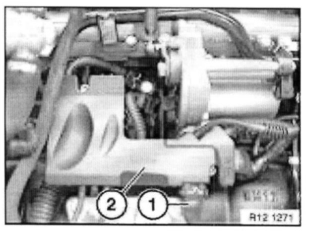

It sounds like you have a crankshaft angle sensor that has gone out. Here are a couple of guides to help you get the problem fixed:
and
Here are some diagrams of what it will be like on your car. (below)
Please let us know what happens, we are interested to see what it is.
