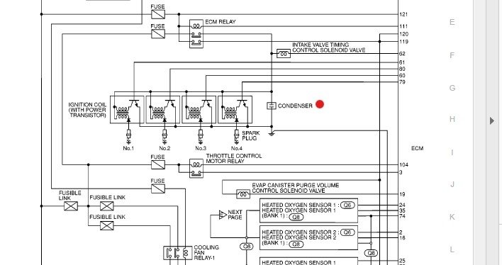

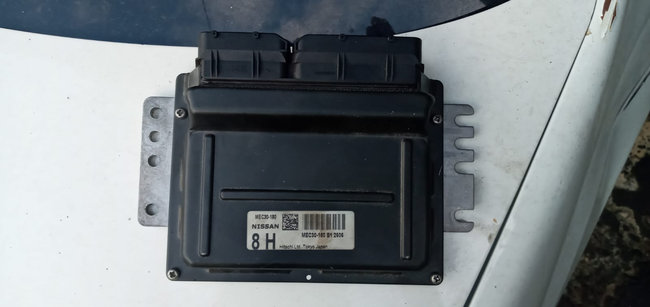

They say that the problem seems to be the ECU, but the thing is that the Computer does not appear anywhere. I can't find the exact part MEC30-180 B1 2606.
I used a ODBII scanner and showed error p0335, i took out the Crankshaft Sensor and wen to a place where they test it and it seems to be okay.
I bough a small oscilloscope and "tested" the crank and camshaft signal which I think seems to me there...
When I decided to take the car out of the repair shop, they said the card started again. then failed to start again. After a few days with the battery disconnected, the car started again at home few days after being unused, but just for a few minutes. I though it was something resetting, but I have tried to do the trick again but since that moment it haven't star ever again.
I wish to find the real problem... The car have a sentimental value for me, I don't really want to say the reason in this public forum, but... I wish to be able to start it again....
A friend of mine helped me the other day, he found out that in the coil there was ground and the positive, but something weird was that the signal pin had also 12 volts + I don't think that is okay.. What can make 12v+ present in the signal pin?
I have the manual too. It refer to disconnect the condenser hardness
1. Turn ignition switch “off”.
2. Disconnect condenser harness connector.
3. Turn ignition switch “on”.
4. Check voltage between condenser.
But I haven't found the named condenser.

The idea that the crank sensor tested good but there is no spark makes me thing there is a wiring issue. I don't have a schematic to look through exactly how this system works. As far as the 12v, that could be normal. The igniter may fire when the PCM opens a ground path for it. Have you checked all wiring at the crankshaft position sensor of corrosion, damage, or anything that is doesn't seem normal?
