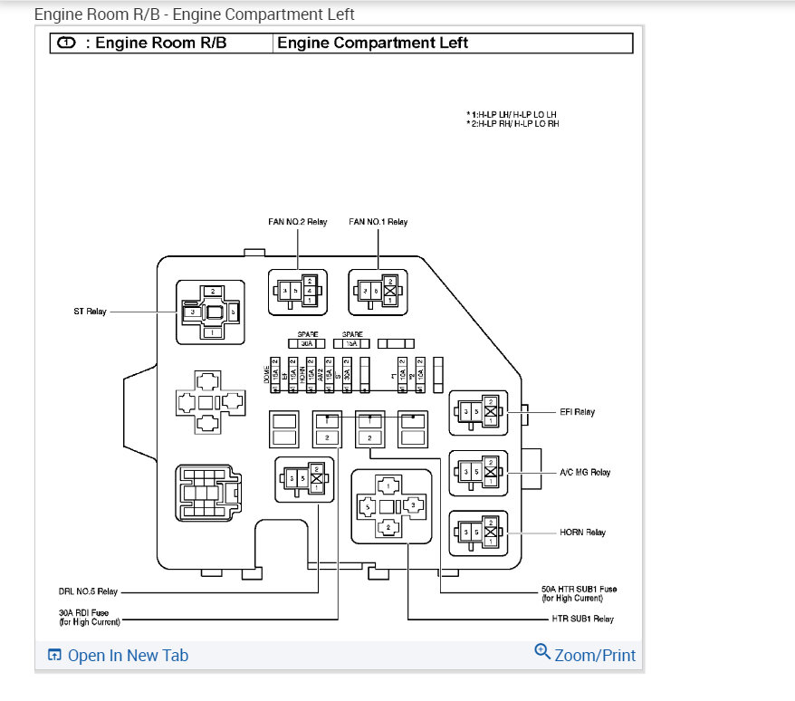

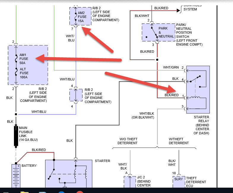

I put the key in the ignition and all lights and sounds are fine, but when I turn the key it makes no sound or attempt to start.

check items in picture then check battery for condition including load test most places do for free. Here is the location of the starter relay (ST relay)

Cannot see the picture its way too small.
Sep 12, 2016 at 2:52 AM
HMAC300
  • 48,601 POSTS
am one and two fuses and starter relay behind dash. did you click on picture to make it larger?
Sep 12, 2016 at 4:58 AM
GEIVERA22
Yes I did. I got it fixed. It was a wire problem. Thank you
