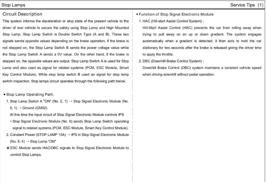

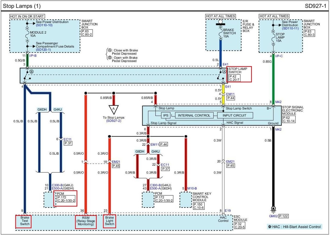

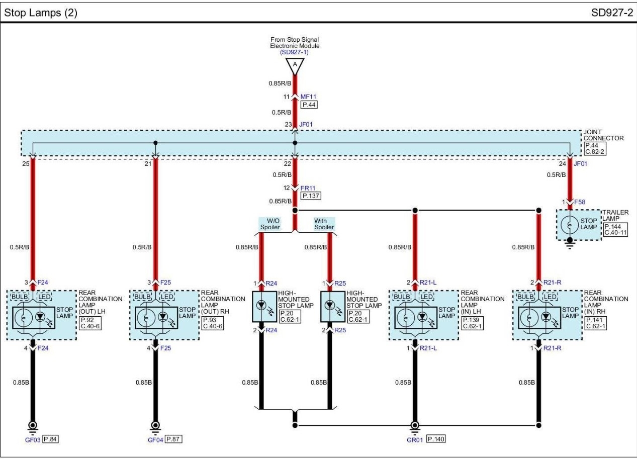

I will pull up a wiring diagram to see how the vehicle is set up, heres some guides to help with fuse testing.
Sep 23, 2025 at 2:31 AM
AL514
  • 5,668 POSTS

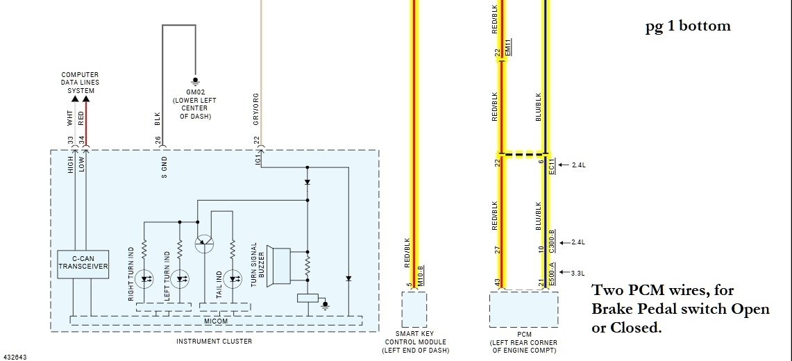

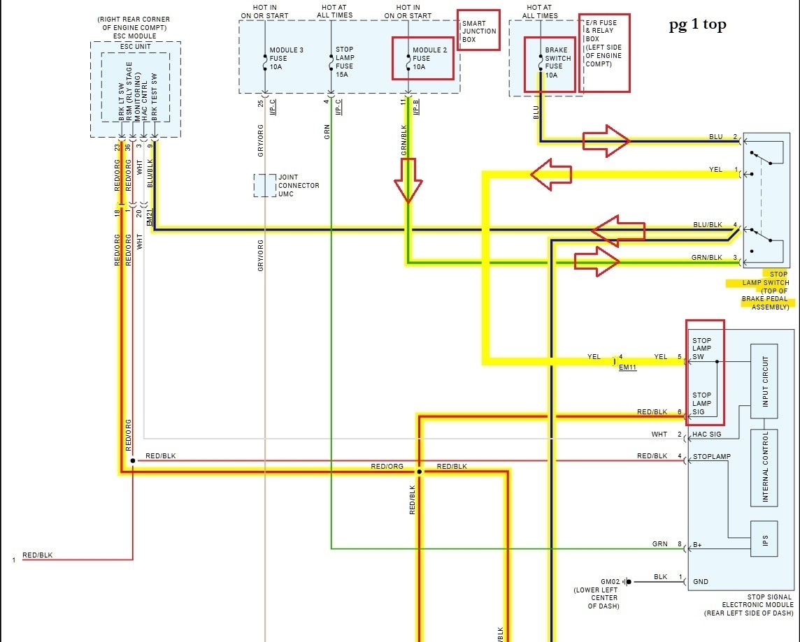

Here are all the Brake pedal switch circuits, diagrams 1,2 (pg1 top & bottom)
Diagrams 3-5 are the oem Brake Pedal circuit wiring diagrams.
