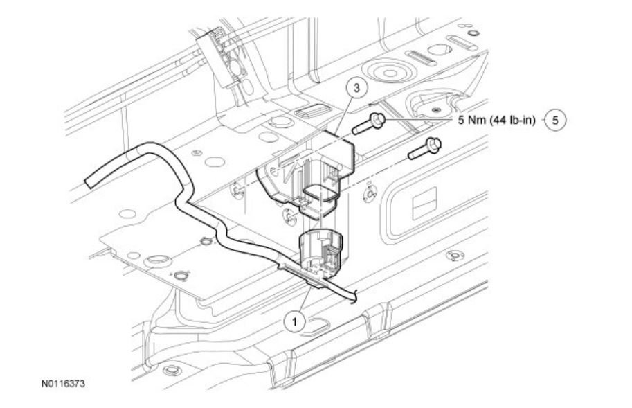

Please can you tell me or show me what will cause a car not to start when you had accident with it? I don't know what can be the problem. the accident happened at the back of the car.
Jun 22, 2019 at 7:08 PM
Good morning,
There is an inertia switch that is set to open in the event of a roll over or an accident to stop fuel flow.
Your car does not list a switch so it is part of the fuel pump control module. It gets an event signal from the Airbag system and turns off the fuel pump.
Removal and Installation
1. With the vehicle in NEUTRAL, position it on a hoist. For additional information, refer to Vehicle Jacking and Lifting See: Vehicle Lifting > Procedures > Jacking and Lifting.
2. Disconnect the Fuel Pump Control Module (FPCM) electrical connector.
3. NOTICE: Do not overtighten the fasteners or damage to the module may occur.
Remove the 2FPCM (Fuel Pump Control Module) bolts.
- To install, tighten to 5 Nm (44 lb-in).
4. To install, reverse the removal procedure.

9. For vehicles with an inertia fuel shutoff (IFS) switch, the IFS switch de-energizes the fuel delivery secondary circuit in the event of a collision. The IFS switch is a safety device that should only be reset after a thorough inspection of the vehicle following a collision. For vehicles without an IFS switch, the fuel pump control module receives an event notification signal from the restraints control module (RCM) to disable the fuel pump in the event of a collision. The signal is sent on a dedicated circuit between the fuel pump control module and RCM.

The fuel pump control module will not need to be replaced, the restraints control module is what will inhibit fuel pump operation and will prevent the fuel pump driver module from turning on the pump. Retrieve codes from the RCM to verify that you have the “crash data full” code present, if so replace the RCM.
