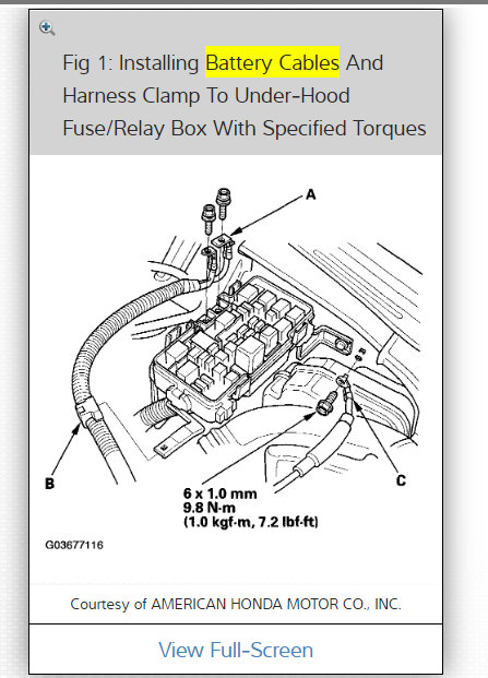

We can help you here. can I ask the brand of battery that was installed? It sounds like it is shorting out or you have a positive battery cable that needs to be replaced. Lets test the battery ourselves by following this guide:
We should run the codes as well.
Here are the instructions to replace the positive battery cable. Check out the diagrams (below). Please let us know what you find. We are interested to see what it is.
