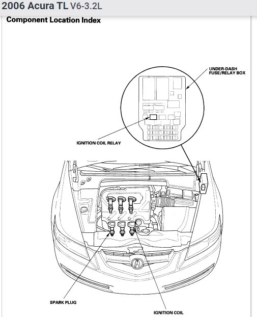

Hi, I recently changed my fuel pump and fuel pump relay car still wont start.

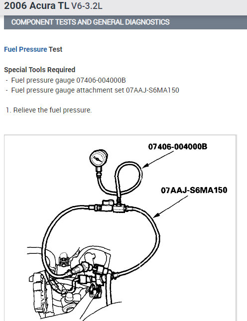

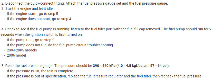

So just to clarify you had the no start issue before you change out the pump and relay?
Before you changed the pump, did you test to see if it was indeed the pump?
When you turn the key, can you hear the fuel pump come on?
https://www.2carpros.com/articles/how-a-fuel-pump-works
https://www.2carpros.com/articles/how-to-replace-an-electric-fuel-pump
If your car throwing any codes?
https://youtu.be/vMwTzURWXmk
You should have about 57 - 64 PSI of fuel pressure with a good pump.

No, the car cut cut off while I was driving and i got i towed home. changed the fuel pump and relay went to go crank it up then i heard a weird noise under the hood and it never started.

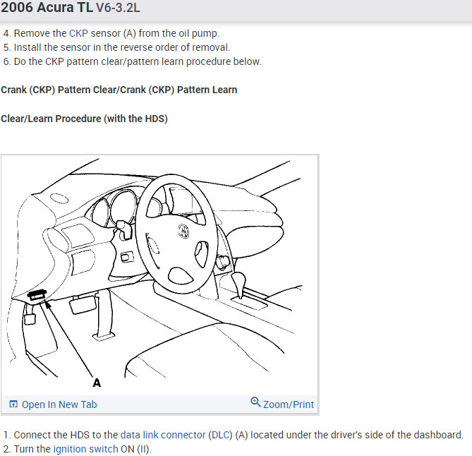

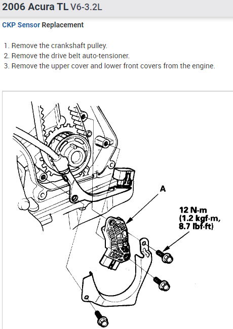

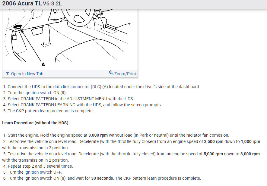

So it cranks but no start, right? Can you upload a video of the noise?
You could have a faulty crank position sensor.
Is there any codes? If so that might point us to the right direction.
Next item you should check is to see if you are getting spark. Could a issue with the ignition relay (I have attached the location of it).
Let me know if you have any questions./
