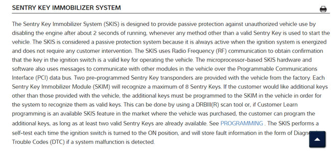

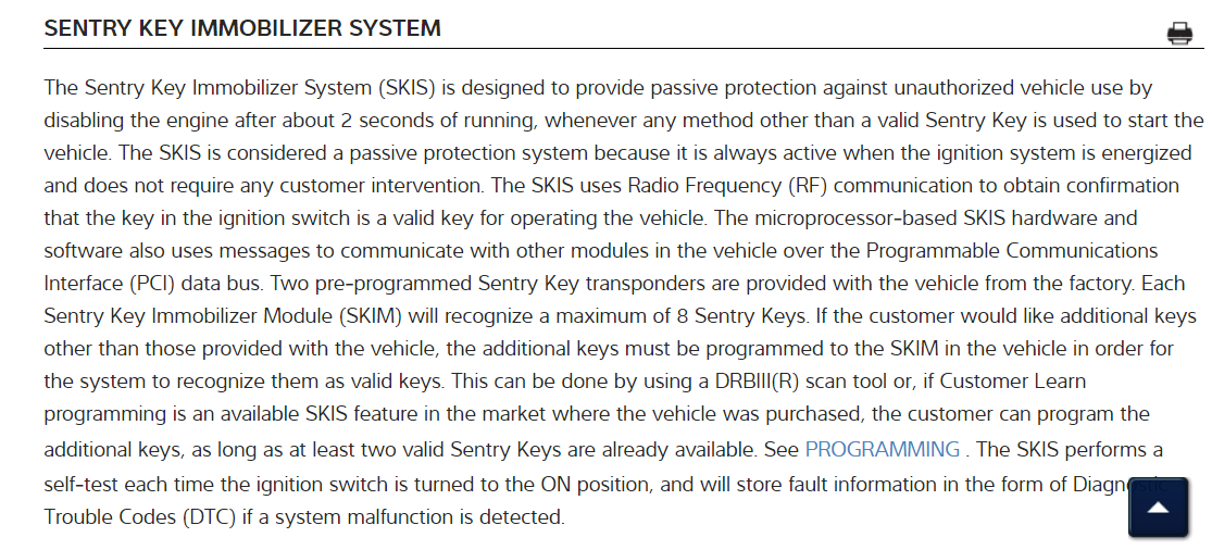

MANDAK924
Will not start, it turns over but will never catch. The key light stays on solid sometimes and sometimes not, we have reset the immobilizer, cleaned the PCM, tried darn near everything every site has said to try and it still will not! Please help!
Aug 31, 2020 at 5:45 AM (Merged)
SCGRANTURISMO
  • 4,897 POSTS
Is your Malfunction Indicator Lamp (MIL) or "check engine" lamp illuminated? Also in the diagrams down below I have included a description of how your vehicle's Sentry Key Immobilizer System (SKIS) works for your reference. Please get back to us with the Direct Trouble Code (DTC) if your MIL is illuminated and we can go from there.
