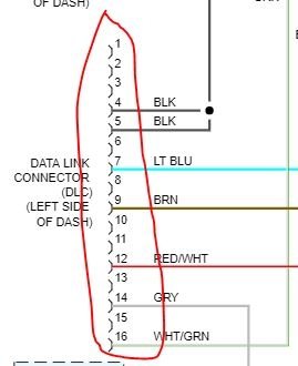

The ABS and TPS sensors are on in my car so my buddy tried to clear them with his ODB reader and apparently these two notifications have to be cleared by a mechanic. So my friend said that he could clear them with a paper clip, so I let him. Well now my car won't start and the ODB port isn't working either.

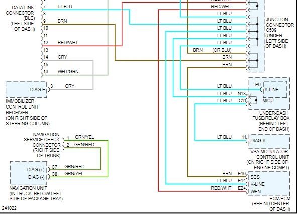

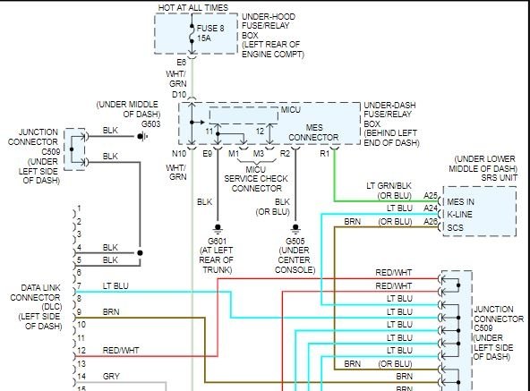

Check fuse number 8 in the under hood fuse box. Lets hope he jumped power to ground and blew a fuse. Next, I attached two pics showing the fuse and the connector pins. I need to know which were jumped. The last two pics are of the entire data link connector wiring. I had to break it into two pictures for it to be readable. I did, however, overlap them so you could follow it. When you turn the key to the on position without cranking the engine over can you hear the fuel pump run in the tank for 5 seconds?
Check out the diagrams (Below). Let us know what happens and please upload pictures or videos of the problem.

My friend said he stuck one side of the paper clip in and didn’t connect the other side. All I know is the ODB port isn’t working and the car act like it wants to start when I turn the key but won’t turn over.

I still have access to the car so in the morning I’ll go up and change out fuse 8 under the hood and let you know.

Hey man, it worked. I replaced the 8 fuse and it started right up. Now if I disconnect the black connection to my battery for an hour will it reset the computer and make the ABS and TSA notifications go away?

Thank God. He must have shorted the power pin to ground and nothing other.

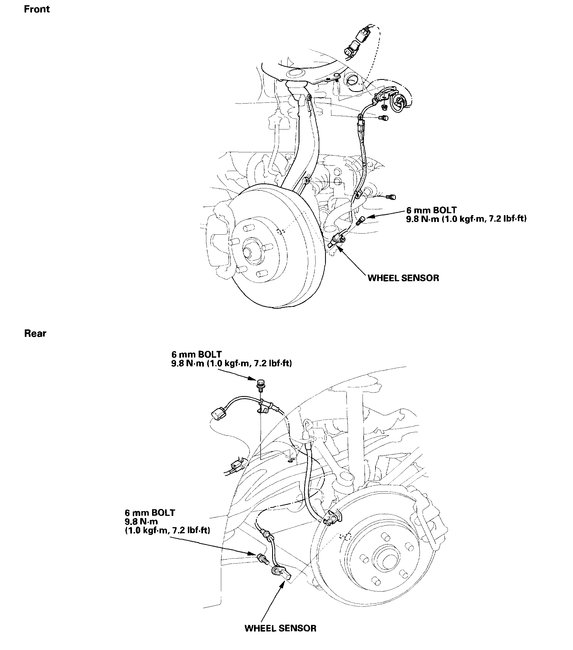

So it turns out to be the speed sensor and maybe the wheel bearing. If both it’s going to $464.00.
May 28, 2019 at 12:00 AM
  • 110,248 POSTS
Welcome back:
The wheel speed sensor will most certainly turn the ABS light on. On some vehicles, the sensor is part of the wheel bearing/ hub bearing, but that isn't the case on your vehicle. So, if the wheel bearing isn't making noise or showing a problem, just replace the sensor. If you look at the picture I attached, it shows how the sensor is replaced. It is a simple job. Also, here links showing how to test them as well as how to replace one:
