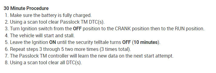

So my car starter up; it worked fine this morning. then I got home turned it off went to leave again and it didn't want to start. there is a an ABS light that comes on everytime I go to start the car and the security light blinks and there is a piece of the key the end piece of the key broke off in the ignition someone please help me

I want you to try something. Turn the key to the run position (engine off) and wait approximately 10 minutes to see if the theft light turns off. If it does, try the 30 minute relearn procedure in the pic below. Note: when the light stops flashing, see if the engine will start.
Let me know what you find.
