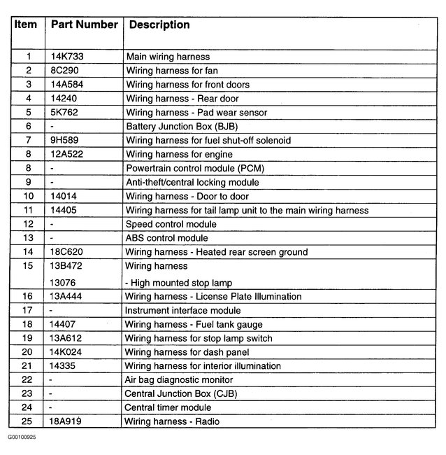

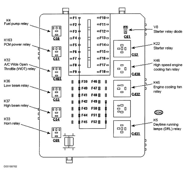

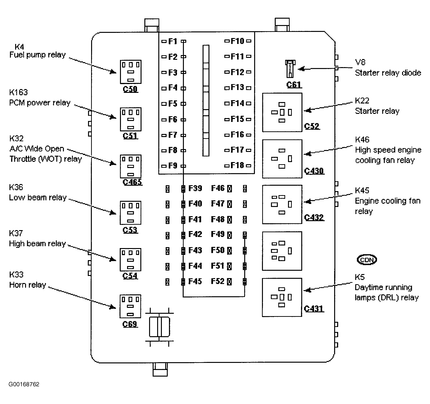

Can you get me the diagram for both internal and under the hood for the fuse boxes?

Battery junction box fuse and circuit identification
Fuse Number Amperage Circuit
F1 ..... Not Used
F2 7.5 Generator
F3 20 Fog Lamp Relay
F4 ..... Not Used
F5 ..... Not Used
F6 3 Powertrain Control Module, (Bi-Fuel Control Module, 2000 Only)
F7 20 Horn Relay/Multifunction Switch
F8 ..... Not Used
F9 15 Fuel Pump Relay
F10 ..... Not Used
F11 20 PCM Power Relay/Ignition Transformer
F12 ..... Not Used
F13 20 Heated Oxygen Sensors
F14 7.5 ABS Control Module
F15 7.5 Headlamp (Right)
F16 7.5 Headlamp (Left)
F17 7.5 Headlamp (Right), Instrument Cluster
F18 7.5 Headlamp (Left)
F39 ..... Not Used
F40 (1999) 20 Ignition Switch/Light Switch, Central Junction Box Fuse F26
F40 (2000) 20 Light Switch
F41 (1999) 20 PCM Power Relay
F41 (2000) 20 Ignition Switch, Fuse F26
F42 40 Central Junction Box Fuse F37
F43 ..... Not Used
F44 ..... Not Used
F45 60 Ignition Relay
F46, F47, F48 ..... Not Used
F49 60 Engine Cooling Fan Relays
F50 ..... Not Used
F51 60 ABS Control Module
F52 60 Rear Window Defogger Relay, Courtesy Lamp Relay, Central Timer Module, Central Junction Box Fuses

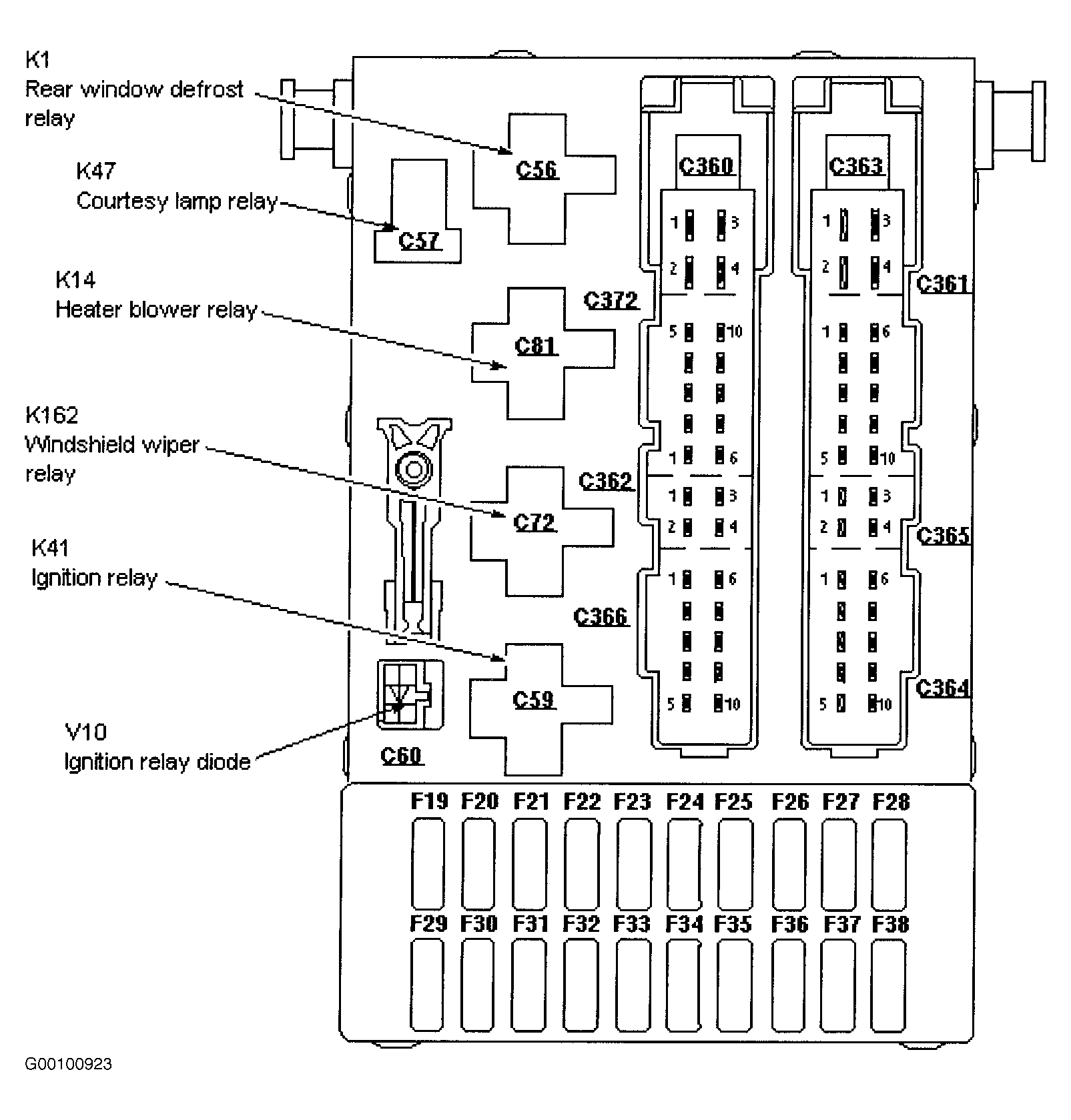

And can you get me the one under they dash please?

That was included in them, that is the central junction box. these two.

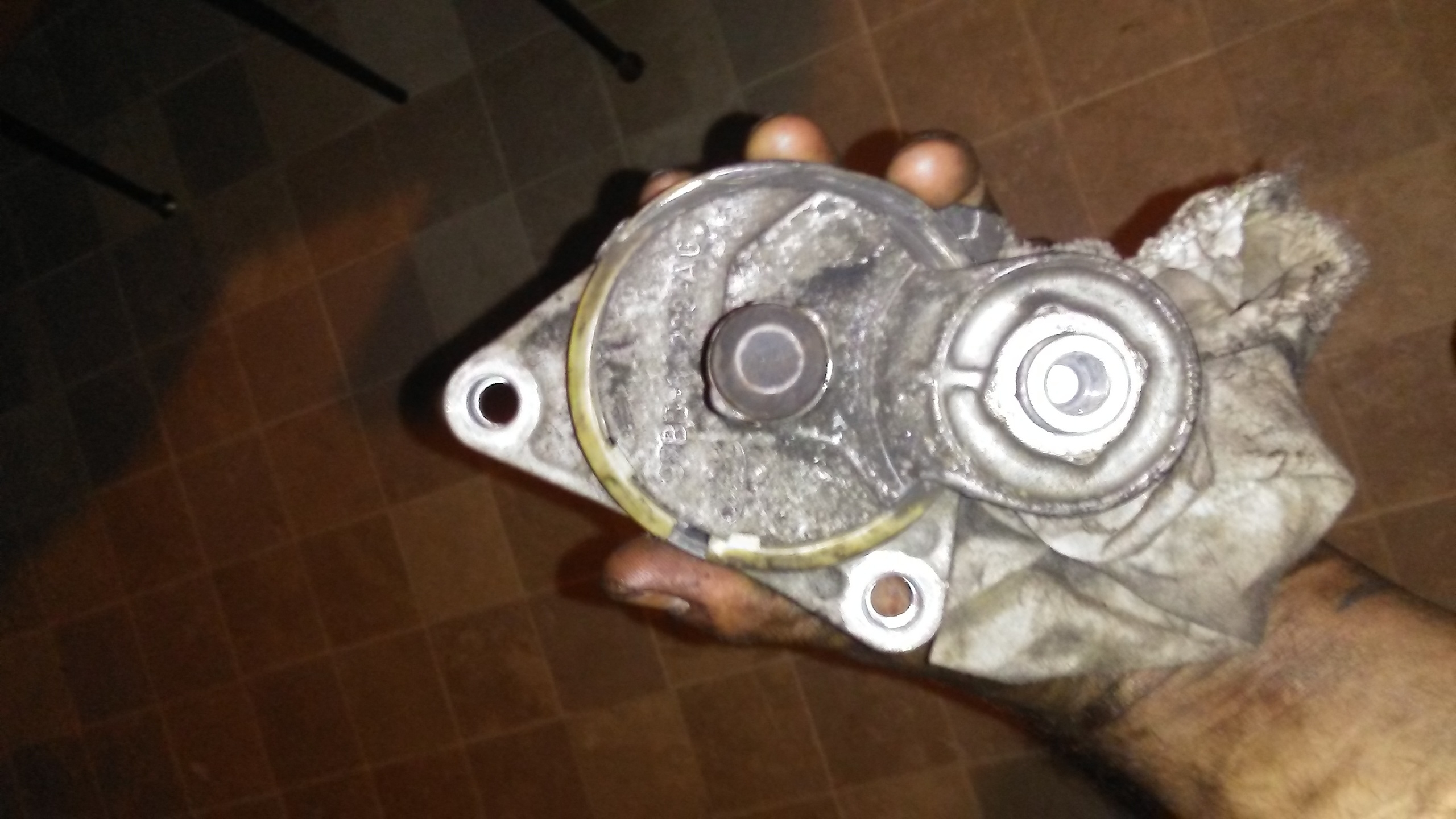

What part has the inprint 97BB-6A220-AG. Please and send a picture if you can.

No this is some kind of tensor.

I have no idea what that is. A search of that part number comes back with nothing at all.
Perhaps you should include the location of where you found it, what it looks like and any color wires going to it.
If you are just asking a general question as to what it is, where did you get this part number from?
A snap shot of it may also help identify what it is along with all the other information.

Here is the tensor and will kerosene hurt a motor? because I took the oil filter off and I am smelling gas or kerosene.

Are you saying that is a serpentine belt tension-er that you are holding in your hand?
