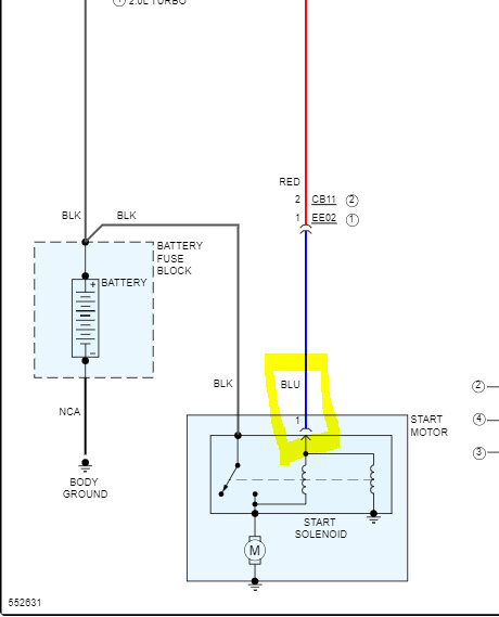

My car had been stalling to turn on last month but nothing serious, it would happen only sometimes. They took it to AutoZone they told me my battery was low, and at the time (a month ago) I didn't get it charged because I was working on the clock and had to leave, and it then eventually went back to normal. Now yesterday my car stopped turning on, my lights, radio, and alarm turns on but it won't start. I tried getting battery from another car twice and nothing. Took my battery to AutoZone and charged it for 2 hours. They told me the battery had a dead cell. I bought a new battery and hooked it up and my car is still completely dead. Any ideas?

If you have a new battery and the starter doesn't engage, we need to check if the starter is getting power. I assume the lighting and other electrical components are still working. If that is incorrect, let me know.
Here is what I need you to do: At the starter motor, you will see a heavy gauge black wire. That is direct from the battery and should have 12v at all times. Confirm that first.
If that is good, locate the smaller blue wire. It should not have power until the key is in the start position. So, have a helper turn the key to the start position while you check for power to that wire. If there is power, the starter is the likely cause. If there is no power, let me know and we will need to work backward to see where power is lost.

  • 110,194 POSTS
Yes, if you had a bad cell, the battery it's likely the battery wouldn't have had the power to engage the starter, but you may have heard a click or clicking.
As far as the starter is concerned, it is hidden under a few things. I attached a pic below of its location.
As far as the test is concerned, you can use a multimeter/voltmeter or even a test lamp to check for power.
