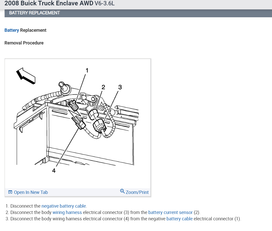

Every time I try to crank up my car it will make a sound but won't turn over. what do I need to do?
Nov 5, 2022 at 3:00 AM
SATURNTECH9
Experienced Mechanic
30,869 POSTS
What kind of sound are you hearing and where is the sound coming from? Is the engine turning over? Or is it a no crank no start?
Nov 5, 2022 at 3:58 AM
55,694 POSTS

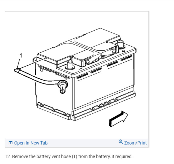

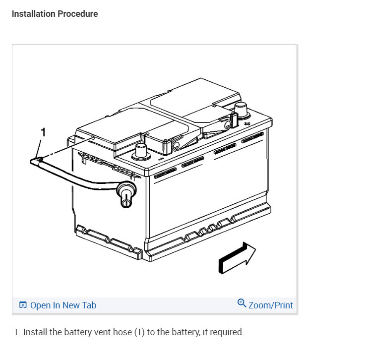

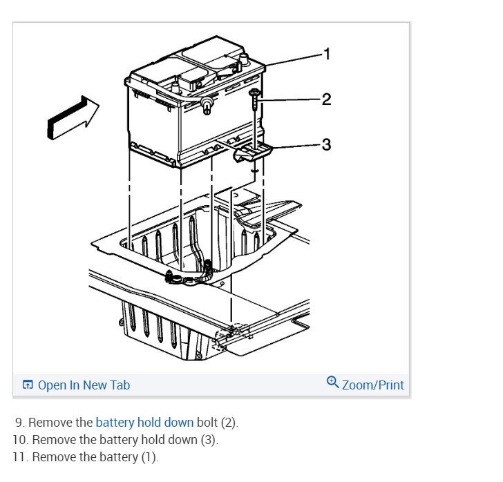

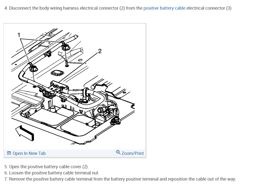

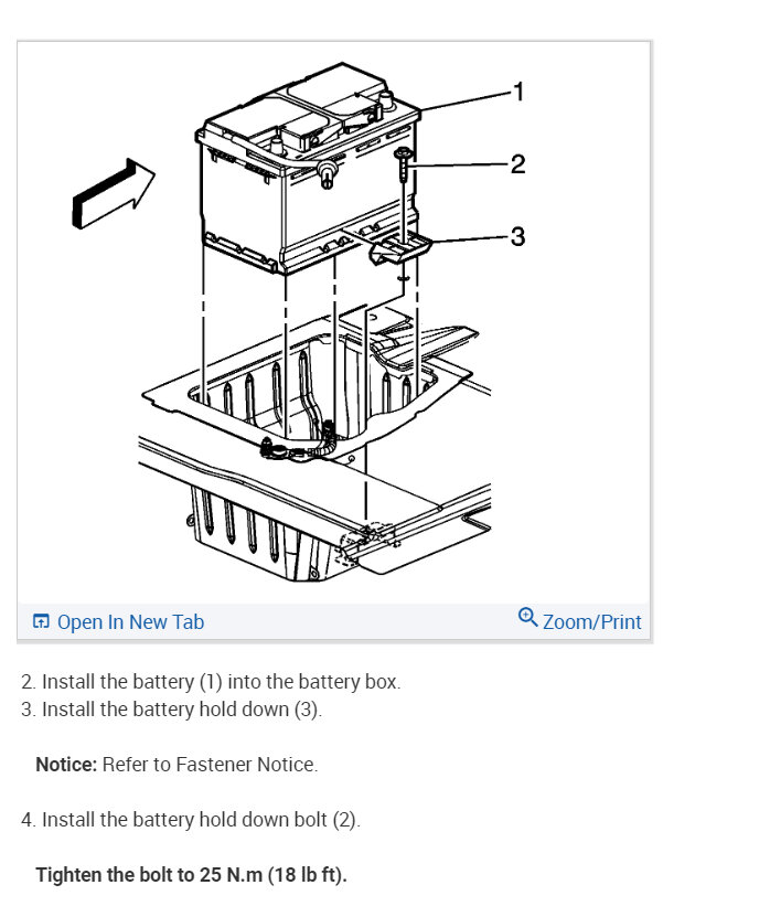

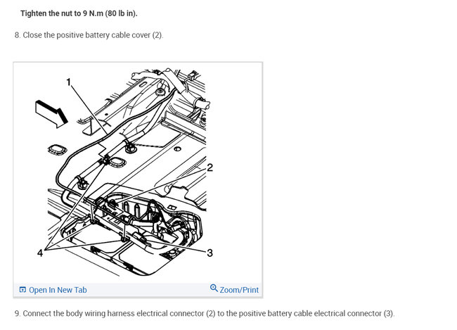

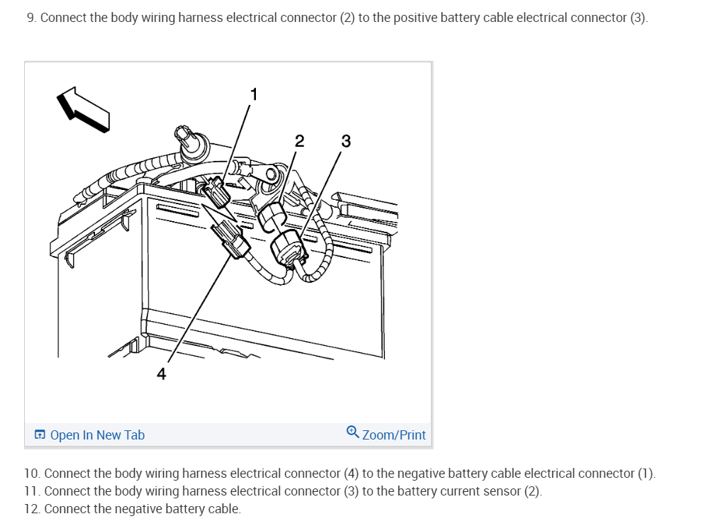

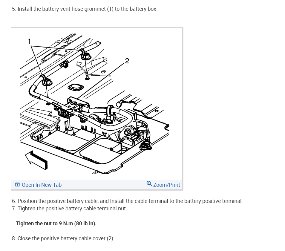

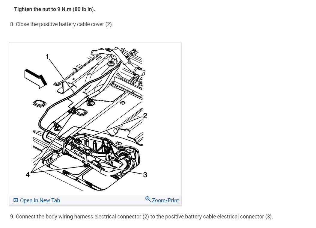

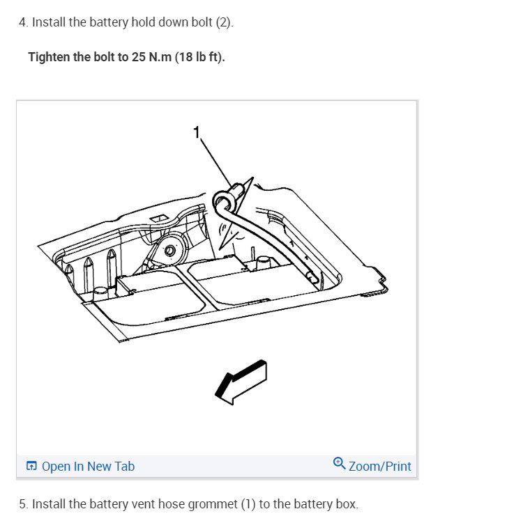

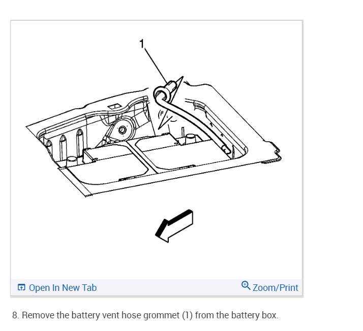

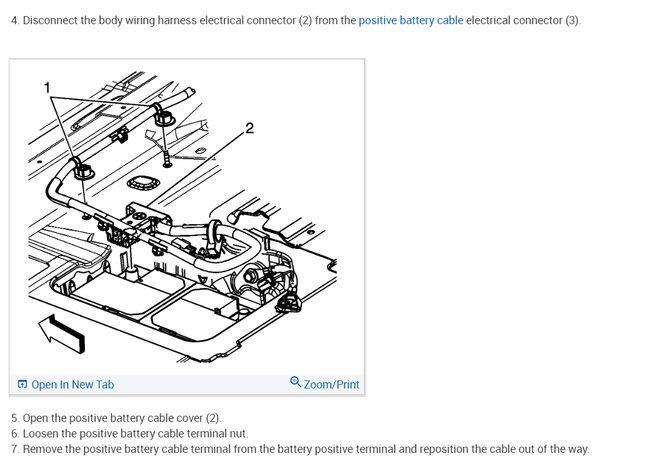

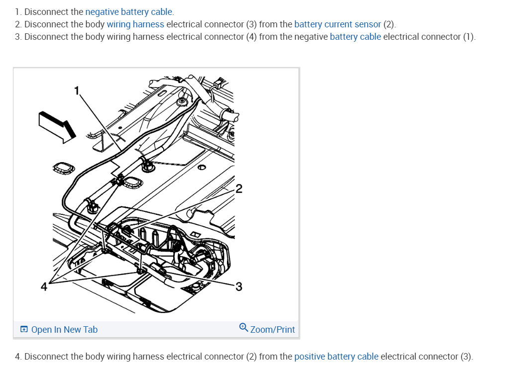

It sounds like the battery is weak, this guide can help confirm the problem:
If so, this generic guide will show how to change the battery and instructions in the images below to show you on your car:
https://www.2carpros.com/articles/how-to-replace-a-car-battery
Check out the images (below). Please let us know what you find. We are interested to see what it is.
Images (Click to enlarge)
