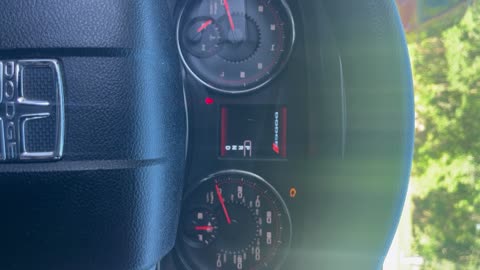

When I push the start button the car tries to start but won’t turn over all the way.

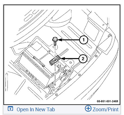

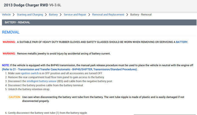

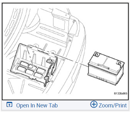

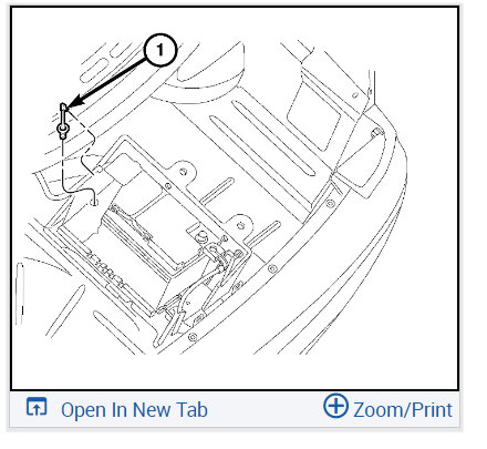

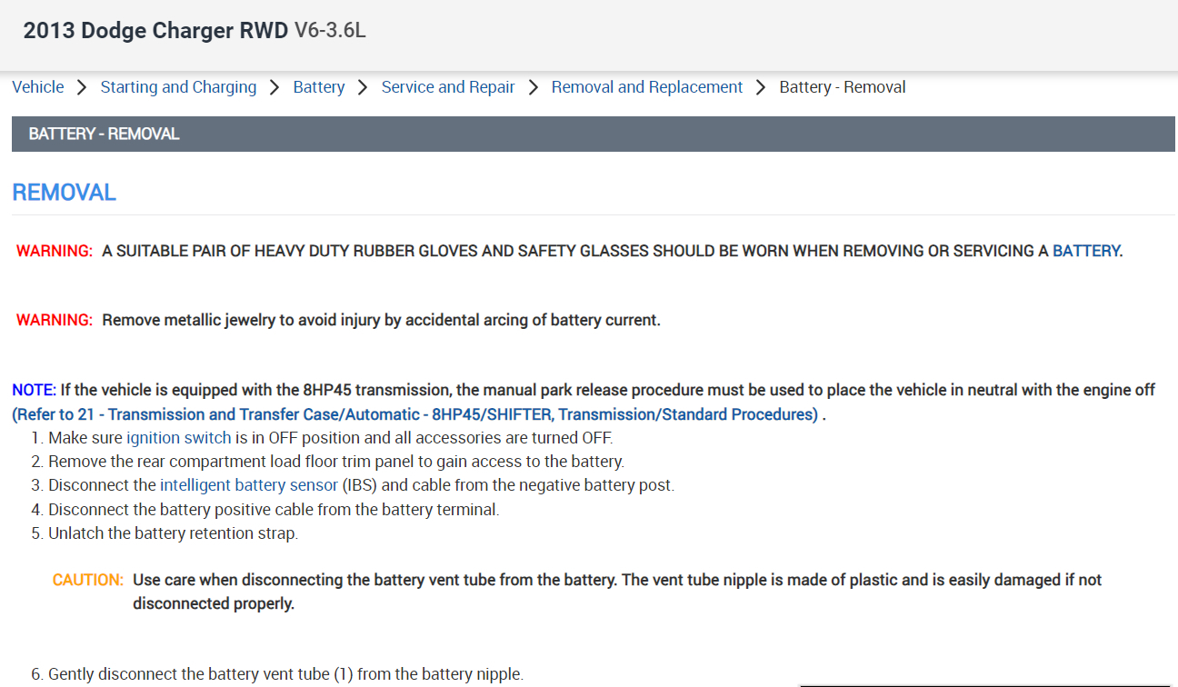

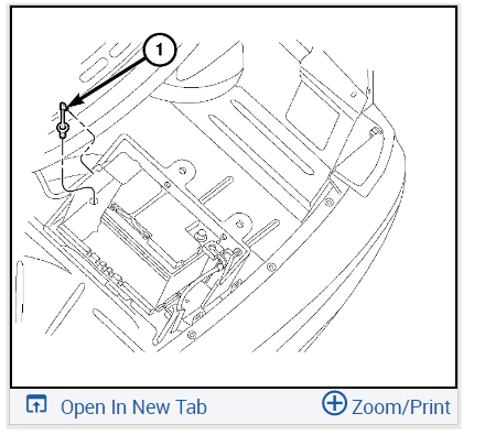

It sounds like you need a new battery, so the engine cranks over and then stops? Do you hear a ratcheting sound? We need more information to help you. Please upload a video in your response of any problems so we can see.
Here is how to remove the battery so you can have it tested:
This guide can help out as well:
https://www.2carpros.com/articles/how-to-replace-a-car-battery
Also, this video is for an engine that does not crank over:
https://youtu.be/6YRW8fyNudY?si=81kqTqh_MlfNyW02

Thank for the video, it helps. Please go over these guides and get back to us.

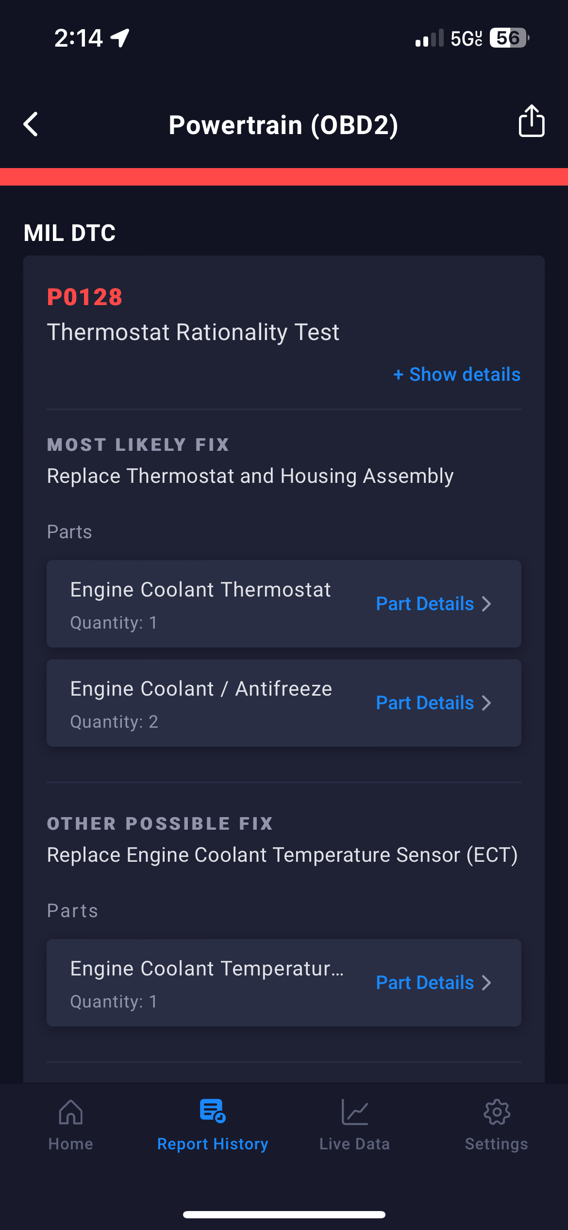

Okay, let's run the codes and check the compression, this guide will help you get the codes:
Please go over this guide and get back to us.
Sep 8, 2024 at 4:11 AM

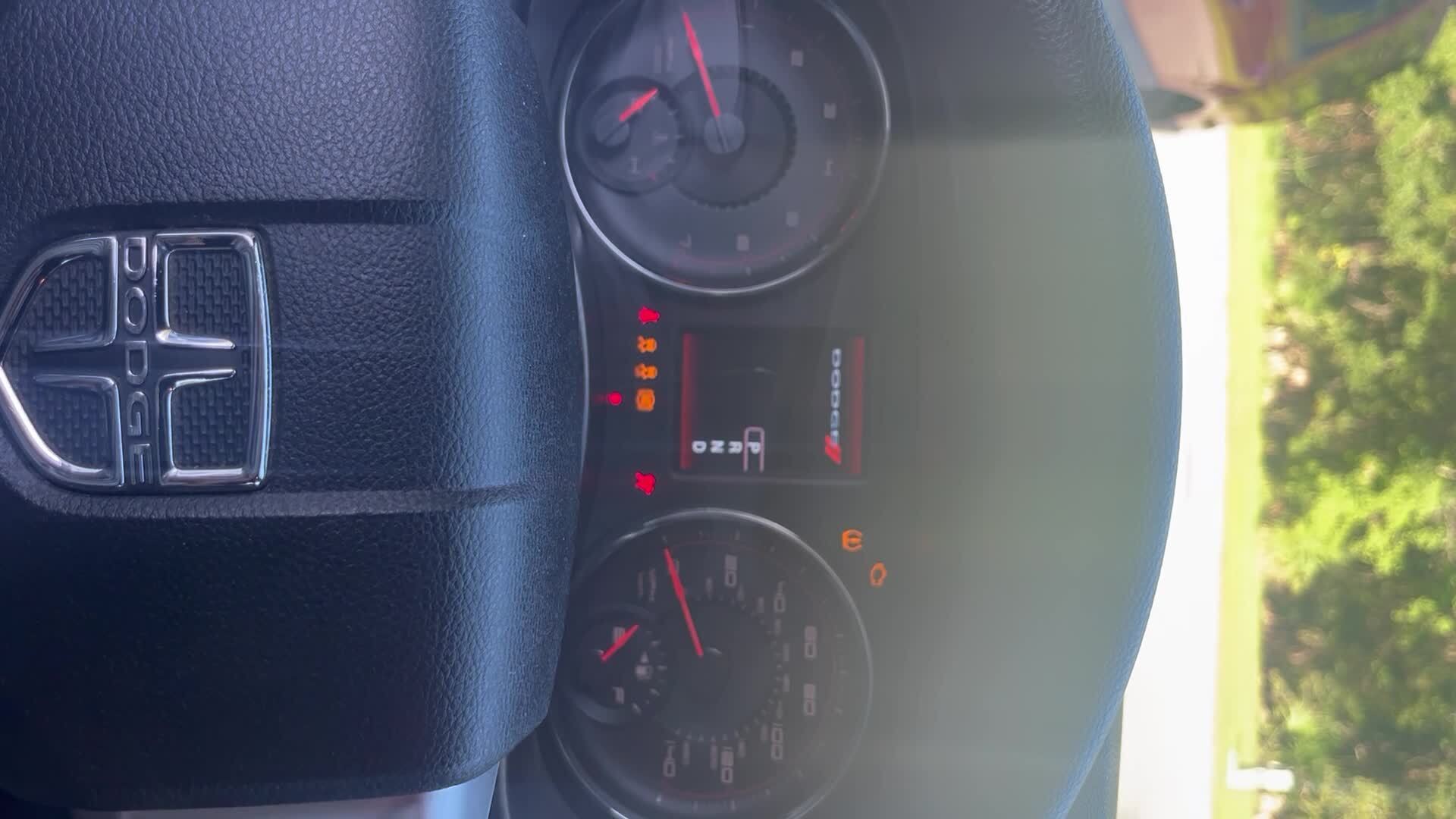

DSHERI1
  • 6 POSTS
I’ve posted a picture of the codes.
Sep 9, 2024 at 4:13 AM
  • 55,423 POSTS
Okay, these cods are telling us the engine has over heated and that the thermostat needs to be replaced but this will not keep the engine from starting cold. I would head out to the auto parts store and rent a compression gauge for cheap or free and do the test.
