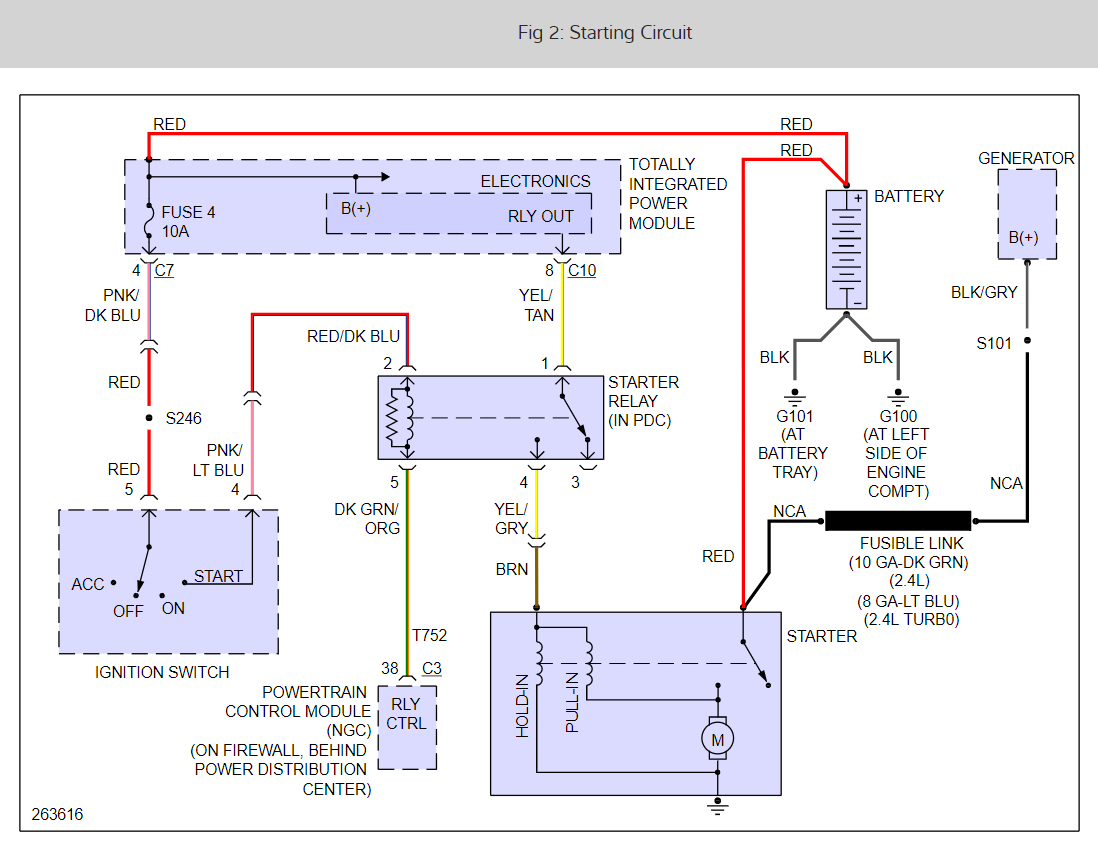

Changed my gear shifter and the cable now my car will not start. can you help?
Dec 2, 2017 at 3:33 PM
JIS001
  • 3,412 POSTS
You need to verify the adjustment is correct? If you put it in park, indicator needs to be in park, and if you put it in drive, indicator must show drive as well.
Dec 2, 2017 at 6:05 PM
DEBBIE MILLER
It try to start don't.know what else to do
Dec 4, 2017 at 4:11 AM
  • 55,746 POSTS
It sounds like you may have knocked the gear selector position switch connector off. Can you please double check it. Also here is a wiring diagrams showing the circuit. Here are some guides that will help you as well
